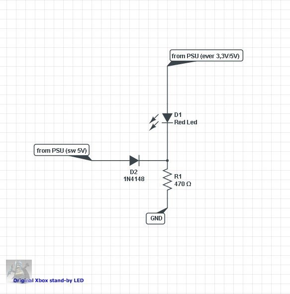

I plan to light up a clear jewel when the xbox is in stand by with one or two led's.
I searched the web, found a pic (some weeks ago and forgot where i found it) which say nothing to me. So maybe some could help me out here with a simple drawing or a picture for non electricians?

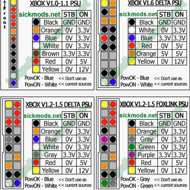

On a version 1.6 all the orange wires at the 20 pin power plug a 5 volt all the time.
I am not sure what you are ting to use the from PSU via D2 for

I think nothing because it's not my schematic. I found that but can't remeber where. Otherwise is would search in that topic for a more non electrician explanation how to wire that up. But because i can't remember from where i found that schematic and a google search dosn't delivered anything about standby LED on classic xboxes, i decidet to open a topic because it's maybe interesting for others too.

Forget about any scematic and built it on your own. Its VERY simple. Just take a + from a wire of the PSU that ALWAYS gives power(wich one depends on the PSU)connect it to a resistor for the LED,after the resistor go to one NC connection of a relay,then the other end of the NC relay goes to the anode of the LED and finally the cathode of the LED to ground. After that Connect the coil pins of the relay to the PSU but on wires that give power when the xbox is ON. That way,when you open up the xbox,the relay will power ON and open the circuit for the LED,switching it off. When you power off the xbox,the relay will power off and close the circuit,giving power to the LED

It's a nice idea but i will light up a cleared jewel with one or maybe two red LED's (depends on how it looks) when the xbox is off. But if you have some more infomations about that i may would use that on my crstal xbox. :)

Like Dave already worte on the 1.6, which i use here, all of the yellow wires are always 5v. Which seams to make things easyer. I have use conrad (german electric store) for research about a relay and, if i guess right, this one would do the job. It's a "Please login or register to see this link. " (There is also a version with pcb : https://www.conrad.de/de/p/tru-components-relaisplatine-bestueckt-1-st-rel-pcb4-1-1-wechsler-5-v-dc-1570052.html which maybe is a little overkill). SO i will get one of these and try my luck. :)

A relay get with the times it's 2020 not 1920 I would you a PNP transistor over a relay.
Something like this should do the job and for 2 LEDS a BC327 is rated at 800ma or a BD138 is rated to 1000ma(1 amp)
Link the base to the 5 volt switched on the HDD connector via a 1k resistor

In the diagram I posted substitute the Load for a LED and current limit resistor and if there is no power on the base then the LED is on and when put power to the Base the LED is off.
I don't think it's complicated and in the simplest form it could be 2 parts plus you LED and current limit resistor
