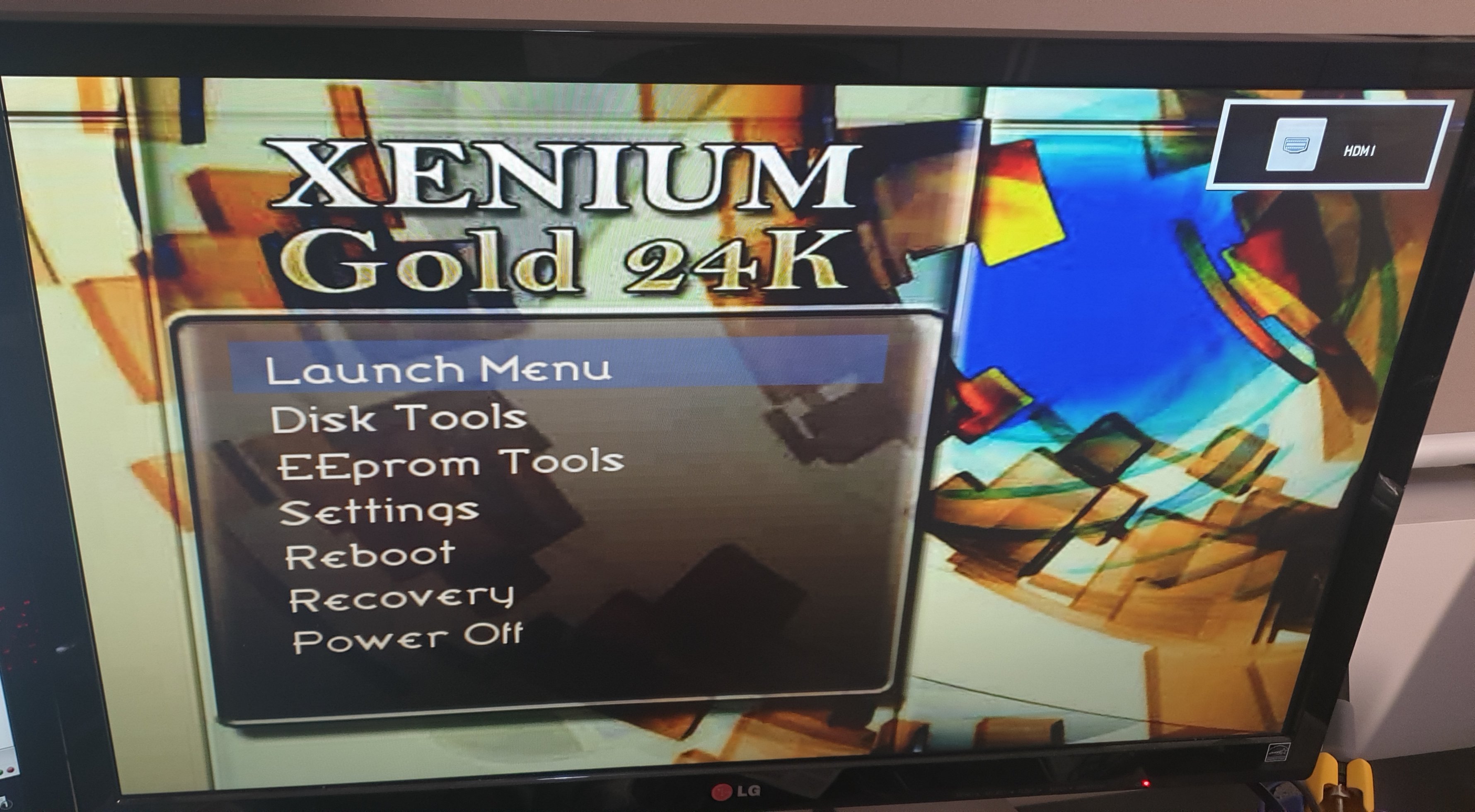

If you get a dump of XeniumGold OS you write the Xenium Gold firmware to your OpenXeniums.
This was never released by Xodus separately (i believe)
