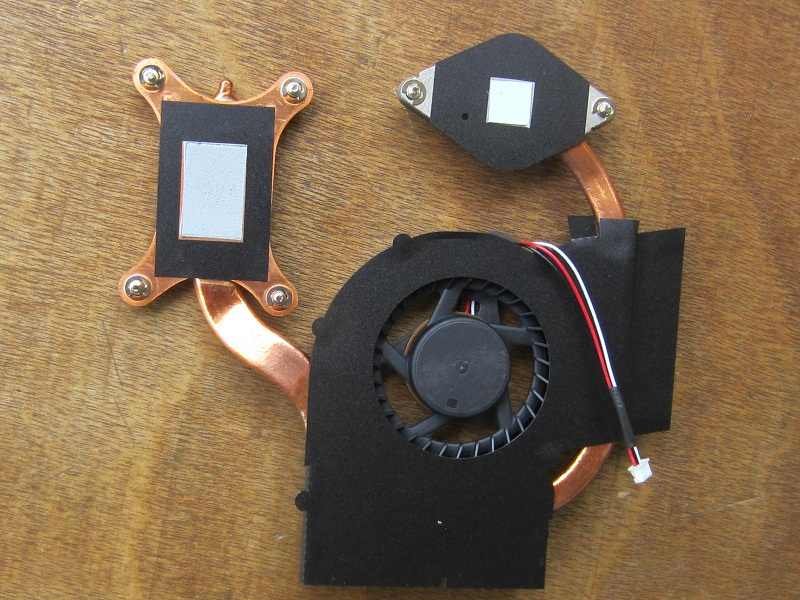

Have you looked in on using the cooler from an laptop ?
Dual heatsink, dual pipes and single fan, they do manage to take care of an quad cpu and a gpu and pack a lot more punch than one would think and you can easily get them of ebay or aliexpress like this one...

Hi!
Hmm... This seems like a good way to go in my opinion.
Do you know of any combo that fits the xbox without the need for big modifications?

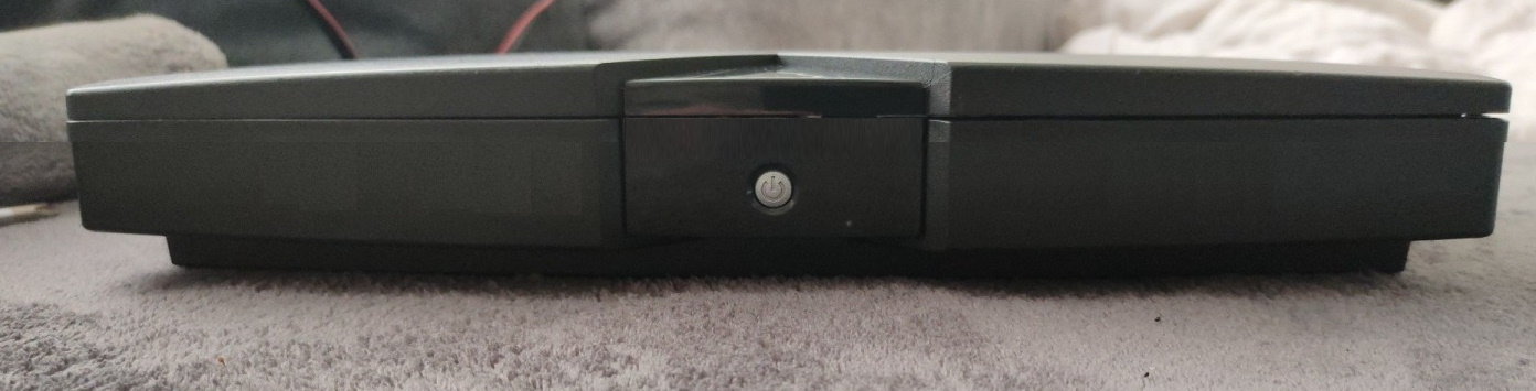

That's why i wrote " Difine "really cut down case " So we're talking about those more or less, mostly ugly looking (just speaking for me) ultra slim version like the on in pic i attached.
So yes, than you're right. HE1 server cooler would be an option or (yes) the VGA cooler.  I get 9 XBoxes in the next 1 or 2 days (bulk buy for realy cheap). Maybe be i will do one of these ultra slim just for the lol's.

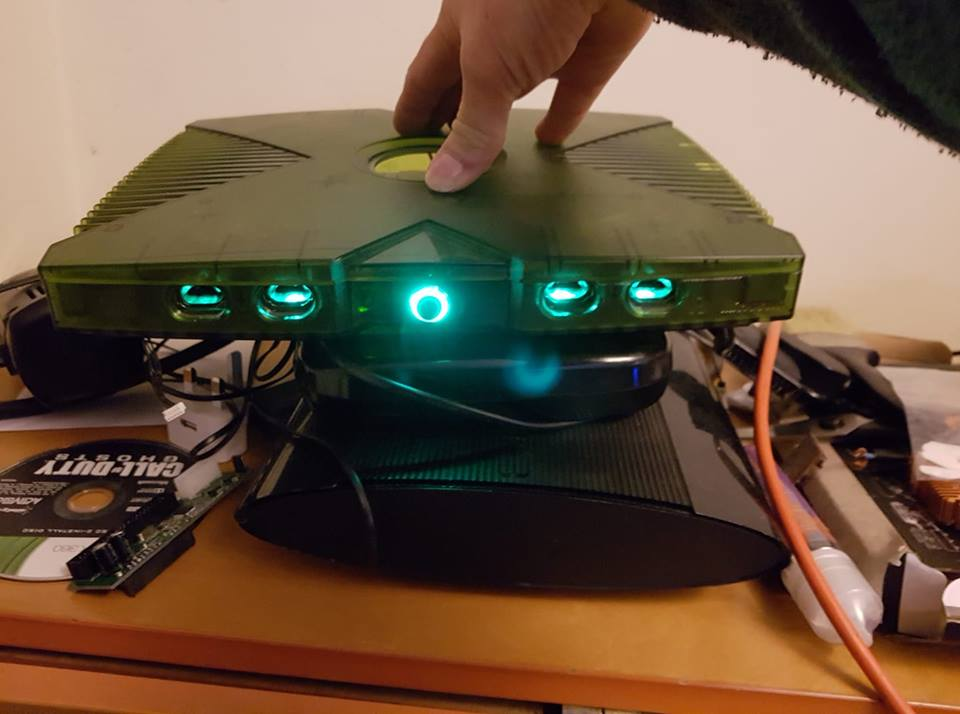

it looks like those xbox 370 concept spoofs. :D Nice.
I dont like those super slimes to much. Look at the top of the joy ports. It would look way better to make it at least 0,5 cm higher (Same height like you have under the ports if you know what i mean). But thats just my opinion and depends on the personal taste i guess. Sad is, that this is was a nice limited edition.
I like the slimness, but agree it looks to be a little to much as the top of the ports is slightly covered. This is a good size if you just remove the ports and fit an internal 360 controller mod. But  that looks a trans green case, I wouldn't do it to one of those. Not sure how common the6 are in the US but over in Blighty they were not sold in great numbers.

Back to the slim. If you would make it with a black one and remove the ports completely i think that could look nice (with a nicer power button). A horrible pic attached. :D

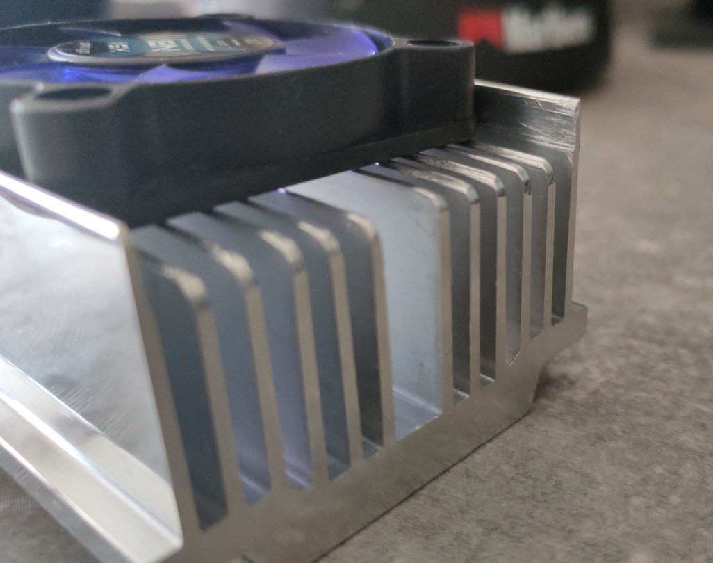

      I wanted to switch out the stock fan for a Noctua and still retain some of the OG look and feel, this is the result. Maybe it will be of use to someone else as well.
      The design is up on Thingiverse and PrusaPrinters, whichever you fancy. Print instructions are there as well. Enjoy.
      PS. I'm also working on a design that's more compact and easier to print (in two or three parts), I'll post it if I ever get around to completing it. 😄
