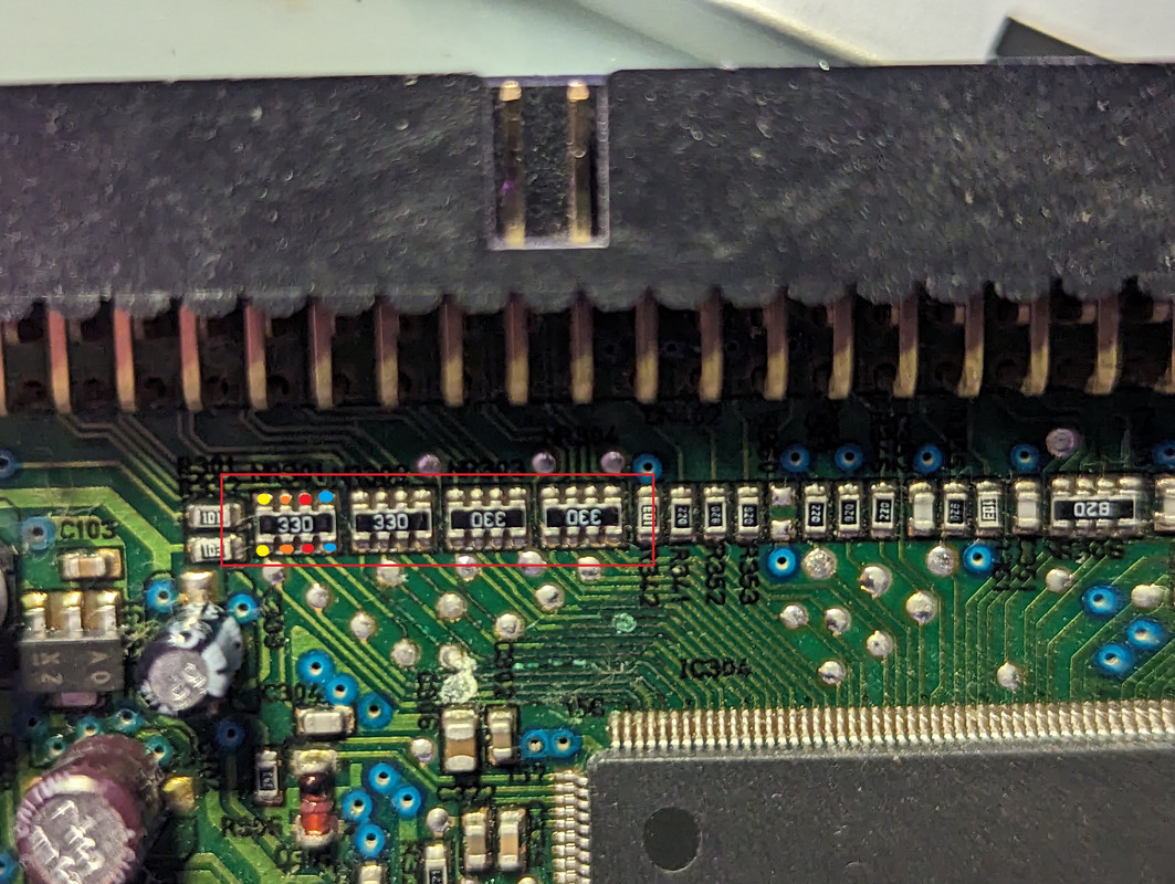

SS_Dave Posted November 25, 2023 Report Share Posted November 25, 2023 Check the 4 resistor banks next to the IDE connector You should get around 330 ohm on each resistor Test the 2 yellow dots then the 2 orange dots and so on for all 16 resistors, If you get a reading above 350 ohm then that resistor is faulty and you can tack a 330 ohm resistor across the faulty one. You should also consider recapping the board as well. Cheers SS Dave Soft modding is like masturbating, It gets the job done but it's nothing like the real thing. 1 Quote Link to comment Share on other sites More sharing options...

Raidernick Posted November 25, 2023 Author Report Share Posted November 25, 2023 27 minutes ago, SS_Dave said: Check the 4 resistor banks next to the IDE connector You should get around 330 ohm on each resistor Test the 2 yellow dots then the 2 orange dots and so on for all 16 resistors, If you get a reading above 350 ohm then that resistor is faulty and you can tack a 330 ohm resistor across the faulty one. You should also consider recapping the board as well. Cheers SS Dave Soft modding is like masturbating, It gets the job done but it's nothing like the real thing. As I mentioned in the OP all Samsung drive boards have been recapped. I did check these resistors on all boards as I know they are known to fail on samsung drives. Only one drive out of 12 was out of spec and I replaced those resistor packages with new ones. This did fix the issue of the drive not working at all but did not fix the issue I am describing above. Quote Link to comment Share on other sites More sharing options...
