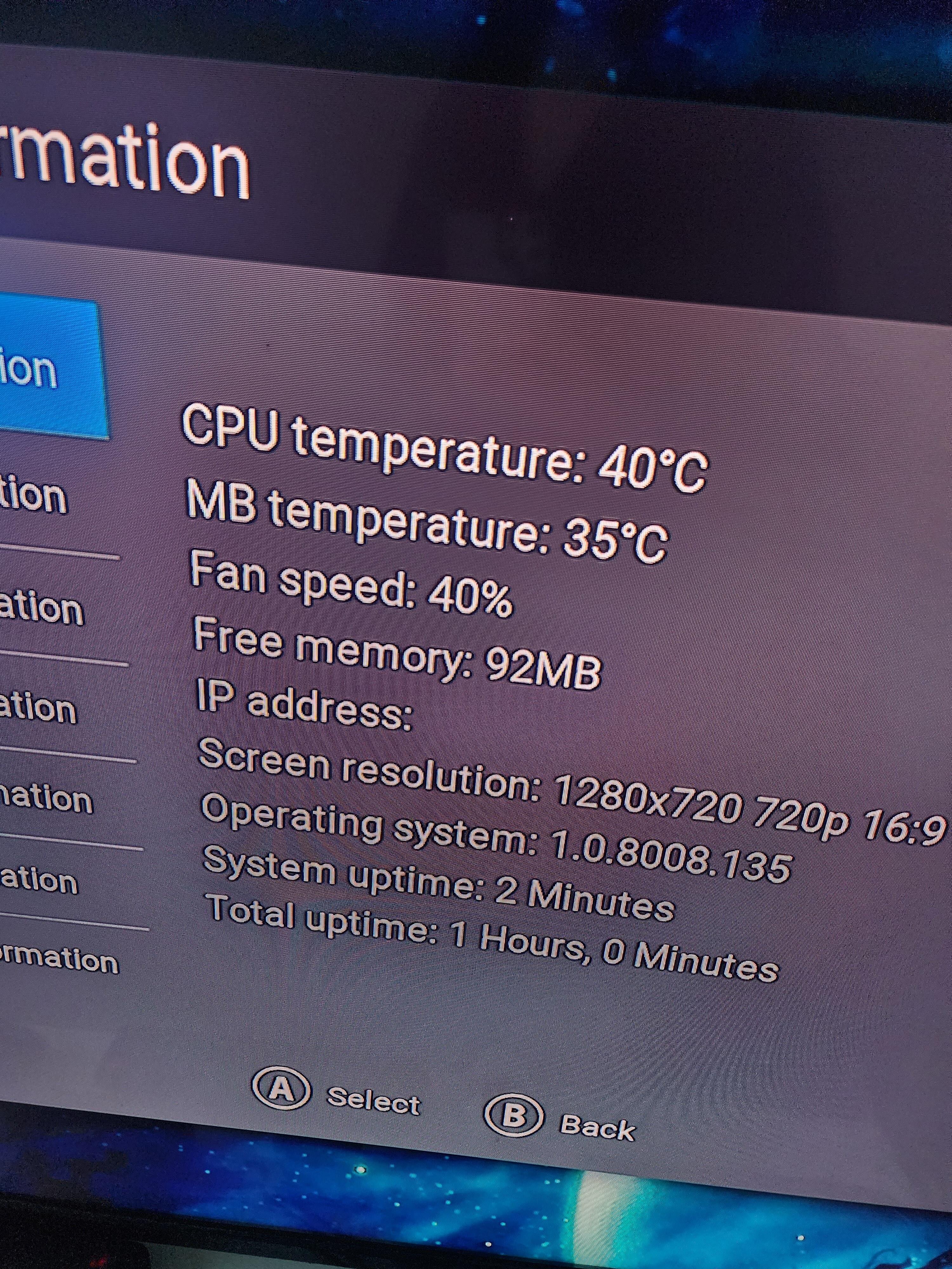

cdman Posted November 15, 2023 Author Report Share Posted November 15, 2023 I didnt think it could be that with replacing the thermal paste etc, but i will have a look at the temps soon when i get back and post them m8 thanks Edit, image of temps immediately after crash and turned console back on Quote Link to comment Share on other sites More sharing options...
ChriZz Posted November 15, 2023 Report Share Posted November 15, 2023 10 minutes ago, cdman said: I didnt think it could be that with replacing the thermal paste etc, but i will have a look at the temps soon when i get back and post them m8 thanks Edit, image of temps immediately after crash and turned console back on Temperatures are perfect. Hmm, you've already changed the HDD, right? But what about the IDE cable? Quote Link to comment Share on other sites More sharing options...
