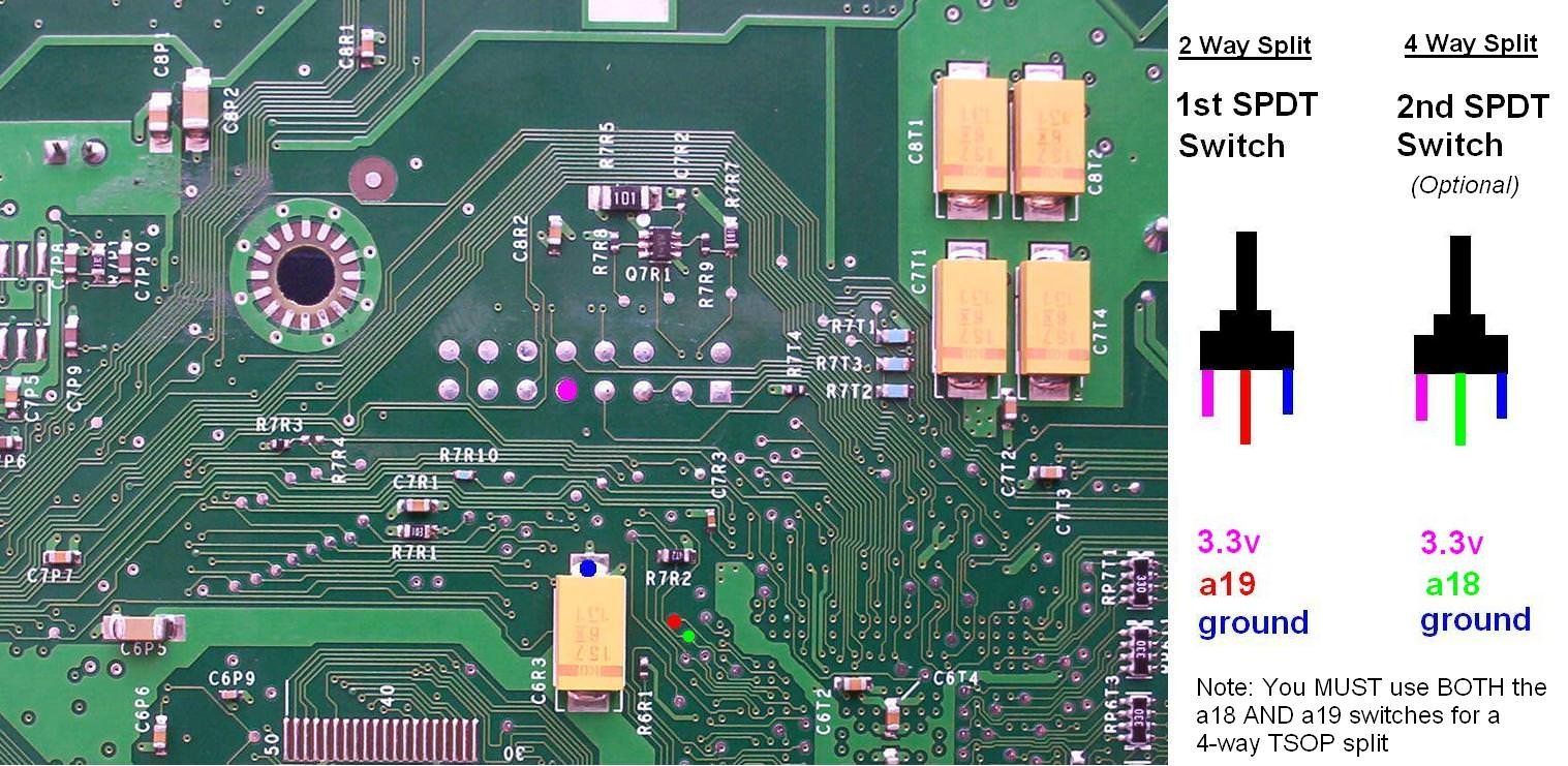

You could try the 3 wire trick as the 1.0-1.1 is a 1024kb bios that would have been split it to 4 banks and one of the banks may still have a working bios file.
Other wise replace the bios chip with one from a parts 1.0-1.1
I tried your 3 wire method using aligator clip and grounding pin 1 and 2 on the tsop and the  xbox booted, thank you sir.
only issue now is no video is being displayed so somthing is not right with the bios... any thoughts on how to get around this? Any way to re flash remotely through network without having a visual on screen?
