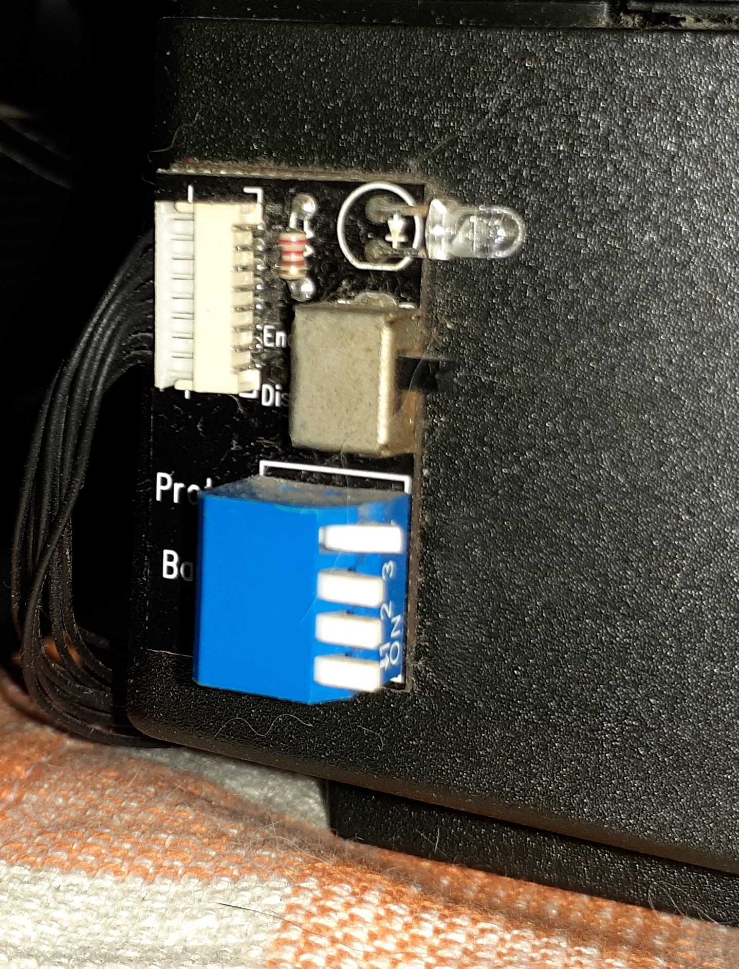

MaineBear Posted January 20, 2021 Report Share Posted January 20, 2021 A friend gave this modded Xbox but didn't know much about it. I've had soft modded ones. but don't know much about the hard ones myself either. It has a larger hard drive. When you turn it on it gives the 09 error and ring flashes red and yellow. Someone told me that button should be held on the controller when you turn on the Xbox but isn't sure which ones. Would that cause the 09 error? Thanks for any help. Quote Link to comment Share on other sites More sharing options...
sweetdarkdestiny Posted January 20, 2021 Report Share Posted January 20, 2021 Error Code 09 Problem: Hard drive parameters are missing or incorrect. Cause/Solution: Very uncommon error. The hard drive might be in the wrong transfer mode (PIO/DMA), or set to slave instead of master. Open the xbox and check the cables and the jumper settings. If on hand, check what happens with a different HDD. Quote Link to comment Share on other sites More sharing options...
SS_Dave Posted January 21, 2021 Report Share Posted January 21, 2021 What happens if you set the switch to disable and try and boot? Cheers SS Dave Soft modding is like masturbating, It gets the job done but it's nothing like the real thing. Quote Link to comment Share on other sites More sharing options...
