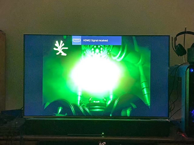

I recently purchased a Xbox of Facebook market place that has a DuoX2 (blue) mod chip installed. When the console boots is has like a green logo in the top left and Slayers 2.7 underneath the Xbox logo at the bottom of the screen (I’ll add a photo to explain what I’m talking about). Then it boots into evolutionX dashboard I believe.

That chip has EvoxM8 on it s well, flick the switch then power it on.
Yes you can flash a new bios to it and if something goes wrong you can still boot of the 2nd bios.
To flash the other bank have the flash program to the last stage then flick the switch and flash away.

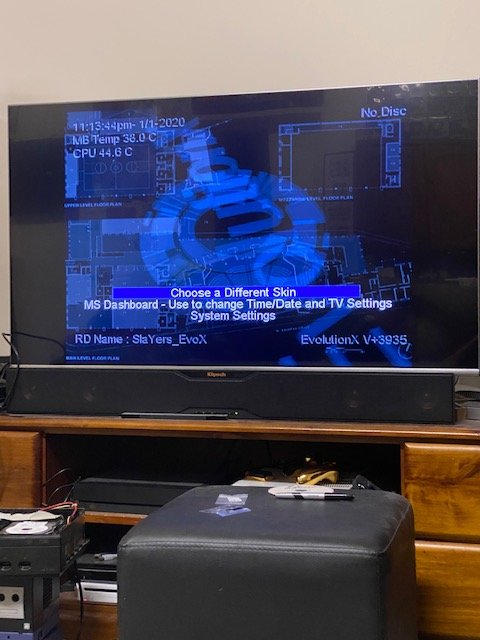

Please make a backup of the BIOS that displays Slayers 2.7 using Evoxdash's backup option.  Download the bios.bin file it creates in the Backup subfolder where evoxdash.xbe is located on your Xbox's hard drive. Post a copy of the file here or to a bit locker site and post the address so I can download it.

Adding pictures/photos
