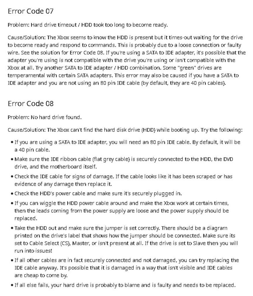

it's an xbox i bought a while back. it has an error 7 that i couldn't resolve so i have been using it for parts. i'm just brainstorming what could have been wrong with it. i tried a different ide cable but it had no effect. will a bad hdd can an error 7?
Service Error 07:
Info: Hard Disk timeout.
Solution: Check the IDE Connection/Cable and check the Power Supply.
That could be the hard drive itself the IDE cable or the 12 volt supply to the HDD (yellow wire ) the DVD drive upsetting the HDD by the HDD been set as a slave.
I have had some where the 12 volt to the HDD in the 4 pin molex plug has come loose.
What error comes up with no drives and with HDD only,DVD only?
2 hours ago, SS_Dave said:
Service Error 07:
i don't remember if i ever tried it with dvd and no hdd. i always got a code 7 regardless of what i did.
A bad 12 volt supply could cause that as the PCB on the hard drive is working from the 5 volt but the platters are not spinning because they are powered from the 12 volt
On a Xbox the 12 volt supply is to run the Fan/Fans and the HDD only.
