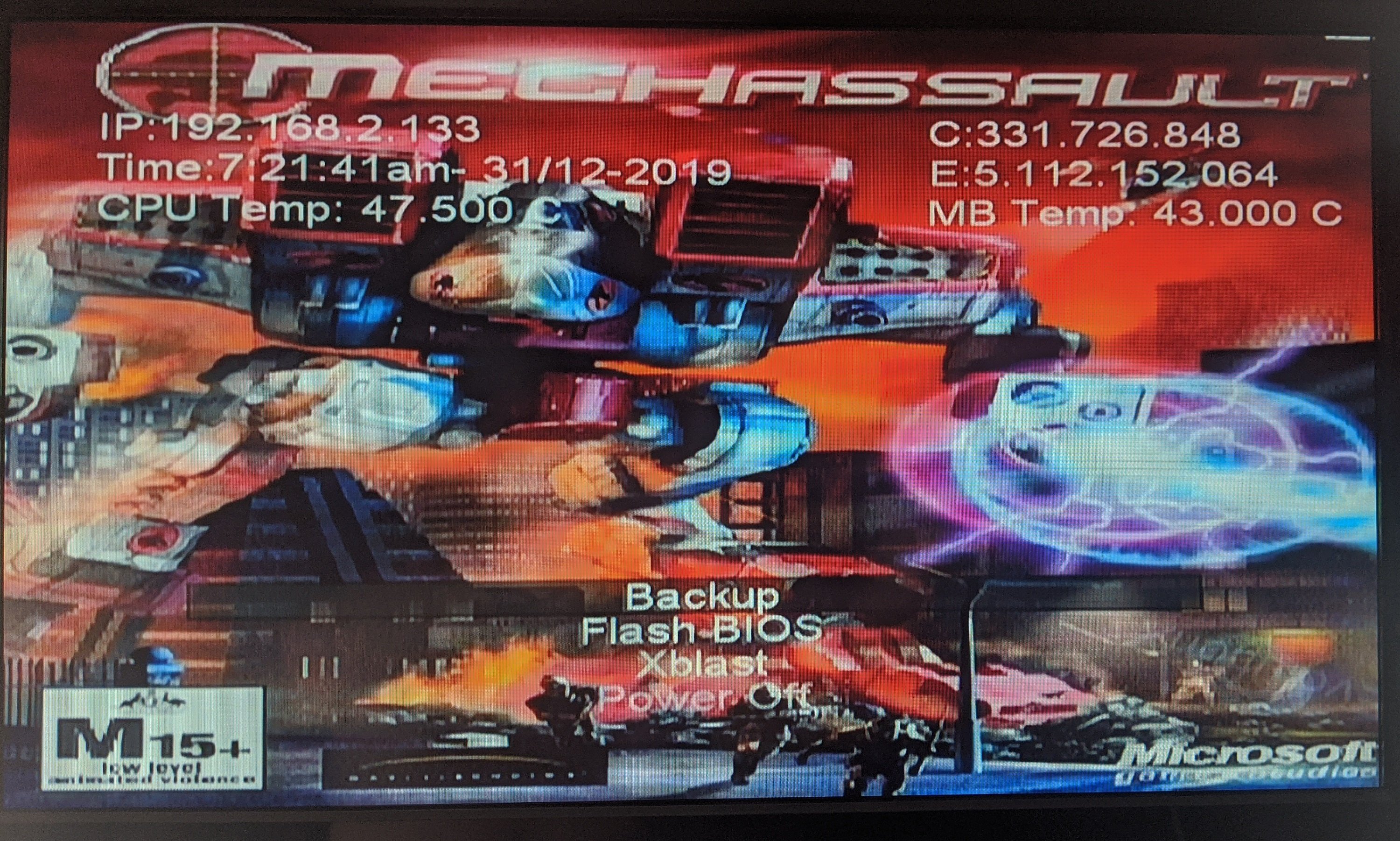

SS_Dave Posted February 7, 2020 Report Share Posted February 7, 2020 This is the screen on my version of the Mechassault Game save hack. 1st Test the Xbox before you go to far then open the Xbox clean it remove the clock cap and add the 2 links to enable flashing. 2nd Reassemble it and test to make sure it's still working. 3rd Copy the game save from you memory card/USB to the Xbox and if the same game save is there already there remove it 1st then copy. 4th load the game in this case Mechassault and launch the game save. 5th If you have put a BIOS in the game save files bios folder you can use the Flash Bios menu or you can use Xblast to flash the BIOS via a network connection,. 6th TSOP Flash compleat. Now fit a new Hard drive and using you favorite install disk do a clean install. Games the can do this are 007 Agent Under Fire, Mechassault,Splinter cell,Tony Hawks Proskater 4. Cheers SS Dave Those that can Hard-Mod. Those that can't Soft-Mod. 2 Quote Link to comment Share on other sites More sharing options...
Swirlygiver Posted February 7, 2020 Author Report Share Posted February 7, 2020 19 hours ago, SS_Dave said: 5th If you have put a BIOS in the game save files bios folder you can use the Flash Bios menu or you can use Xblast to flash the BIOS via a network connection, Where do you get the BIOS? And how do you add them? Quote Link to comment Share on other sites More sharing options...
Swirlygiver Posted February 7, 2020 Author Report Share Posted February 7, 2020 And I don’t see a bios folder Quote Link to comment Share on other sites More sharing options...
HDShadow Posted February 8, 2020 Report Share Posted February 8, 2020 I was going to ask that too. Not all installers UDATA 21585554 > 000000000000 folders contain a BIOS folder. SID5.11 doesn't and I've just had a quick search through some other softmodding packages and I can't find any that do. I'd assume you create that yourself and either the flashing tool would use it by default or you can point it at that location. But that does need clarification. HeXen, AID, SID, Rocky5 XSMT downloads are your best source for BIOS files. EvoX dashes also come with a BIOS folder but most of those are old and not recommended. There are some Xbox BIOS collections downloads you can also find, maybe some here too. HeXEn, particularly the updated versions, have the biggest selection. HeXEn, AID etc usually come as an ISO for burning to disc so if you just want the BIOS files you can extract them on PC using Qwix or C-Xbox Tool. Quote Link to comment Share on other sites More sharing options...

SS_Dave Posted February 10, 2020 Report Share Posted February 10, 2020 I did say it's my version of the Mechassult game save hack and it's a single game save. There is a Bios folder in the game save that has BIOS's in it or you can use Xblast to flash via the network. You also have the option to FTP to a bog stock Xbox and retrive the eeprom backup folder that can be made from the main menu also lock/unlock a hard drive and any other option that Xblast offers. Cheers SS Dave Those that can Hard-Mod. Those that can't Soft-Mod. Quote Link to comment Share on other sites More sharing options...
