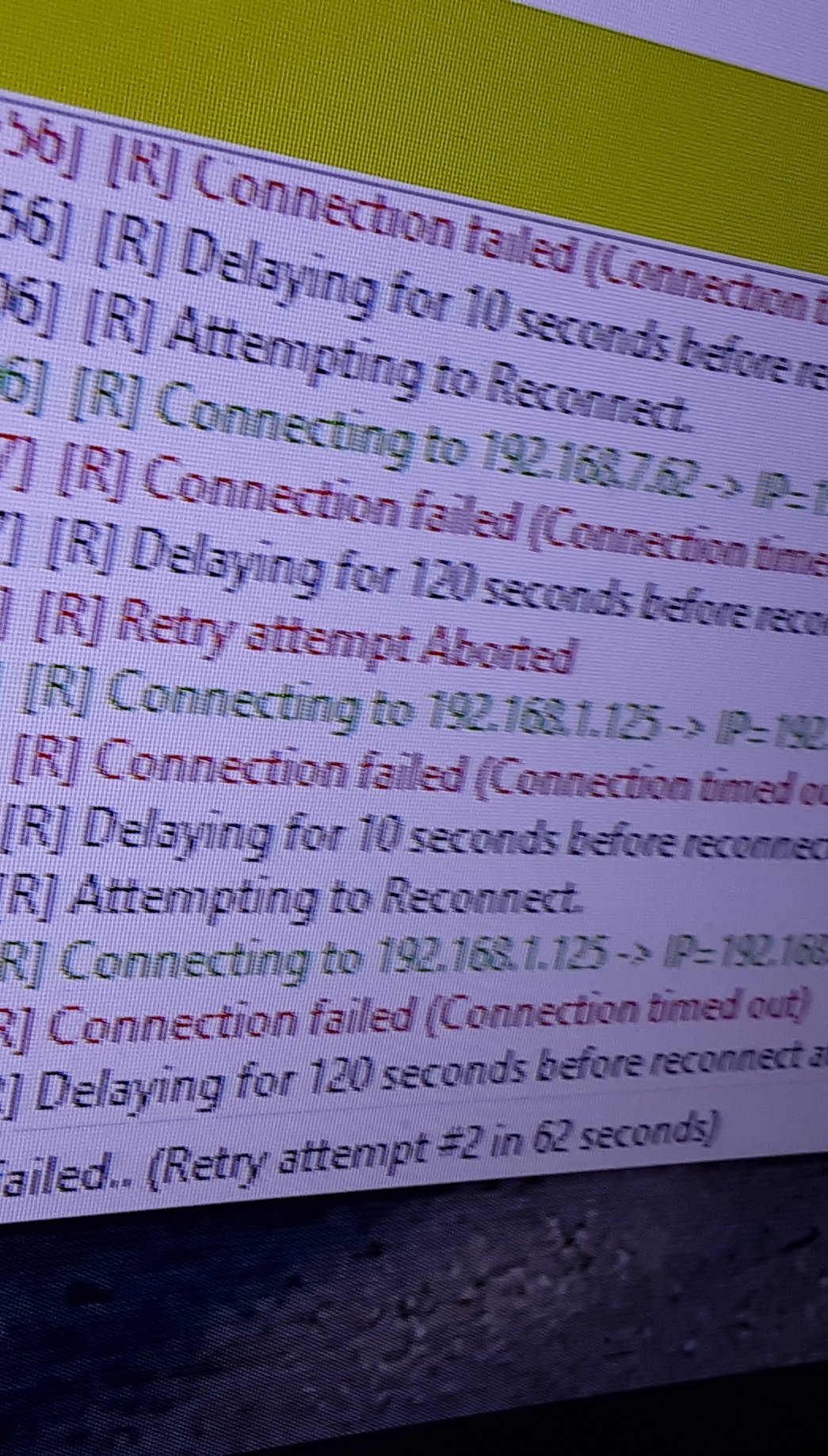

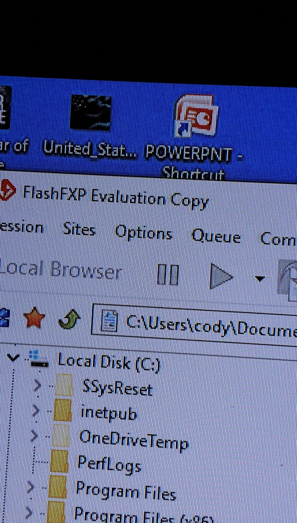

I got a copy of FlashFXP 5 works for some and other xboxes not .
Does anybody know why? And is there a way better programs ?
192.168.7.62 is on a different subnet than 192.168.1.125.
For the PC and Xbox to communicate, the two devices have to be on the same subnet.  The subnet is set by the subnet mask value.  For most home networks the subnet mask is 255.255.255.0 which means that all the bits that are 1 from the left-most of the address have to match in the two devices IP addresses to be able to talk to each other.
255.255.255.0 = 11111111.11111111.11111111.00000000 in binary
thus, the first 24-bits (AAA.BBB.CCC) of the quad-dotted decimal IP address (AAA.BBB.CCC.DDD) of both devices have to be the same.
For example: The PC is at 192.168.1.2 and the Xbox is at 192.168.1.125
PC IP address in binary = 11000000.10101000.00000001.00000010
Subnet mask                   = 11111111.11111111.11111111.00000000 <bitwise AND>
PC is on the subnet       = 11000000.10101000.00000001.00000000 ==> 192.168.1.0.
Same goes for the Xbox at 192.168.1.125.
Xbox IP address in binary = 11000000.10101000.00000001.01111101
Xbox is on the subnet        = 11000000.10101000.00000001.00000000 ==> 192.168.1.0.
These two machines are on the same logical subnet. If they are also connected to the same physical network, they can talk to each other.  Any other device with a unique IP address from the address pool 192.168.1.1 to 192.168.1.254 can communicate with devices attached to the same physical network. (The last IP address in this subnet is a reserved address. All the remaining bits of the quad-dotted decimal value to the right of the 1's in the subnet mask are set to 1. Thus, 192.168.1.255 which is represented in binary as 11000000.10101000.00000001.11111111. This reserved IP address is known as the network broadcast address.  A data packet sent to this IP address will be received by all devices attached to the same physical and logical sub-network.)
However, 192.168.7.62 is on a different subnet and cannot talk to the devices on the 192.168.1.0 subnet even though the networked devices are attached to the same PHYSICAL network.
  11000000.10101000.00000111.00111110
  11000000.10101000.00000111.00000000 ==> 192.168.7.0 is not equal to 192.168.1.0.
The devices are logically prohibited from communicating with each other.  They are on two different subnets.

From the pictures you posted, I see no FTP connection was ever established.  Do you have the IP address of one that worked?
What is the IP address of your PC?  192.168.0.xxx, where xxx is from the range of values 1-254.
For the PC and Xbox to complete an FTP connection, they both have to be on  the same logical and physical subnet/network.
