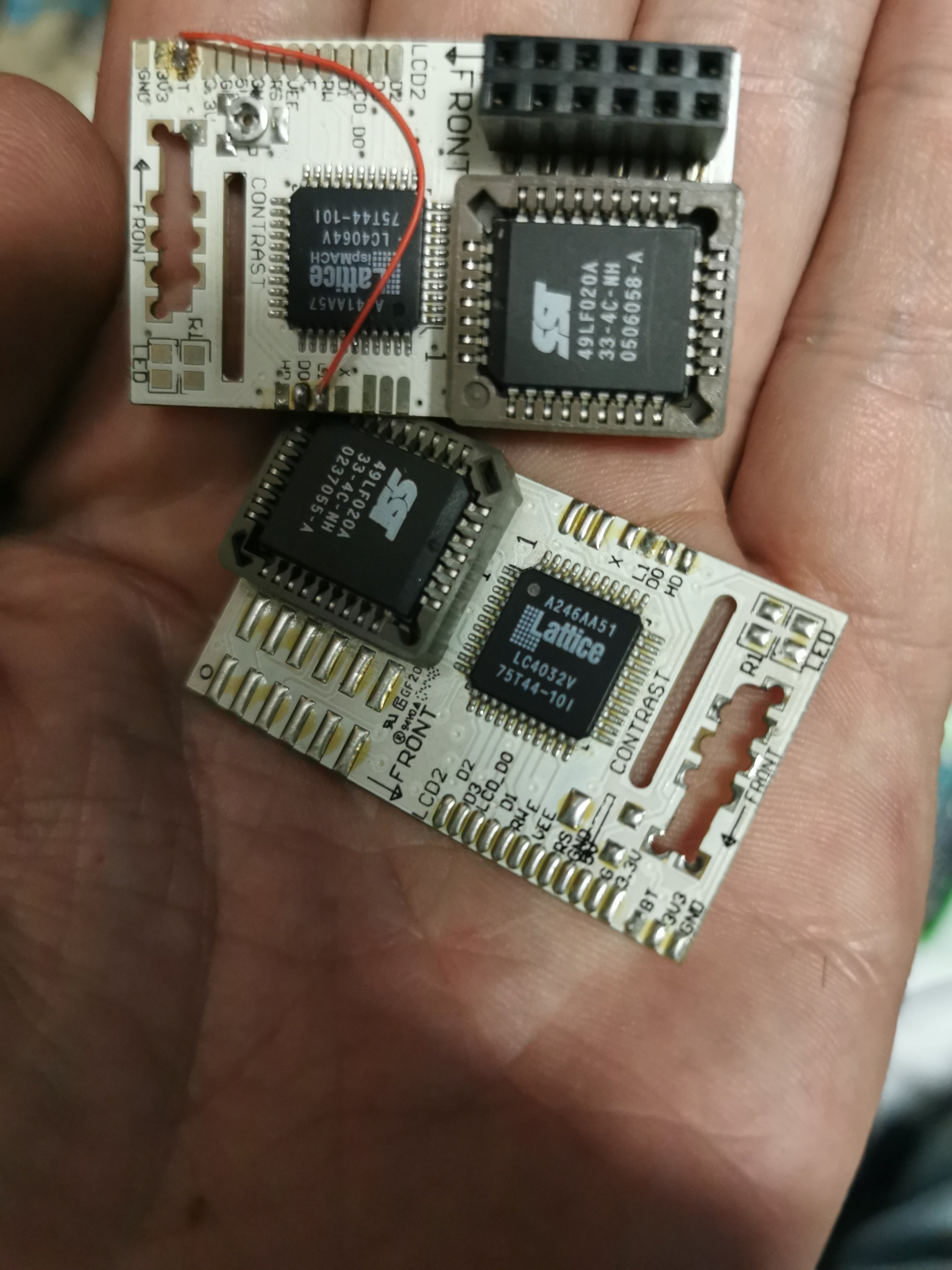

it's a aladdin  xt lite Cromwell version same pcb layout as the 4064just no headers and a 4032
That helps a lot! So... the mystery has been solved. The OP's chip is a Xenochip Lite, a clone of the Aladdin XT without the pinheaders! It also looks like someone else had the same problem a couple of years ago: Please login or register to see this link.
In that thread, the OP never did manage to flash from the Xbox, they had to resort to an external programmer as I probably would have done. So you are very lucky that XBlast now exists!
Apparently the reason yours is white is because a select few were made as Christmas specials in 2004- read through the AssemblerGames thread I linked to and KaosEngineer's post confirms this.
Thank you so much, I will be adding that to my text file for future use.
