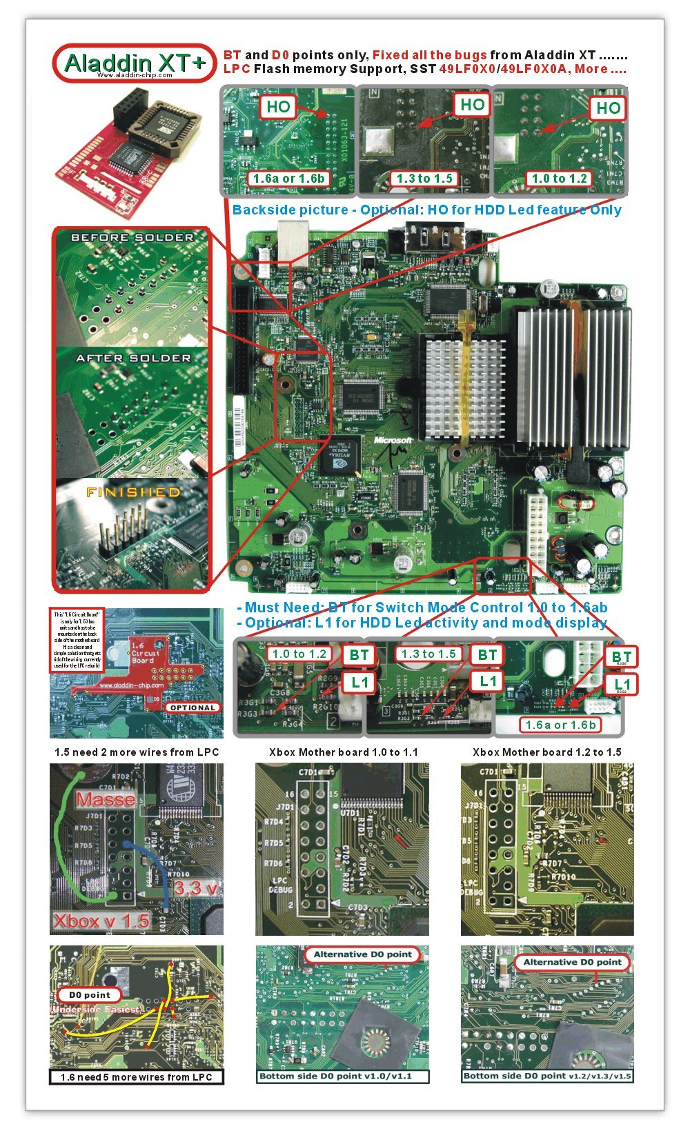

sinclairuser Posted October 16, 2019 Report Share Posted October 16, 2019 (edited) hi fitting this chip in 1.4, header is installed xbox boots normally with no chip installed. but where is do on 1.4?, and do i ground it or solder it to D0 on the chip?. all info ive found is or 1.6 its so confusing. thanks. Edited October 16, 2019 by sinclairuser Quote Link to comment Share on other sites More sharing options...

SS_Dave Posted October 16, 2019 Report Share Posted October 16, 2019 This is the 3rd time some one has asked the same question in 2 days If you link the BT point on the mod chip to GND the chip will be always on. That means you only have to solder the D0 point on the chip to D0 point on the mother board. SS Dave Those that can hard-mod, Those that can’t soft-mod. Quote Link to comment Share on other sites More sharing options...

SS_Dave Posted October 16, 2019 Report Share Posted October 16, 2019 That's ok. You can just ground the D0 from the mother board as well. SS Dave Those that can hard-mod, Those that can’t soft-mod. Quote Link to comment Share on other sites More sharing options...
c0tt0nm0ufh Posted October 16, 2019 Report Share Posted October 16, 2019 solder d0 to ground, solder chip to always on. Quote Link to comment Share on other sites More sharing options...
sinclairuser Posted October 16, 2019 Author Report Share Posted October 16, 2019 1 minute ago, c0tt0nm0ufh said: solder d0 to ground, solder chip to always on. d0 on the chip or mainboard Quote Link to comment Share on other sites More sharing options...
SS_Dave Posted October 16, 2019 Report Share Posted October 16, 2019 D0 on the main board to ground and not to the chip BT on the chip to ground and not to the main board. SS Dave Those that can hard-mod, Those that can’t soft-mod. Quote Link to comment Share on other sites More sharing options...
sinclairuser Posted October 16, 2019 Author Report Share Posted October 16, 2019 the way i understood it, solder D0 to D0 on chip=modchip on but if it fails it boots tsop. solder D0 to ground= chip on but if it fails it frags. the stuff i read said D0 to ground but which D0 chip or board. but i have got it now, thanks to dave, and cottonmouth. Quote Link to comment Share on other sites More sharing options...
SS_Dave Posted October 16, 2019 Report Share Posted October 16, 2019 3 minutes ago, sinclairuser said: the way i understood it, solder D0 to D0 on chip=modchip on but if it fails it boots tsop. solder D0 to ground= chip on but if it fails it frags. That's it SS Dave Those that can hard-mod, Those that can’t soft-mod. Quote Link to comment Share on other sites More sharing options...
c0tt0nm0ufh Posted October 16, 2019 Report Share Posted October 16, 2019 You solder the d0 point to a ground on the back of the Xbox motherboard. If memory serves, you can use the screw holes on the back of the board. Then you solder a small wire on the alladin so thats it's always on. The BT i think. You COULD solder the d0 point to the modchip, but I've never tried it. Quote Link to comment Share on other sites More sharing options...
SS_Dave Posted October 16, 2019 Report Share Posted October 16, 2019 16 minutes ago, c0tt0nm0ufh said: . The BT i think. You COULD solder the d0 point to the modchip, but I've never tried it. If you do that it won't activate the chip as the BT on the chip will not get pulled to ground to activate the chip SS Dave Those that can hard-mod, Those that can’t soft-mod. Quote Link to comment Share on other sites More sharing options...

sinclairuser Posted October 16, 2019 Author Report Share Posted October 16, 2019 1 minute ago, nikeymikey said: Do you have it the right way around? The writing on the back of the chip should be the correct way to read when looking from the front of the Xbox. yes mikey, its due to where the caps are on 1.4, its definately the right way round i'm going to sand a "cats knacker" off the bottom edge. while your here what is your opinion on the D0, on a 1.4 would you ground it or connect it to D0 on the chip, i like the idea of booting the stock bios if the chip fails, but i'm not convinced thats intended for xboxes other than 1.6. i know it sounds like i'm pussyfooting around but i dont want to get it wrong. Quote Link to comment Share on other sites More sharing options...
nikeymikey Posted October 16, 2019 Report Share Posted October 16, 2019 I personally just ground the d0 on every Aladdin install i do, using the point n the top of the board and a screwhole. Quote Link to comment Share on other sites More sharing options...
