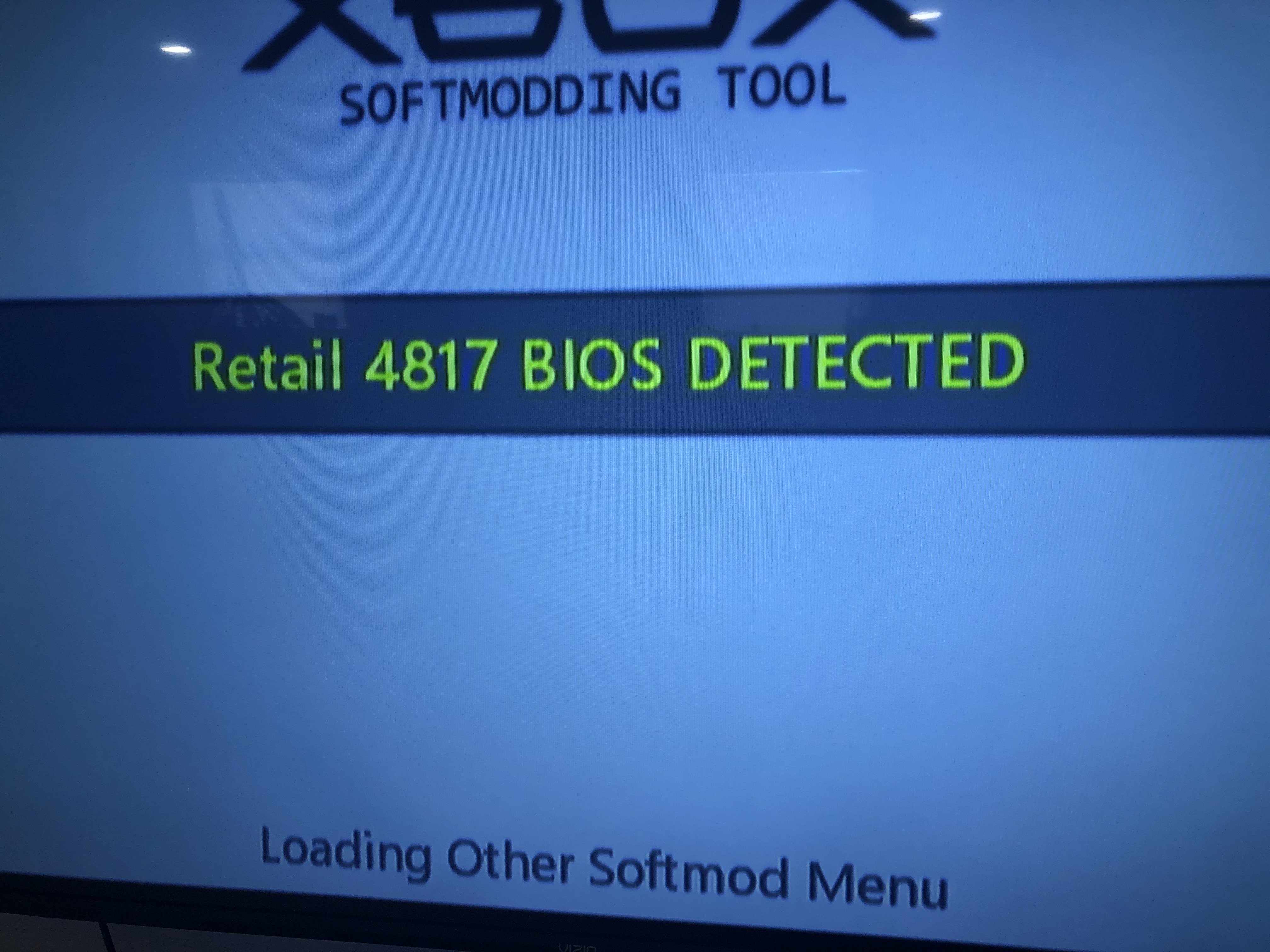

TanMetal Posted January 18, 2020 Report Share Posted January 18, 2020 (edited) my softmodding tool says retail bios 4817 detected- swiching to other softmodding menu, and then it just goes to a black screen and the led flashes green. Edited January 18, 2020 by TanMetal additional info Quote Link to comment Share on other sites More sharing options...
TanMetal Posted January 19, 2020 Report Share Posted January 19, 2020 21 hours ago, TanMetal said: my softmodding tool says retail bios 4817 detected- swiching to other softmodding menu, and then it just goes to a black screen and the led flashes green. I'm sorry, it actually says "loading other softmod menu", and then it just goes blank, any help/suggestions? Quote Link to comment Share on other sites More sharing options...
