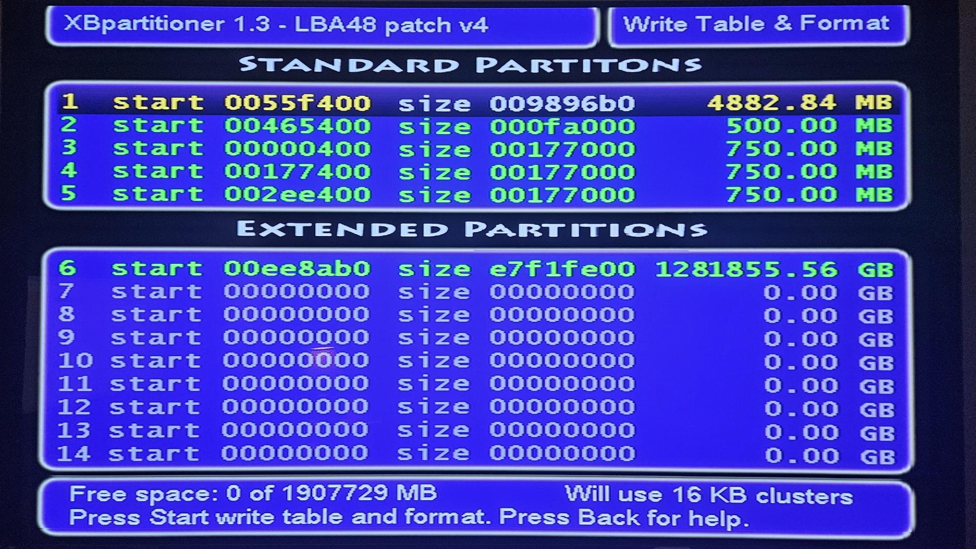

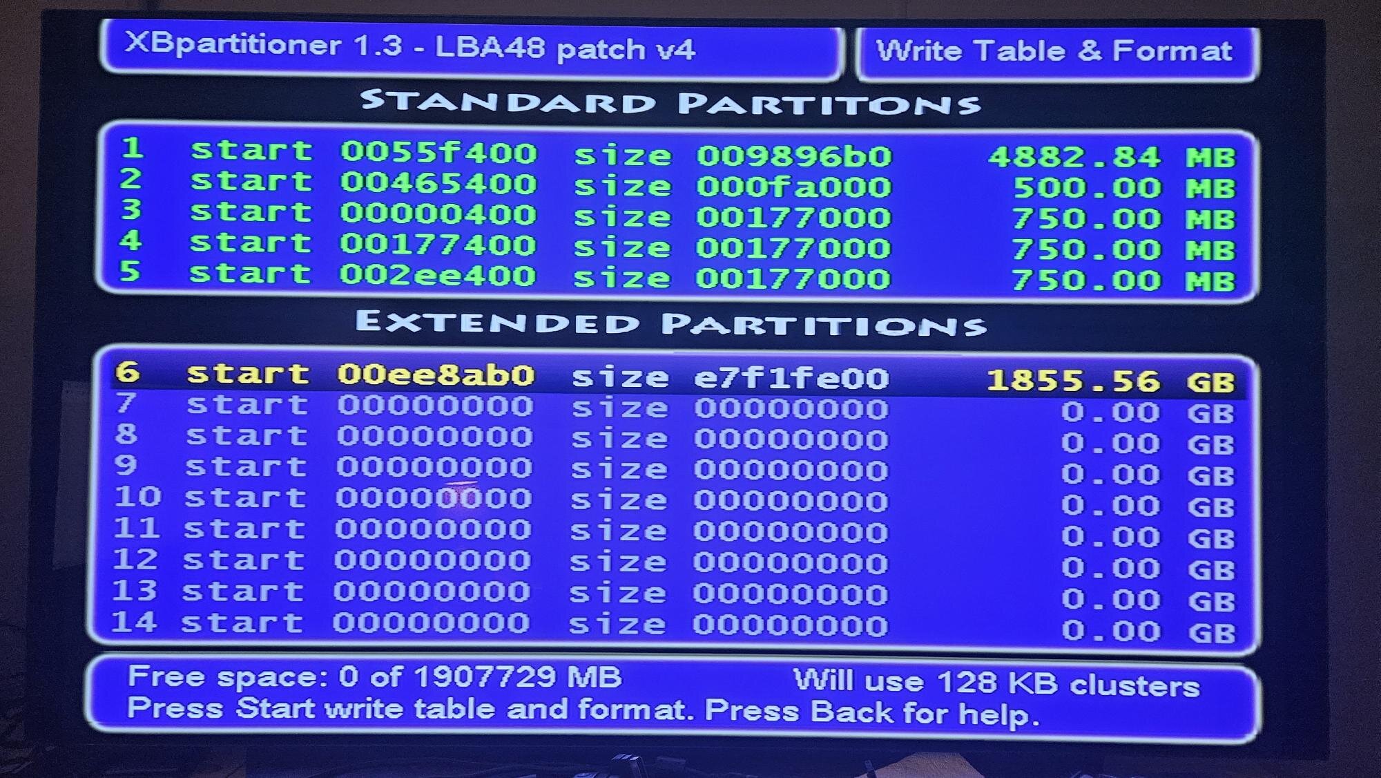

FrostyMaGee Posted April 2, 2024 Report Share Posted April 2, 2024 (edited) 23 minutes ago, NokSueCow said: I tested these games on my 2TB Cerbios softmod and they all load to the main menus. WD20EZBX, Startech adapter, 80 wire, UDMA 5, CCI. I haven't tested all my games yet, but I'm having trouble with Crimson Skies not loading. It either goes to a black screen, or the load screen appears with the skull at the bottom, and the arrows around the skull rotate a few degrees and then the system hangs. I think my issue is related to an incorrect time/date, as 4Gamers wont set the right time. I downloaded a fresh redump off Archive and it wouldn't play either extracted or CCI. This is what XBP v1.3 shows when formatted through FatX. I just tested Crimson Skies on a few I have here. All Rocky5 softmods, clock cap removed on two of them, 2Tb drives, 80 wire 40 pin cables, startech adapters, and not that this has anything necessarily to do with it but all have either been recapped or at the very least have the cpu caps replaced. None were hooked up to Ethernet cables. All loaded the game fine and I was able to start and play through level one on each. The other difference here is this game is ripped straight from the game disc I own and in unpacked form. Also using just the standard unleash dash that comes with Rocky5’s softmod by default. Is it possible there are just bad rips out there? I mean that kind of seems unlikely but I guess they could be copies of the same redump. Is there something in Cerbios that could be causing this? Maybe even changing the dash might make a difference since you said xbmc4gamers is what you were using? Couldn’t recall if you’d tried that from your other post. I’m not sure why the time would cause that though. Very strange. Edited April 2, 2024 by FrostyMaGee Quote Link to comment Share on other sites More sharing options...
