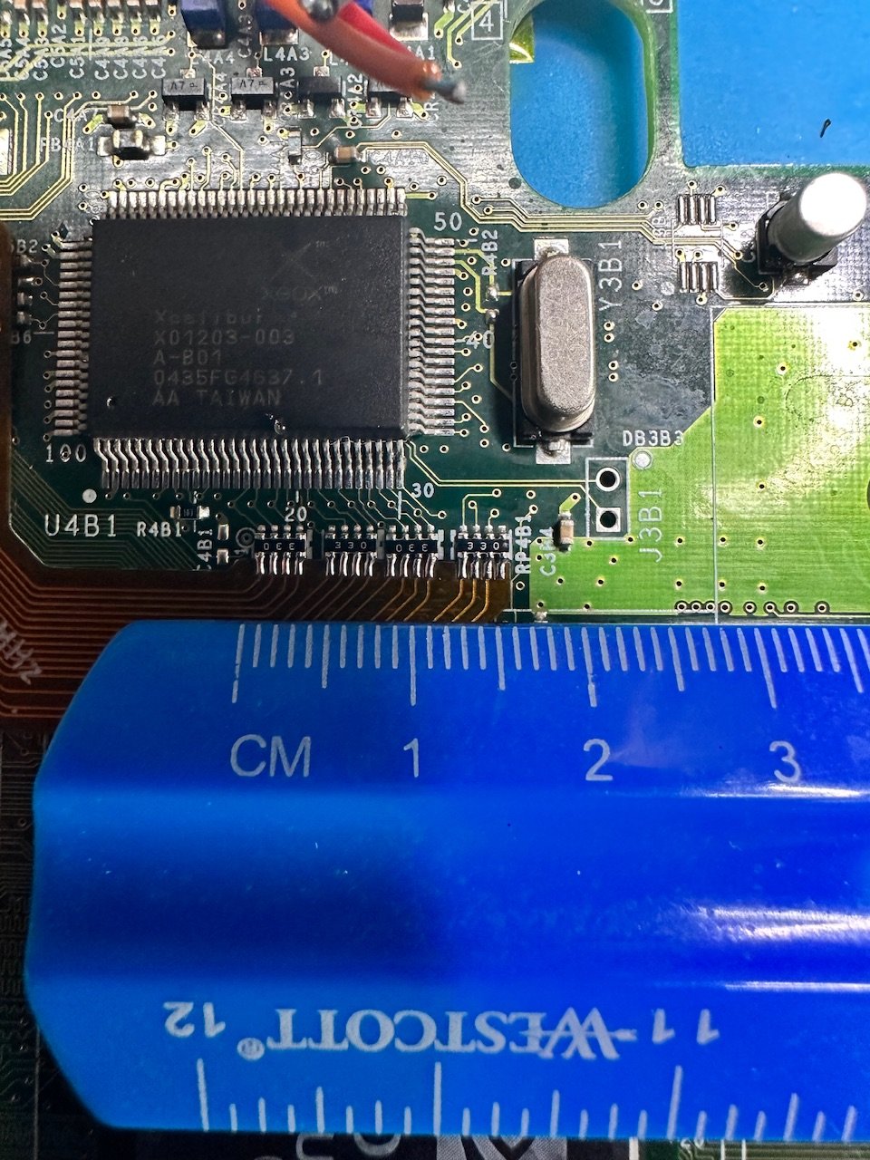

Bowlsnapper Posted June 18 Report Share Posted June 18 1 minute ago, NeMesiS said: Your better off comparing what I'm trying to do with the XboxHD+ not the StallarHD+ 0.5mm spacing I think... much like the xenium... I intent on selling preassembled unit much like what I've been doing. Is there a difference between the two HD+ units, other than Dustin making it impossible to use without Stellar and pulling an Apple move? How many units do you plan on producing anyway? Enough to cover the demand I know there will be? That's a lot of soldering if you're doing them by hand. Quote Link to comment Share on other sites More sharing options...
NeMesiS Posted June 18 Author Report Share Posted June 18 Just now, Bowlsnapper said: Is there a difference between the two HD+ units, other than Dustin making it impossible to use without Stellar and pulling an Apple move? How many units do you plan on producing anyway? Enough to cover the demand I know there will be? That's a lot of soldering if you're doing them by hand. There's no MCU on the StellarHD+ HDMI module Thats as about as far as I looked into that. I'll keep making them so long as they keep selling. After I'm confident with final design and had some testers try it out. I'll probably start with a small batch of 100pcs. 2 Quote Link to comment Share on other sites More sharing options...
Bowlsnapper Posted June 18 Report Share Posted June 18 7 minutes ago, NeMesiS said: There's no MCU on the StellarHD+ HDMI module Thats as about as far as I looked into that. I'll keep making them so long as they keep selling. After I'm confident with final design and had some testers try it out. I'll probably start with a small batch of 100pcs. I'll definitely want one. For now, I'm afraid to solder... Maybe I'll be better by then... Thank you for answering all my questions. I know I have a lot of them. Quote Link to comment Share on other sites More sharing options...
sweetdarkdestiny Posted June 18 Report Share Posted June 18 15 minutes ago, Bowlsnapper said: Oh my GOD. How can I ever hope to solder that...The legs are VERY close together. I think I would be entering commercial territory and having to use heat and solder paste, correct? Or is it easier than I'm assuming it to be? Everthing comes down to your personal skill (in the very first place) and the tools you use. Look at one of your TSOP's. If I'm not wrong those are 0.5mm pitch. Not to hard to solder under a microscope and the right tip. Quote Link to comment Share on other sites More sharing options...

Bowlsnapper Posted June 18 Report Share Posted June 18 7 minutes ago, sweetdarkdestiny said: Everthing comes down to your personal skill (in the very first place) and the tools you use. Look at one of your TSOP's. If I'm not wrong those are 0.5mm pitch. Not to hard to solder under a microscope and the right tip. Lol, you make it sound so easy! And yes, you're probably right. 6 minutes ago, NeMesiS said: All good... Have you or anyone else installed one of the HDMI mods before? Could there be any improvements in regards to installation? Tomcat's definitely more qualified right now to install an HDMI mod. The ribbons worry me because I can't see what I'm soldering, I think. Aren't the points underneath? By the time you start testing or shipping these, I will be able to do an install. I learn fast and just haven't because I've been working... up until now. Lol. I definitely need a better Iron, though... Quote Link to comment Share on other sites More sharing options...
