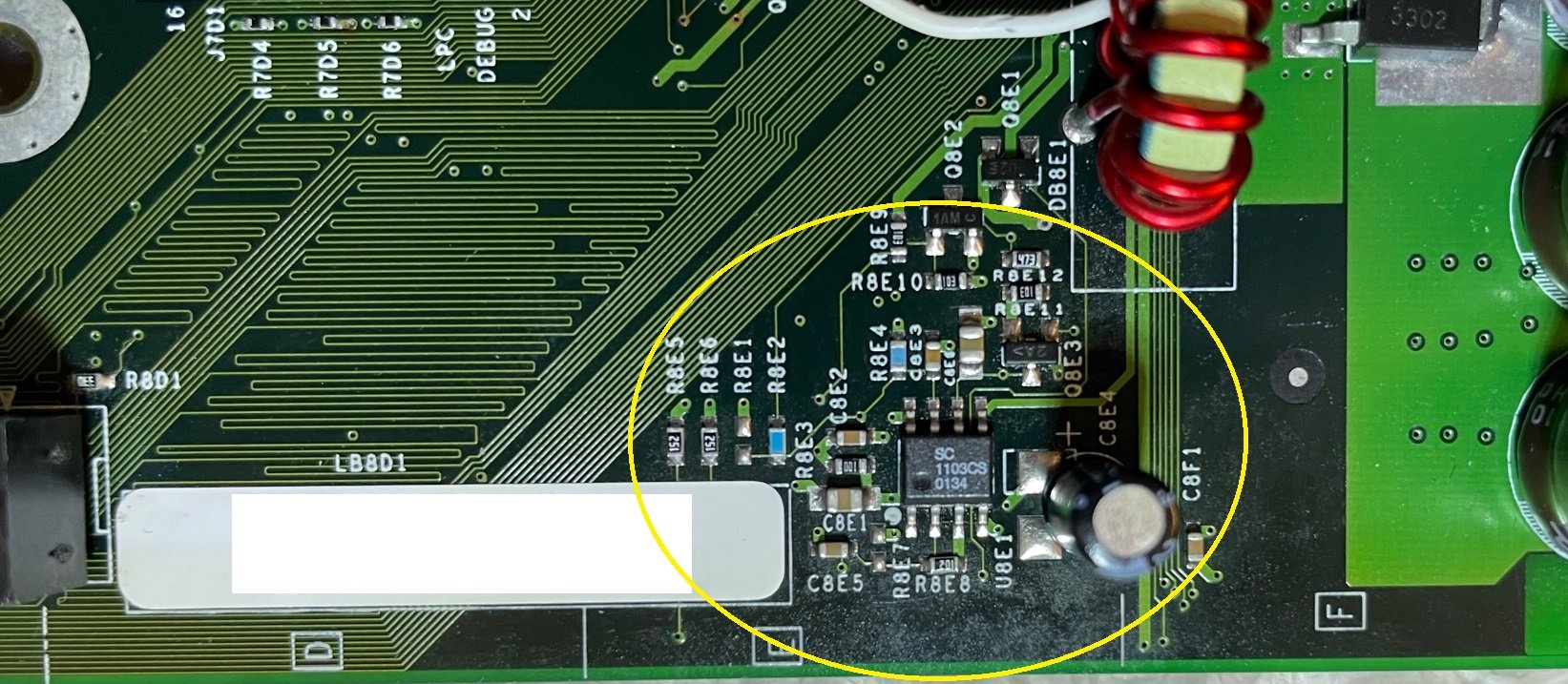

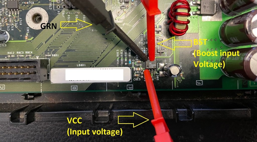

A little update from my side :
1.0 motherboard for now the repair is put on hold...
for the 1.4 motherboard, after a clean with ultrasonic cleaner, the console start again to boot and works as usual... For test I left the console on for 3 hours no issue so far...After that I removed again from the shell and prepared for 128MB ram mod, tinted the pads clean with isopropyl alcohol and tested again.... unfortunately same issue of before... frags red / green light... checked again all the pads for shorts ecc without luck... everything been done correctly.
The caps seems to be ok but a recaps of the motherboard can help or is just a waste of money?
