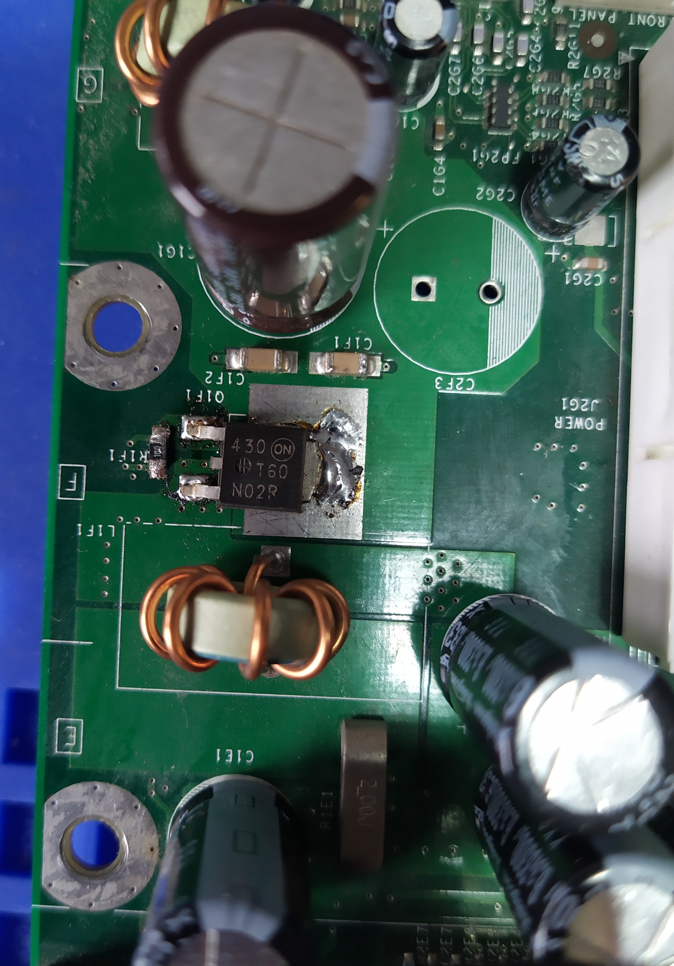

A high quality phot of the board might also help us.

If it helps when I press the power button it makes a single click and the yellow led in the lan port flashes once? I will take some pictures of the boa
