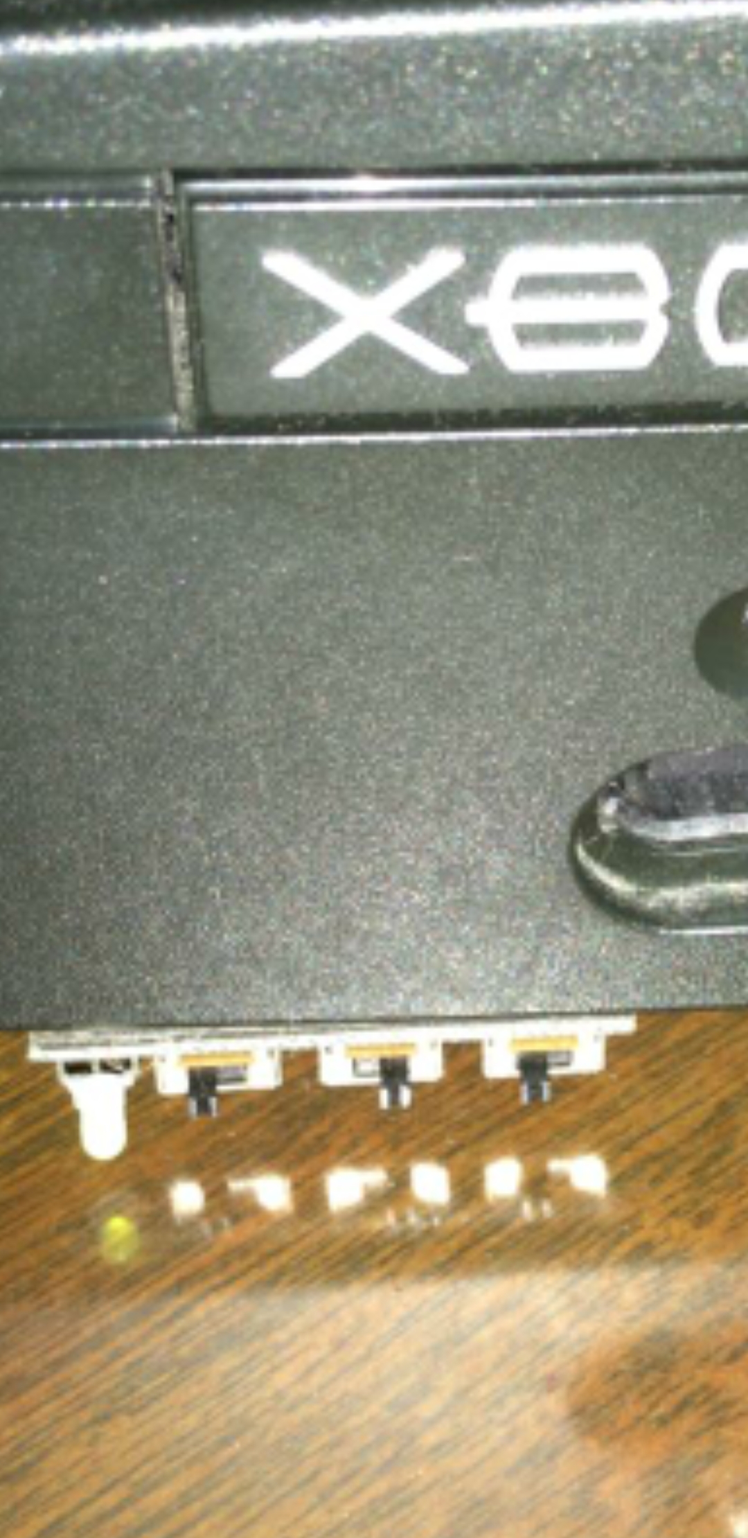

It has literally been over 10 years since I've played it. One of the bootup screens says "Xecutor2" at the bottom, so that tells me that much at least.
My main question is the three (3) dip switches on the front of the console. Someone else installed it for me, and I forget what each of them does.
I think that the left-most one controls whether or not the modchip is active; you wanted to toggle that one off if you ever went onto XBox Live, I think.
Can anyone help?

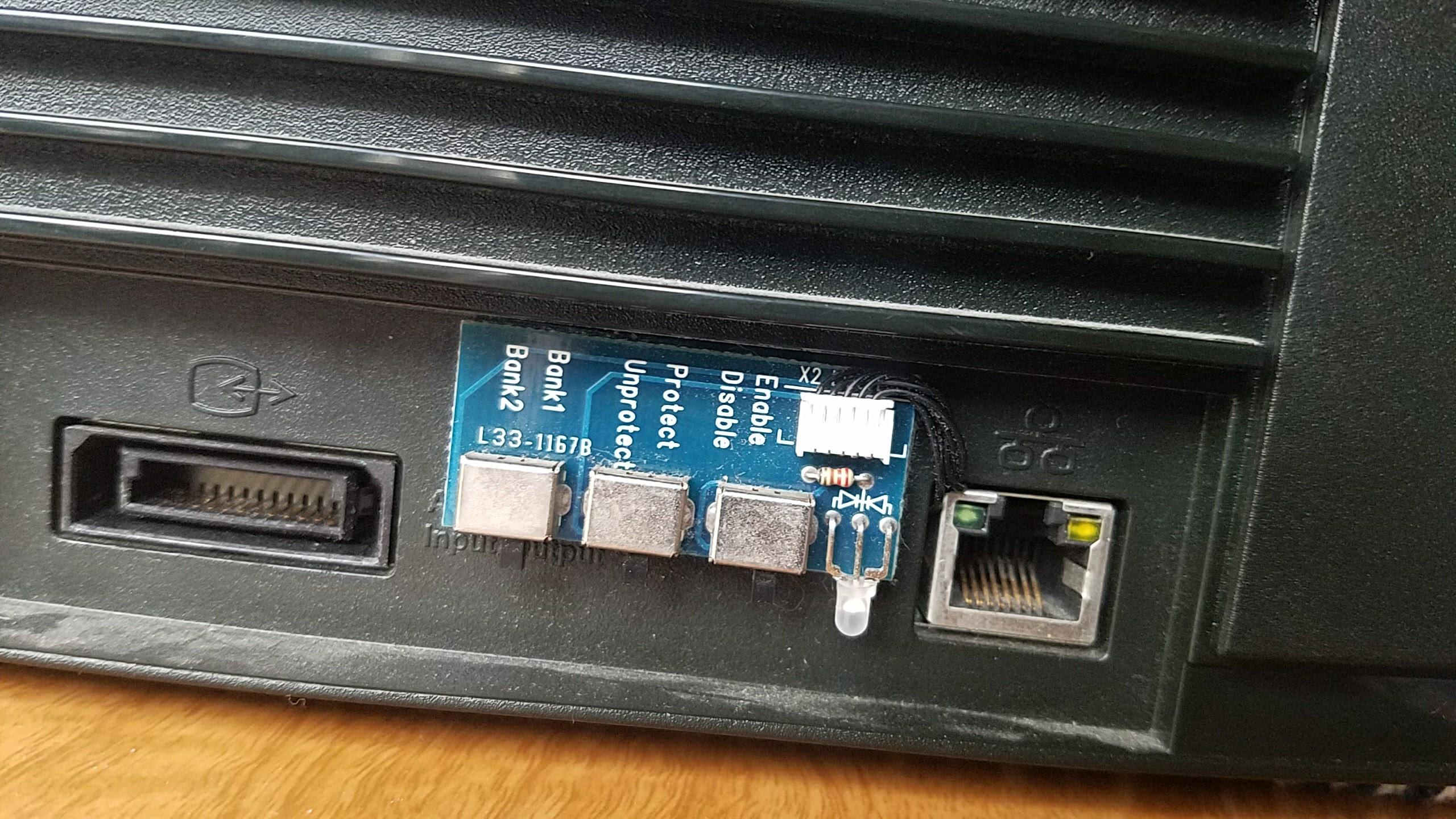

A pic of the chip and switches would probably help, Is it something like this
That looks a bit like a X2.3 modchip
1 of the switches is chip enable and disable there is also a bank 1 and 2 and write enable/disable to stop it been reflashed
it probably will need the BIOS updating as it will probably not support a large hard drive.
If you have the switch on enable and bank1 will it boot?
Thank you!
So, really, unless we ever try to re-flash it (for a larger hard drive, etc.), the only switch that matters is "chip enable/disable", correct?
Yes and if you need to reflash that chip you need to combine the 2 bios files into one 1024kb file then flash that.
