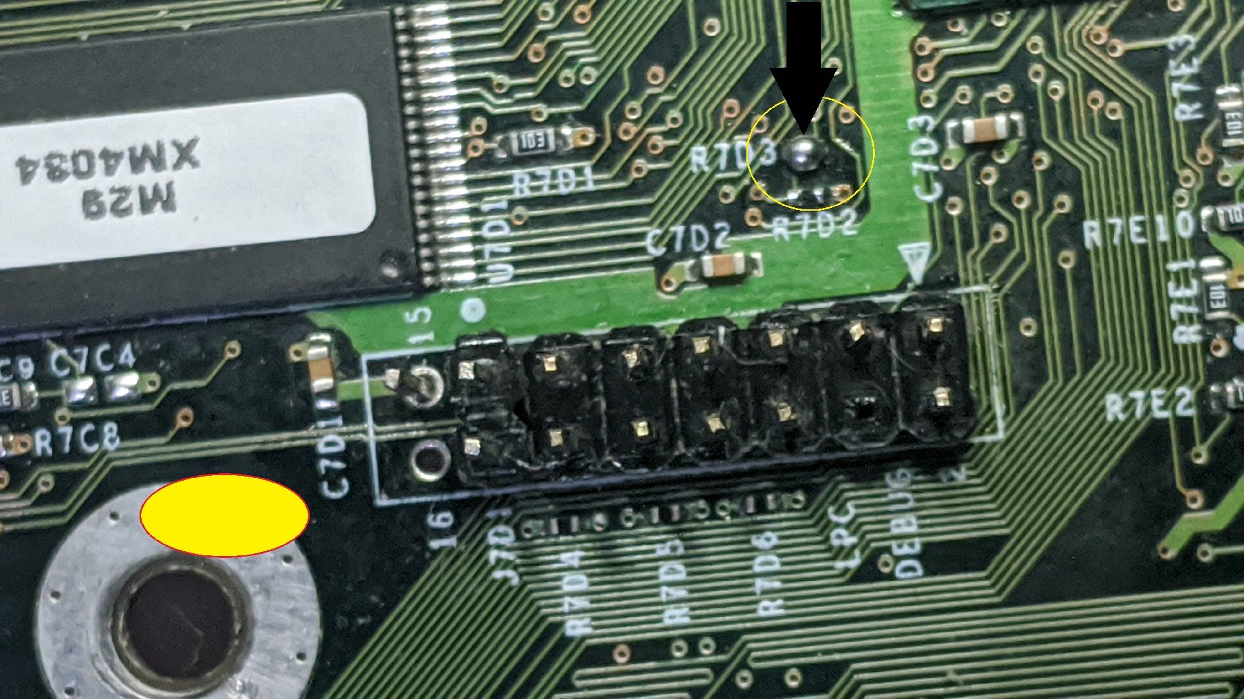

On a previous thread on this Forum you identified the other Xbox's chip as a Xkiller clone
I am not sure if this one will flash easily, I would be inclined to TSOP flash that one by load the hard drive with a softmod and make sure it has a TSOP flash on the drive as well (raincoat or Xblast).
Once the drive is locked to the Xbox you need to disconnect the blue wire as that is going to ground and the D0 on the board and if all has gone to plane it should boot of the TSOP, Don't forget to add the 2 TSOP write links 1 on the top and 1 on the bottom.
Once that's done you can now flash the TSOP to handle a large HDD and No-DVD.
Bottom
Top
hi, i was reading this thread and i got the impression you are not super confident with the tinkering, thats not meant as an insult.
its ok to be cautious, better cautious than bricking something, but if you want to flash your tsop and dont feel confident to solder the points, you can cut 2 small foil circles just big enough to cover the points, then place these on to two small squares of tape(in the middle), selotape is good as its see through.
when finished they should look like two small sticking plasters(bandaids), now stick these on the points for the tsop, make sure they are not too big, you dont want shorts.
then boot and flash with you favourite program, after you can just gently pull of the tape, it works iv'e tried it quite a few times now fist couple of times i used some copper foil i had but its not needed, it works just the same with aluminium foil, the best bit is you dont need a soldering iron.
