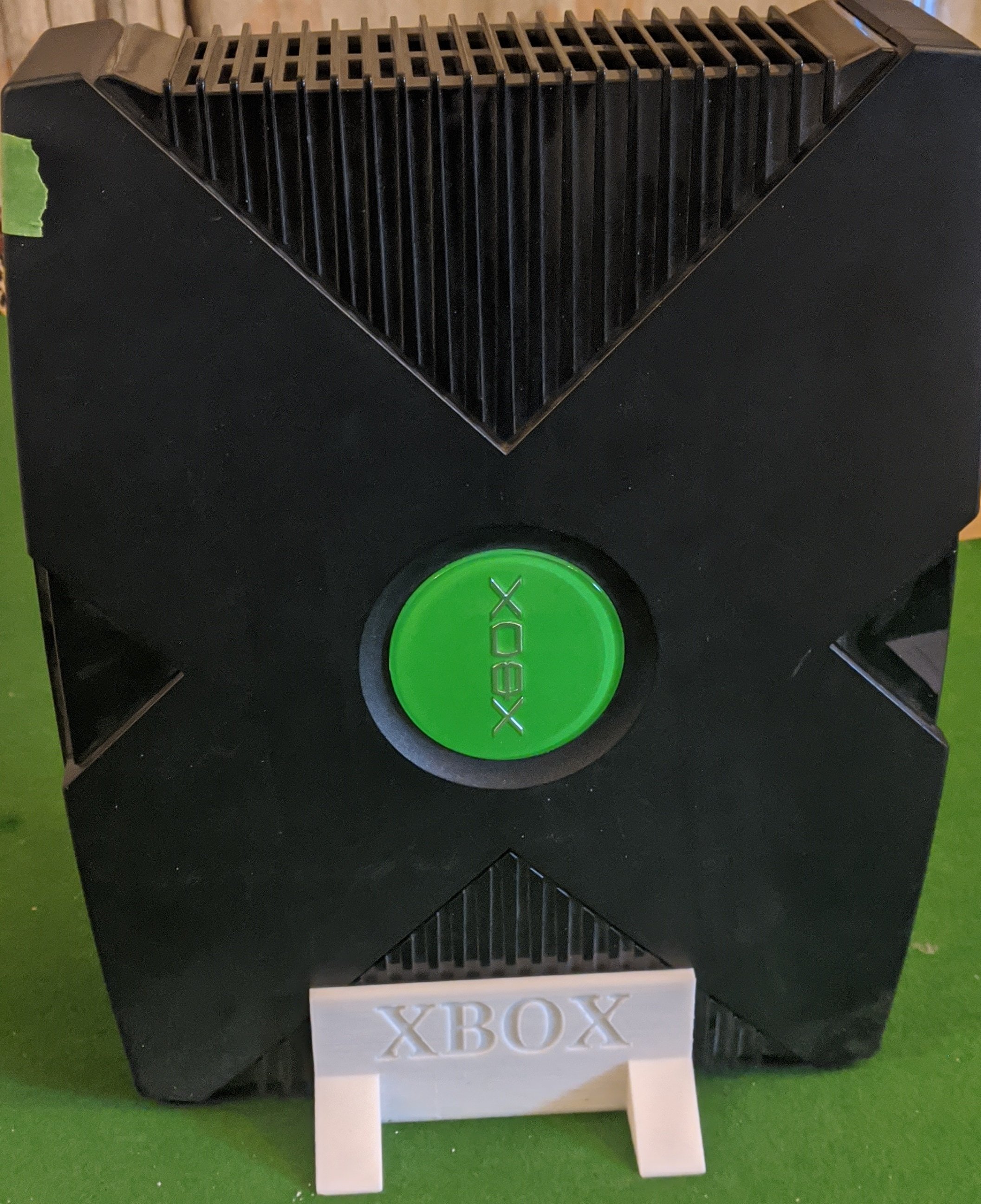

4 minutes ago, FirstS0ul said:
for the stability i can print something
That would be good and if you can lift it up a little bit that would help with air flow as there is air vents both sides.
And if you do print something post a pic of the finished item and maybe the STL files .
