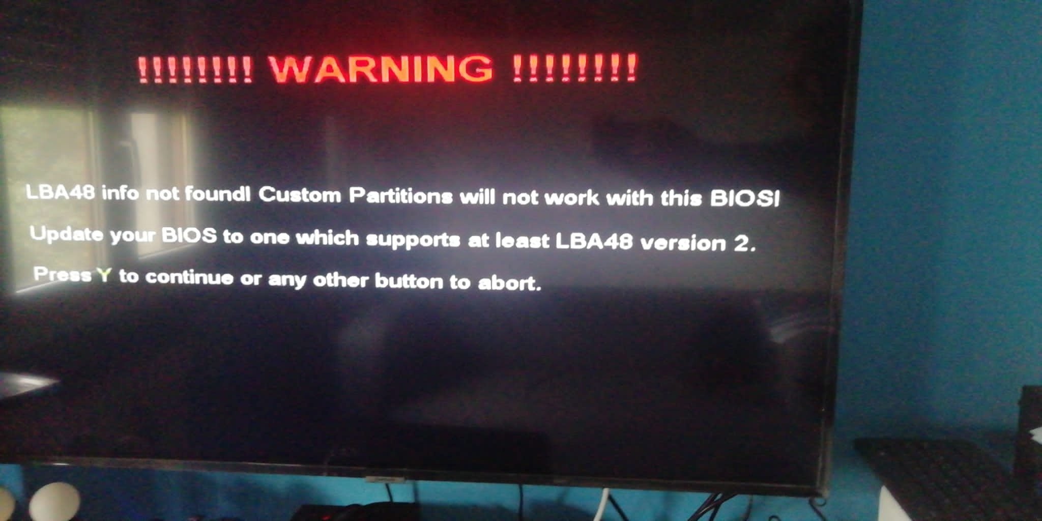

KaosEngineer Posted July 1, 2020 Report Share Posted July 1, 2020 20 minutes ago, Badore90 said: You're right, I forgot about its limit. We tried formatting with XBPartitioner, but it see only 120GB (on a 1tb HDD, the free space should be +900GB for extended partitions), so he only have options for a 120GB F drive or 60GB F + 60GB G. When pressing start he got this attached message. We formatted the extended partitions using chimp a couple days ago. My friend want a F partition only. Chimp splitted the space between F and G (about 460GB per partition) even if we select "F takes all the available space", probably due to a 32KB cluster limit. However it formatted the partitions without any error message. What about upgrading the BIOS, how it works?? It's a modchip related thing I guess. [Image removed, see above] Which BIOS is it using? The BIOS you are booting doesn't support reading an XBPartitioner partition table from the hard drive. And possibly, the use of 32KB or 64KB cluster allocations. Quote Link to comment Share on other sites More sharing options...
Badore90 Posted July 2, 2020 Author Report Share Posted July 2, 2020 Eventually he solved by himself. He flashed the bios with the slayer disc e thus XBP could correctly format the extended partitions. Thank you all again for the help. Quote Link to comment Share on other sites More sharing options...
