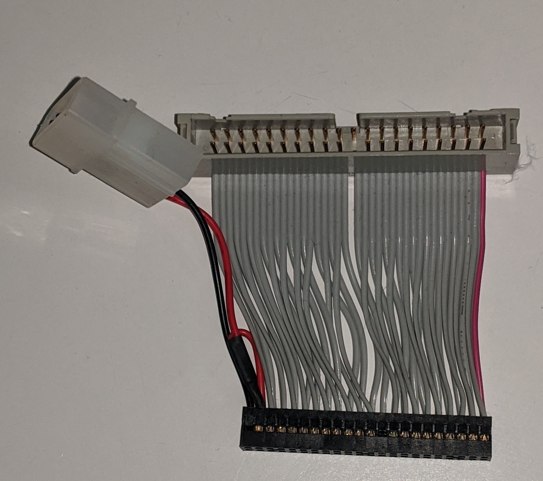

I have an unused 80GB 2.5" IDE HDD bought for an old laptop which died before I got around to fitting it.
The problem or maybe not a problem is the 2.5" IDE to 3.5" IDE adapter. I've found what I think are suitable ones on Ebay/Amazon (F 2.5" with M 3.5" to connect to the IDE cable). But the thing I'm not sure about is the power supply.
The ones I've found have a (F) Molex connector + cable but only wired with red and black cables. This I assume is 5v and ground ie. normal Molex power connections.
Is this enough to power the 2.5" HDD? It should be but it got me thinking about why the Xbox HDD power supply has both 5v and 12v connections (red + ground and  yellow + ground) if they're not both needed. If a standard 3.5" HDD in the Xbox needs more than 12v available perhaps a 2.5" HDD needs more than 5v too.
Knowledgeable advice appreciated.
Edited by HDShadow
I have used this to run an old laptop hdd in a PC before.
The 2.5 inch HDD's only need 5 volt.
The ones I've found are slightly less ugly than that but if you say it works with just the 5v connection that's what I wanted to know.
The one I have is very old but it did what I needed.
I have plenty of Xboxes with 3.5" IDE or SATA HDDs and I have no other sensible use for a pretty much virgin 80GB IDE 2.5" so what's the problem?
It'll generate less heat and should work just as well as a 3.5" and I'll bet will boot faster than any SATA HDD. Its a bit small but for the purpose intended, my CD music collection and a handfull of my go to Xbox games, like Timesplitters FP, it'll be fine.
too much hoops for a 80gb drive. but if you really want, why not. :)
Not that many hoops - the 2.5" to 3.5" mount I've just bought for under £2/$3 and the 2.5" to 3.5" HDD IDE adapter is cheap too, so total cost much less than the price of any 120GB+ 3.5" HDD.
