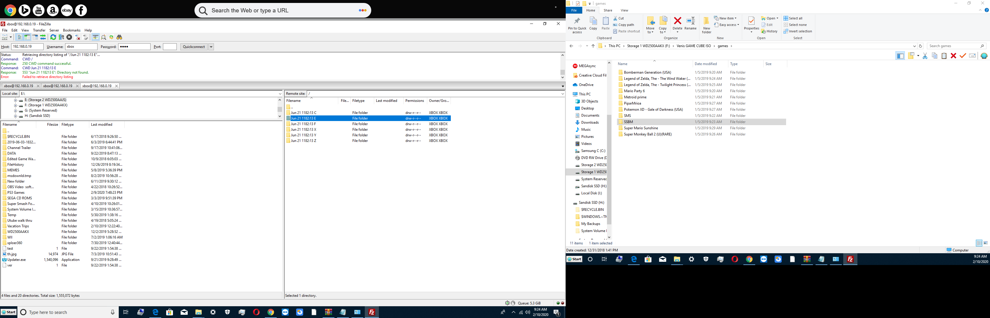

okay, i got into it now. these are the files that come up but it wont let me get into the folders.

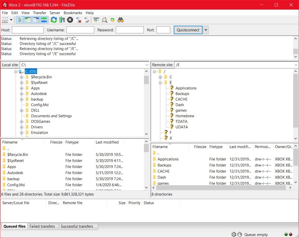

I've seen nothing like that when connecting to any Xbox via FileZilla - usually what comes up are the list of Xbox drives/letter ID ie. C, E, F, G, .....X, Y, Z. Typically like this:-
There's something weird though because you'd expect with a first time connection to get that list of Xbox directories in the Remote site pane and the same under Filename in a pane below that. Why that is not there and what those dated folders are......................no idea. Hope somebody recognises them. A X-DSL (Damn Small Linux) set up perhaps? Never seen one so a pure guess.

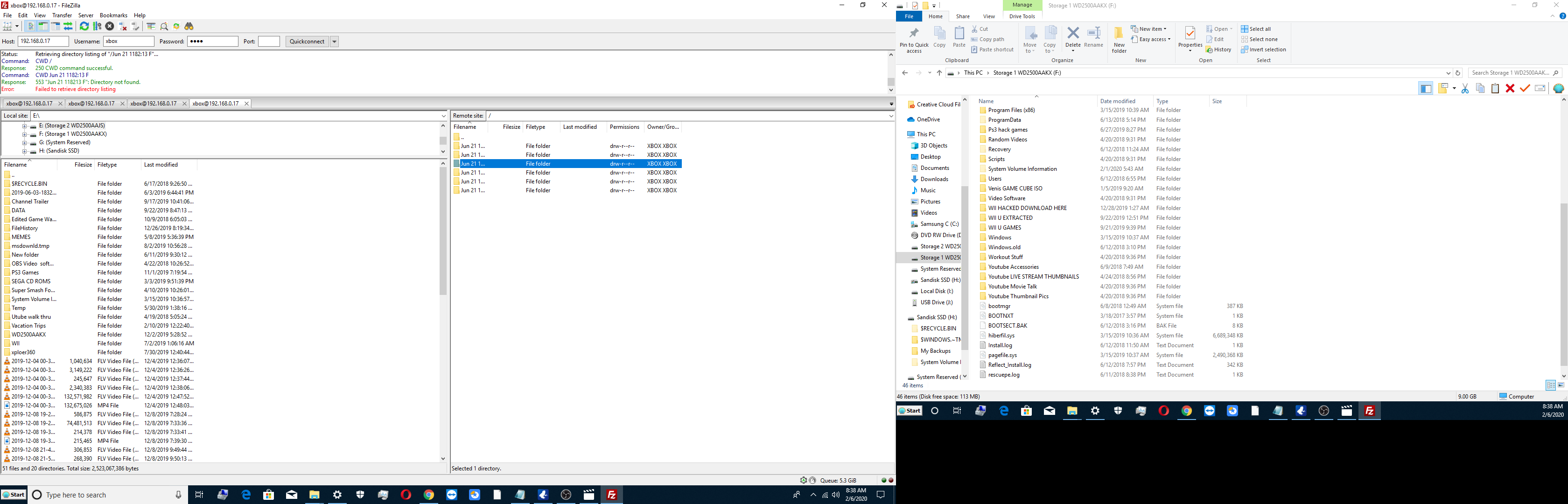

It connects with the weird Date Folders, I screenshoted above. It's Really strange.
Somebody must recognise this set up and whats going on.
What drive are you looking at on the Remote site/Xbox?

I'm looking at the Date Folders. Their is no drives displayed on it for some reason
Right, your Filename column is not wide enough to show the complete name.  Widen it like you do in other Windows applications.

I'm able to see the letters but i get the same exact message as before so widen the columns will not work. I tried all the Drives and it doesnt like it for some reason. Same Message as before.
Again, it's a bug in the UnleashX FTP server of v0.39.0528A Build 584. Widening the column only shows you the entire content of it.  It doesn't fix the bug.
You have to either replace the UnleashX dashboard with an older version Please login or register to see this link. or Rocky5's hex edit patched version of Please login or register to see this link. .  Only the default.xbe file of your UnleashX dashboard install has to be replaced.  You can find where the UnleashX dashboard is running from in the System Info page - press the (Y) button when at a menu to display it. (Please login or register to see this link. )
Or, you can manually enter /c/, /e/, etc. in the Remote Site: box above the Xbox directory listing to enter a drive partition/letter on the Xbox to browse its content.  Once inside a drive, double clicking on a folder works to enter that folder.  However, once you back up to the top-level with the garbage date / drive list, you again have to key-in the path to enter a different drive letter.
