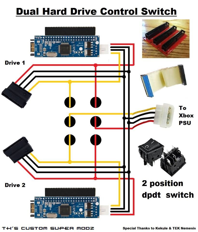

Thank you, I'd appreciate it. I don't understand why he doesn't want to delete the old Bios and install the new one. My goal is to exclude the DVD to be able to insert a second hard drive, not touching anything, but just unplugging the yellow power cable of the dvd.
I dont think what you are planning is as simple as you expect. In fact im pretty sure of it, save yourself the bother and get a 2tb. Using 2 hdd's needs some form of switch to be wired in as the xbox will only ever recognize one at a time regardless of what bios you use.

to have 2 hdd I read somewhere that just insert a bios hack that disables the boot dvd (flash m8 hexen 2019, ind bios, etc), and a switch to switch the primary power supply.
my interest is obviously to use only one hdd at a time.

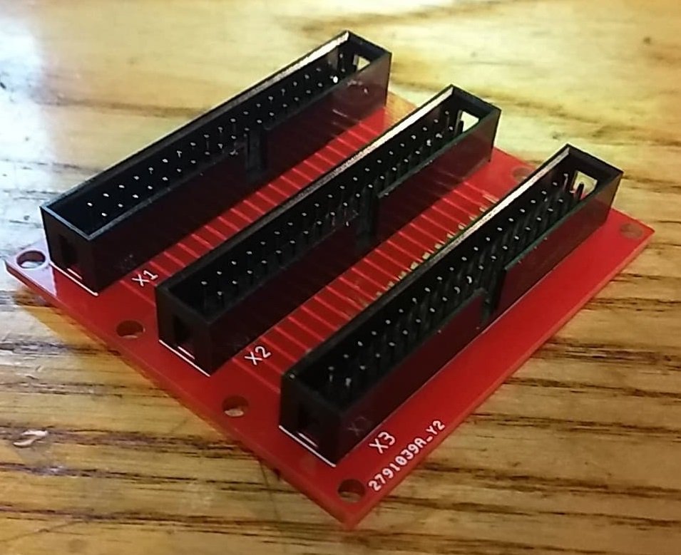

On 12/11/2019 at 1:18 PM, SS_Dave said:
Please login or register to see this attachment. Please login or register to see this attachment.
Where does one purchase the red PCB shown above?
Yes yes, the chip works well. When installing a new hdd I had put the bios m8-137fc via dvd xwizard 3.1. But now with both xwizard and hexen it freezes already at the beginning of the flash
Contact Tony he is posting some pic's and saying he should have some for sale just in the new year.
