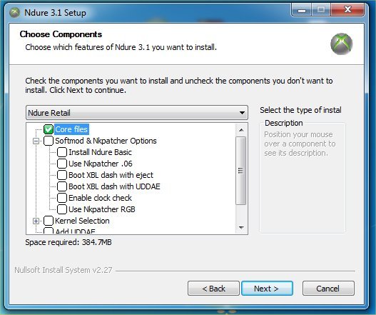

I have another Xbox that I softmodded years ago with ndure 3.1 and xboxhdm 1.9  I think, where it will boot UnleashX with the small button and boot the MS dash with the DVD eject button, but I don't remember what settings to use in ndure.
Which boxes should I check in ndure?

Don’t know the first about Ndure, but just looking over the shot you’ve provided it sounds like you want “Boot XBL dash with Eject”
If you’re soft nodding anyway you may prefer just to upgrade to Rocky5 which has dual boot settings you can customize and access from within the Xbox itself.
