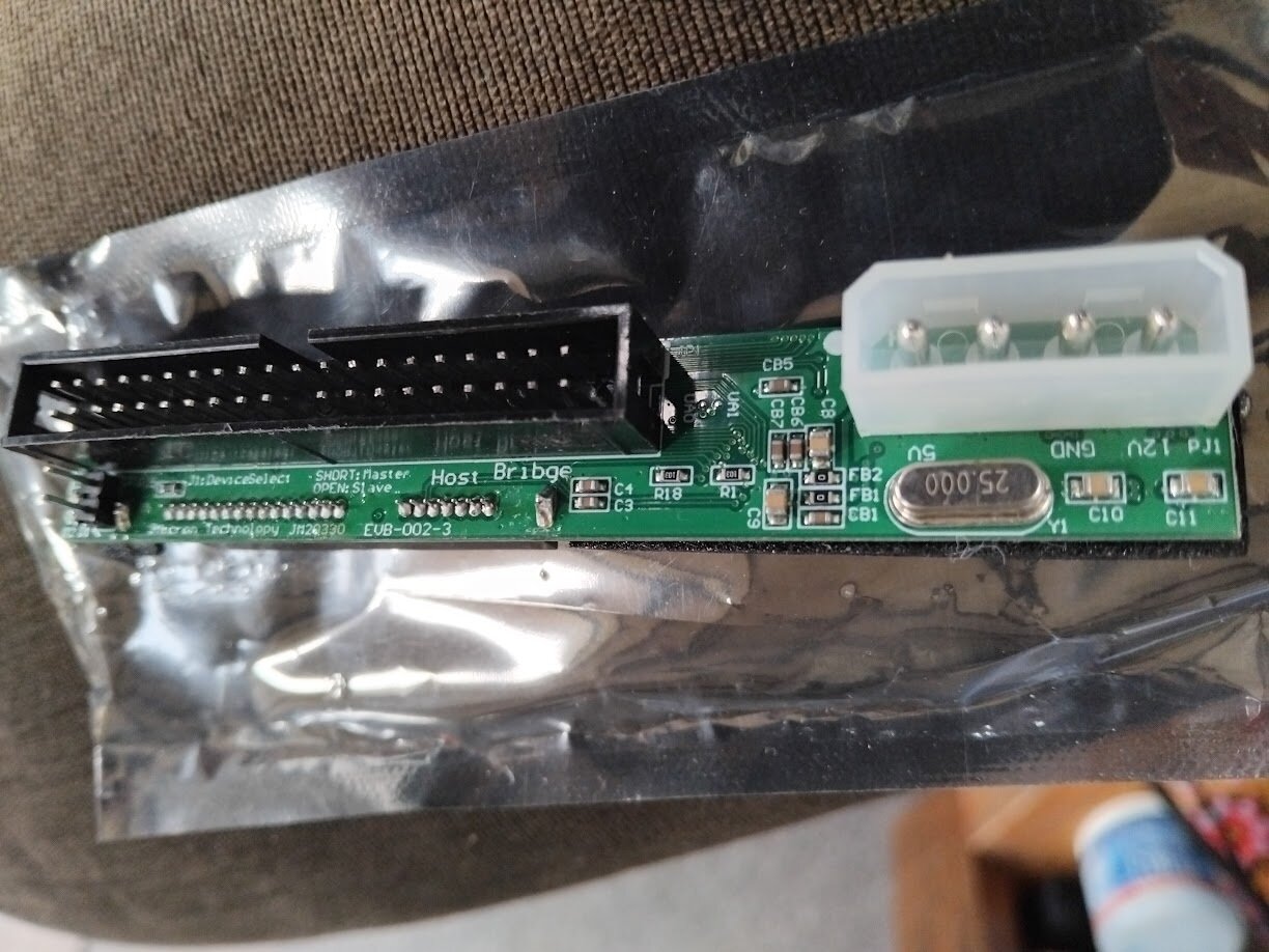

This is the adapters I'm currently using, they're Jmicron JM20330 branded and seem to work fine, had them for years with no issues in all my Xboxes.

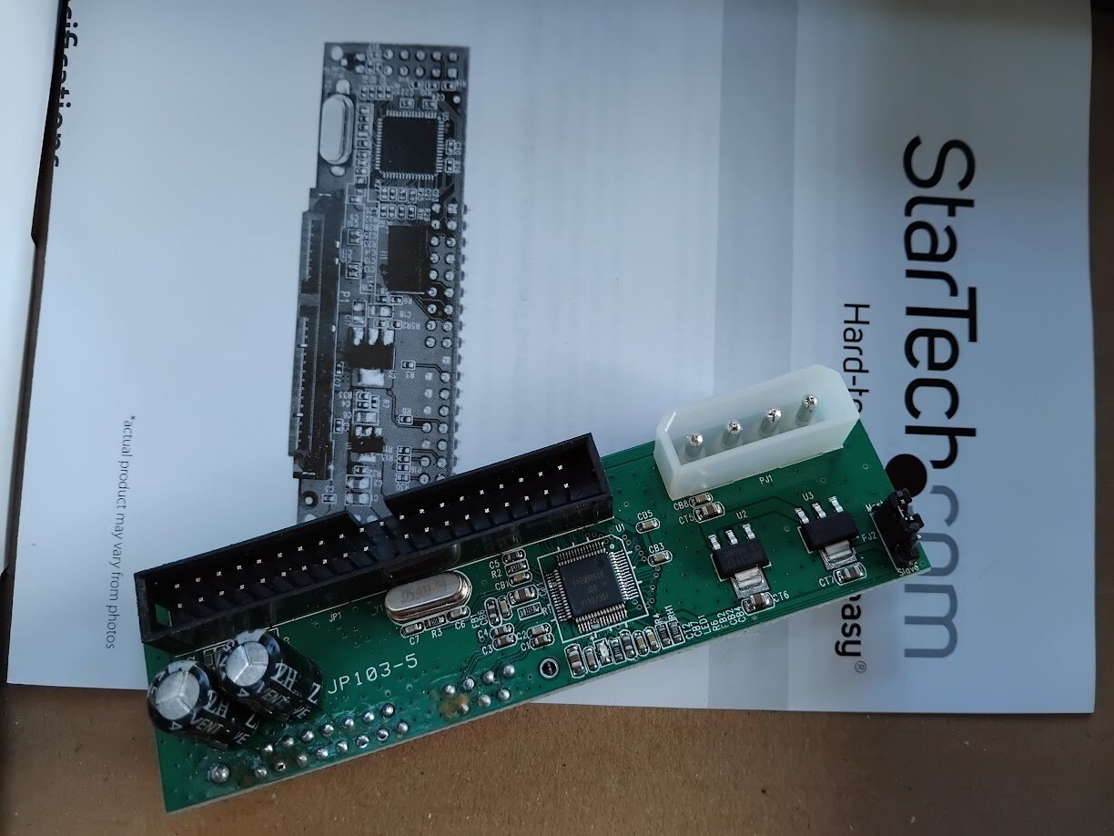

Well, my Startech adapters arrived today so I fitted them to my two favourite Xenium Ice X-boxes to replace the Chinese adapters I had in there, and I discovered unlike my other X-boxes that I've been tinkering with these two Xenium ones had a different Sata adapter to the one I pictured above that were in my other Xboxes.
These two had these ones.
They were working perfectly fine in UDMA 4 on Cerbios, I never pushed it above that.  The new Startech ones are in now so I flashed up to UDMA5 and although I can't really tell any performance difference in booting or or loading Xbox games, I am sure there must be something, what I have noticed since putting on Cerbios and changing Sata adapters is CoinOps R8 starts up so much faster and loads games faster too which is handy as that's probably the most used thing on my Xboxes.
Dude that soldering is BAD. No wonder so many are DOA. What are they using to solder? Chinese paste and an AIR FRYER!?
BTW, you can use UDMA-6 no problem with the Startech. I use it with all my consoles. :)
haha yes, I hadn't paid attention to the solder, but when you look at it, it's shocking, I should fix it up.
I'll give UDMA-6 a shot, so far lovin' my Cerbios Xboxes.
I used to buy these adapters in batches of 10 or more at a time for 2 reasons, one to get the price down a bit and two because there would always be some that were DOA. I would say that if I bought 10 I could almost guarantee that at least 3 were dead.  Getting the price down allowed me to take those dead ones on the chin and basically made the working ones cost the original price again :)
On the generics, I think 4 is normal and 5 is pushing it, but can be done with "the resistor". 6... I dunno man. I haven't seen it happen yet.
Now I just use Startechs in my consoles. Dont mod for selling anymore.
Well, did you see if the DOAs were fixable with reflowing all the soldering?
I've now upgraded to UDMA 6
This is of course on my two Xenium's with the startech adpaters in them, working a treat.  I'll try UDMA6 on the Chinese adapters next, see how I go.  I've not gone past UDMA4 on them so far.
Nice fast loading times now.
Nah, I would just bin them tbh. I might have one or two knocking around in my spares boxes that I might look at one day If I need another adapter :)
Definitely! Try it! I wanna see how many out of the DOAs can be revived simply by reflowing. A before pic would be great, as well. :)
