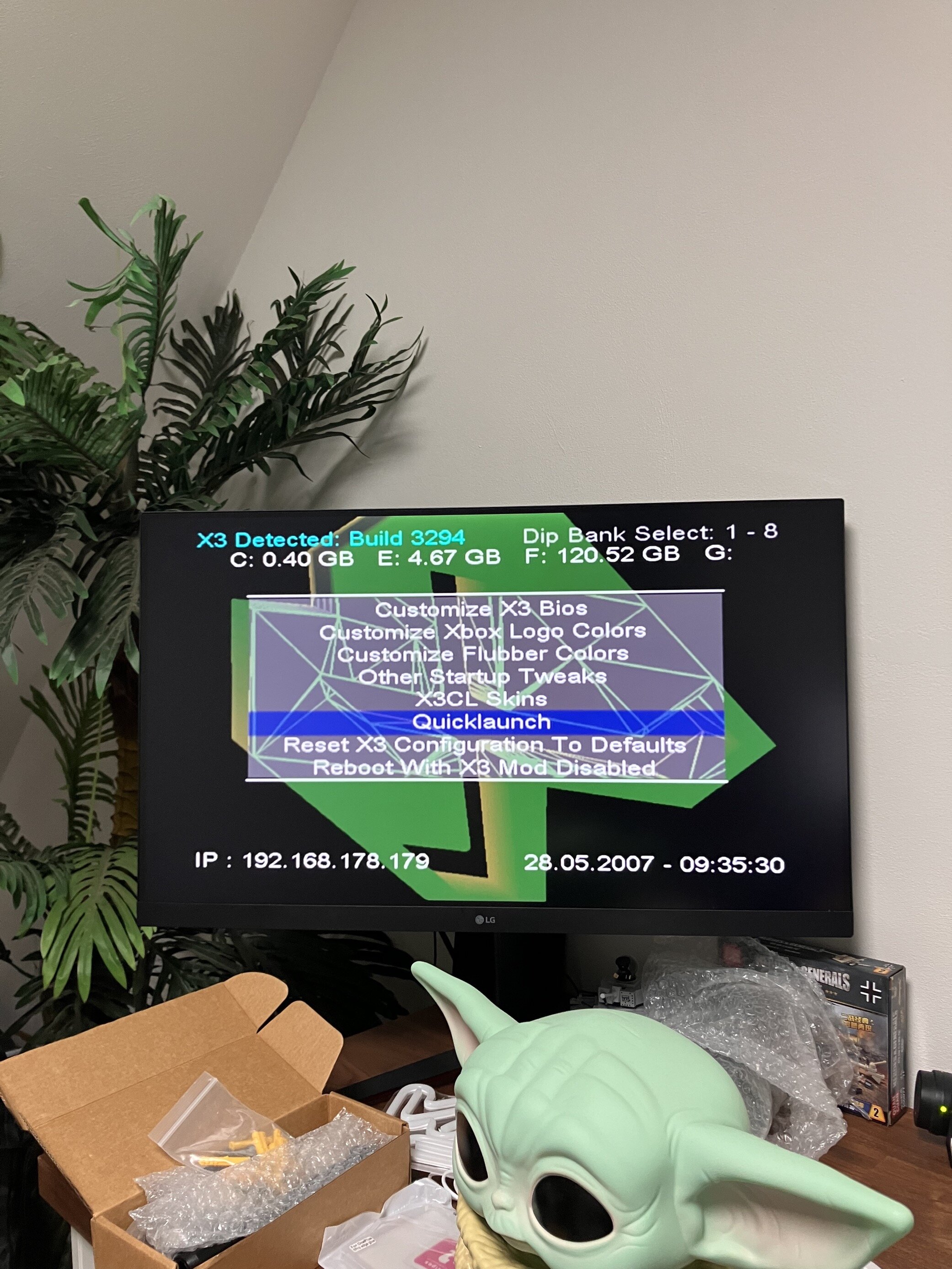

A3 Printer Posted January 26, 2024 Report Share Posted January 26, 2024 Hi There, I just happened to come across an Xbox with an xecuter 3 mod chip with LCD on a second hand website. Bought this and continues to work. So now it still has the standard hard drive in it. I wanted to replace this with a hard drive that is in my other hardmodded Xbox. (This is the well-known Origin 2TB disc) When I put this in, it does not boot any further and I end up on the X3 modschip screen. When I FTP to the original hard drive I find it strange that it uses the C D E. Furthermore, I think this is one of the first Xectuer 3 mod chips because it also contains a very old version of XBMC. Any idea what I will be able to do? Quote Link to comment Share on other sites More sharing options...

nikeymikey Posted January 26, 2024 Report Share Posted January 26, 2024 The chip is fine, I have an X3 and it works as well today as it always did. Update the bios, or, if you have a bios bank switch mounted on the console use that and try one of the other banks, it may have another bios on it already. For the Origins drive to work you might need a bios that supports F and G. Although If you are booting the X3 bios then you "should" be good to go there anyway, the X3 bios will support your 2TB hdd with F and G partitions. One thing you need to check is where the X3 is looking for the dashboard at boot, you can check this on the X3 config screen. You can get to that by holding the "White" button while powering on the console. Look for dashboard path or similar. Make sure the path is pointing to where the dash is installed on the origins drive. Try the dash option first and if you still have issues then try updating the bios. The UDMA stuff is not important unless you are using Cerbios so do worry about that too much. Just make sure you are using an 80 wire IDE cable with your Sata drive and you should be good. Quote Link to comment Share on other sites More sharing options...

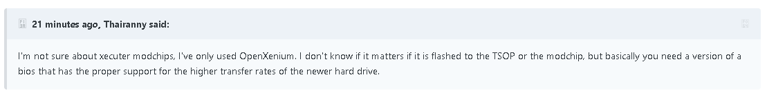

nikeymikey Posted January 26, 2024 Report Share Posted January 26, 2024 8 minutes ago, Thairanny said: I'm not sure about xecuter modchips, I've only used OpenXenium. I don't know if it matters if it is flashed to the TSOP or the modchip, but basically you need a version of a bios that has the proper support for the higher transfer rates of the newer hard drive. No, the X3 bios will support his 2tb drive with no issues. I know becasue i have an X3 with 2tb drive that runs on the X3 bios. The UDMA thing has only come about since Cerbios added it and it honestly isnt that important. As long as OP is using an 80 wire cable along with his ide2sata adaptor then the X3 bios will be enough for the 2tb drive to work. Quote Link to comment Share on other sites More sharing options...

nikeymikey Posted January 26, 2024 Report Share Posted January 26, 2024 7 minutes ago, A3 Printer said: NikeyMikey When i use the original hdd i can see and chose the Dashboard. When i use my 2TB Disc i can not see anything. Thairanny, i did not used the 80 pin cable. i did not no there was a difference is will check that out. You will need that 80wire cable. You need to make sure that the X3 is looking in the right place for the Origins dash. On the original drive it is in a specific location, on the Origins drive it is likely in a different location, the chip/bios needs to know where it is so it can boot it. As I said before check where the dash is located on the origins hdd and point the X3 bios at it. Then it should boot. I have never used the Origins drive so dont know the dash location myself. Here is a link to the manual for the X3 config Live, pay attention to the sections about the dash and make sure that yours is setup to boot the dash from where it is on the Origins drive. https://x3.bustedchain.com/x3configlive.html 1 Quote Link to comment Share on other sites More sharing options...

KaosEngineer Posted January 26, 2024 Report Share Posted January 26, 2024 5 hours ago, A3 Printer said: Hi There, I just happened to come across an Xbox with an xecuter 3 mod chip with LCD on a second hand website. Bought this and continues to work. So now it still has the standard hard drive in it. I wanted to replace this with a hard drive that is in my other hardmodded Xbox. (This is the well-known Origin 2TB disc) When I put this in, it does not boot any further and I end up on the X3 modschip screen. When I FTP to the original hard drive I find it strange that it uses the C D E. Furthermore, I think this is one of the first Xectuer 3 mod chips because it also contains a very old version of XBMC. Any idea what I will be able to do? With the X3 BIOS and a 2TB hard drive, you must Enable the Use Saved Partition Table option in the BIOS's configuration settings. X3 Config Live Menu Options Disk Tools > New Hard Drive Upgrade > Use Save Partition Table = Enabled/Disabled (Press A to toggle the value.) Press B to back out of the submenu items. Next, verify that the replacement dashboard's XBE file is in the boot order list to be loaded on startup. X3 Config Live Main Menu > Customize X3 BIOS > Dashboard Filenames and Dashboard Boot Drive = <Xbox Drive Letter where located>. IIRC, the X3 BIOS does not look in subfolders for the listed Dashboard Filenames. It only looks in the set boot drive's top-level/root directory. 1 Quote Link to comment Share on other sites More sharing options...
KaosEngineer Posted January 26, 2024 Report Share Posted January 26, 2024 2 minutes ago, KaosEngineer said: Furthermore, I think this is one of the first Xectuer 3 mod chips because it also contains a very old version of XBMC. Any idea what I will be able to do? The X3 BIOS does not contain a replacement dashboard. If you get it to run an old version of XBMC, it is installed on the hard drive. Missing F and G partitions is caused by not having the Use Saved Partition Table set to Enabled. 1 Quote Link to comment Share on other sites More sharing options...

A3 Printer Posted January 29, 2024 Author Report Share Posted January 29, 2024 Dear All, I would like to thank you very much for your responses. We have now succeeded by changing the IDE cable to an 80. And Use Saved Partition Table. Everthing is working now. 7 Quote Link to comment Share on other sites More sharing options...
