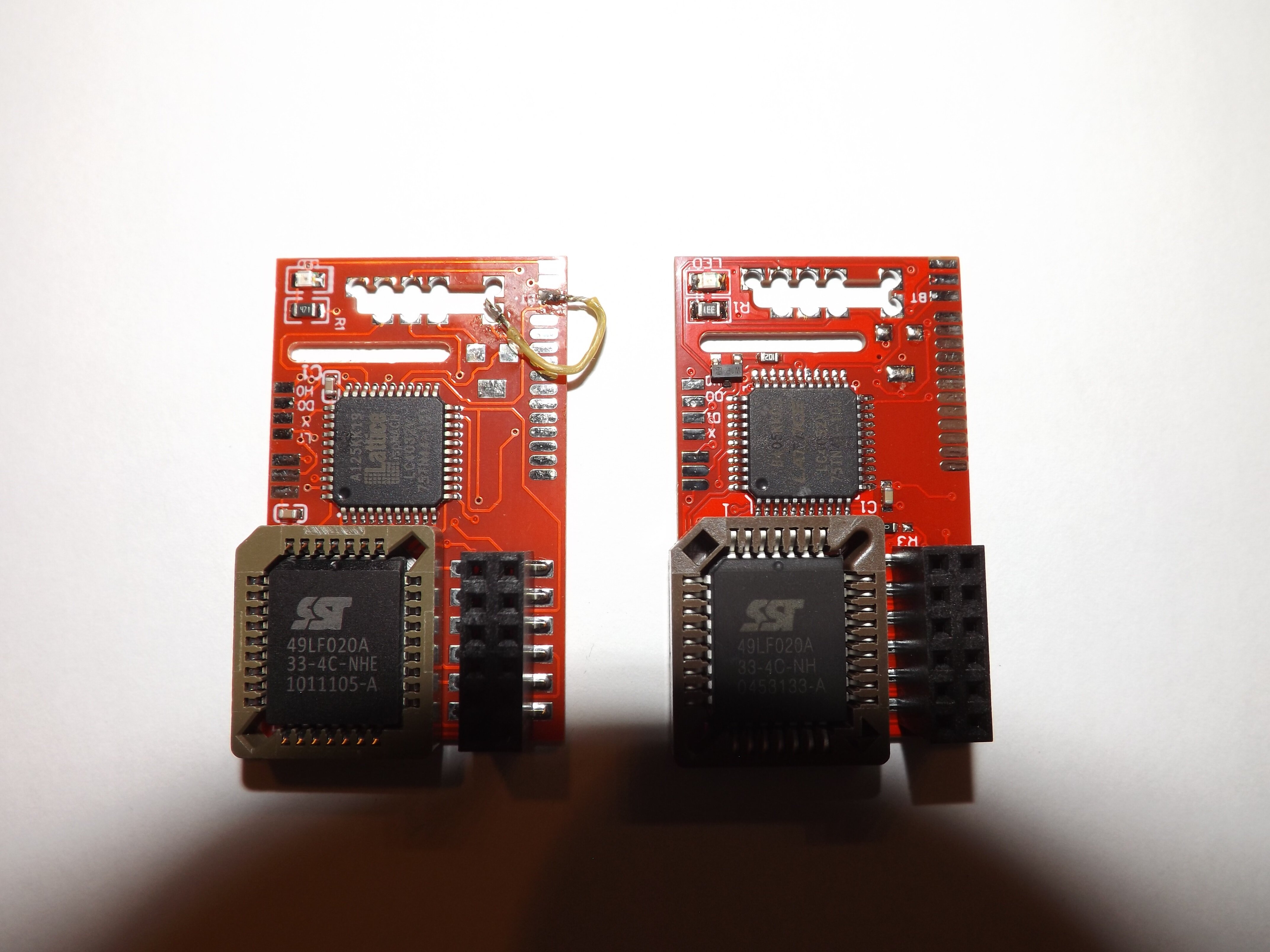

Aero_105 Posted November 27 Report Share Posted November 27 On 11/20/2023 at 10:14 PM, sweetdarkdestiny said: Please post a good pic of the Aladdin you have so that I can see where the traces lead. You can make a backup of the lattice first and in case something goes wrong with the new CPLD code you can probably just flash it back. Just got the transistor Aladdin modchip. Both are clones the one on the right is the transistor one. I was hoping for the one on the left. Quote Link to comment Share on other sites More sharing options...

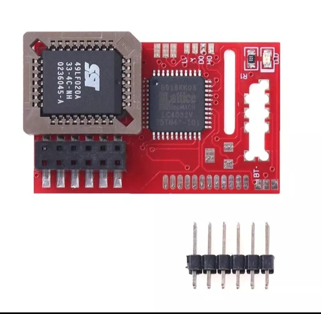

MadMartigan Posted November 28 Report Share Posted November 28 (edited) I found a seller with this type on AliExpress. They are all able to be flashed directly from the xbox. No extra diodes, resistors, or transistors on the boards as you can see. The others I've had, like the ones above, I had to remove all of the chips to flash on the pc. Edit: Here is another thread on this. I'll say it again, "This needs to be, a pinned thread". Edited November 28 by MadMartigan 1 Quote Link to comment Share on other sites More sharing options...
Bowlsnapper Posted November 28 Report Share Posted November 28 2 hours ago, MadMartigan said: I found a seller with this type on AliExpress. They are all able to be flashed directly from the xbox. No extra diodes, resistors, or transistors on the boards as you can see. The others I've had, like the ones above, I had to remove all of the chips to flash on the pc. Edit: Here is another thread on this. I'll say it again, "This needs to be, a pinned thread". I believe these are the ones I got and flashed. Quote Link to comment Share on other sites More sharing options...
RMM Posted November 29 Report Share Posted November 29 On 11/27/2023 at 8:51 PM, MadMartigan said: I found a seller with this type on AliExpress. They are all able to be flashed directly from the xbox. No extra diodes, resistors, or transistors on the boards as you can see. The others I've had, like the ones above, I had to remove all of the chips to flash on the pc. Edit: Here is another thread on this. I'll say it again, "This needs to be, a pinned thread". So which seller on AliExpress is selling the Aladdin modchips that can be flashed directly from the Xbox? That information would be more helpful than pinning a topic where no one knows which Aladdin modchip can be flashed. I dont think that other thread has much clarity on which Aladdin to buy because some work with printed text, some dont. Some work with the extra diodes, resistors, transistors while some dont. Pinning a topic like that doesnt seem helpful because it still doesnt answer the question of which Aladdin to buy. A better solution would be to find a source who is selling Aladdins that work and let everyone know. That way you support someone who is selling good Aladdin modchips vs someone who is not. Of course there is no guarantee the person selling the good Aladdins doesnt start selling the bad ones at some point. Quote Link to comment Share on other sites More sharing options...
Bowlsnapper Posted November 29 Report Share Posted November 29 7 minutes ago, RMM said: So which seller on AliExpress is selling the Aladdin modchips that can be flashed directly from the Xbox? That information would be more helpful than pinning a topic where no one knows which Aladdin modchip can be flashed. I dont think that other thread has much clarity on which Aladdin to buy because some work with printed text, some dont. Some work with the extra diodes, resistors, transistors while some dont. Pinning a topic like that doesnt seem helpful because it still doesnt answer the question of which Aladdin to buy. A better solution would be to find a source who is selling Aladdins that work and let everyone know. That way you support someone who is selling good Aladdin modchips vs someone who is not. Of course there is no guarantee the person selling the good Aladdins doesnt start selling the bad ones at some point. These are the chips I upgraded to XBlasts: https://www.aliexpress.com/item/3256802425688094.html?spm=a2g0o.order_list.order_list_main.34.62cc194dUzSMn2 These are the SST 1MB flash chips I used and flashed with XBlast OS: https://www.aliexpress.com/item/3256803469514647.html?spm=a2g0o.order_list.order_list_main.22.62cc194dUzSMn2 @Aero_105 Edit: Sorry, that was not the question. I thought I was responding to another topic because I'm retarded. Apologies. Quote Link to comment Share on other sites More sharing options...
MadMartigan Posted November 29 Report Share Posted November 29 (edited) 16 minutes ago, RMM said: So which seller on AliExpress is selling the Aladdin modchips that can be flashed directly from the Xbox? That information would be more helpful than pinning a topic where no one knows which Aladdin modchip can be flashed. I dont think that other thread has much clarity on which Aladdin to buy because some work with printed text, some dont. Some work with the extra diodes, resistors, transistors while some dont. Pinning a topic like that doesnt seem helpful because it still doesnt answer the question of which Aladdin to buy. A better solution would be to find a source who is selling Aladdins that work and let everyone know. That way you support someone who is selling good Aladdin modchips vs someone who is not. Of course there is no guarantee the person selling the good Aladdins doesnt start selling the bad ones at some point. https://a.aliexpress.com/_mqFF24q I ordered several from this seller. Edit: I have provided that link in several threads already. It's easy to narrow down by searching this topic and reading. Try not to be rude and passive aggressive please. It also does in fact tell which particular model to buy. Read carefully Edited November 29 by MadMartigan Quote Link to comment Share on other sites More sharing options...
