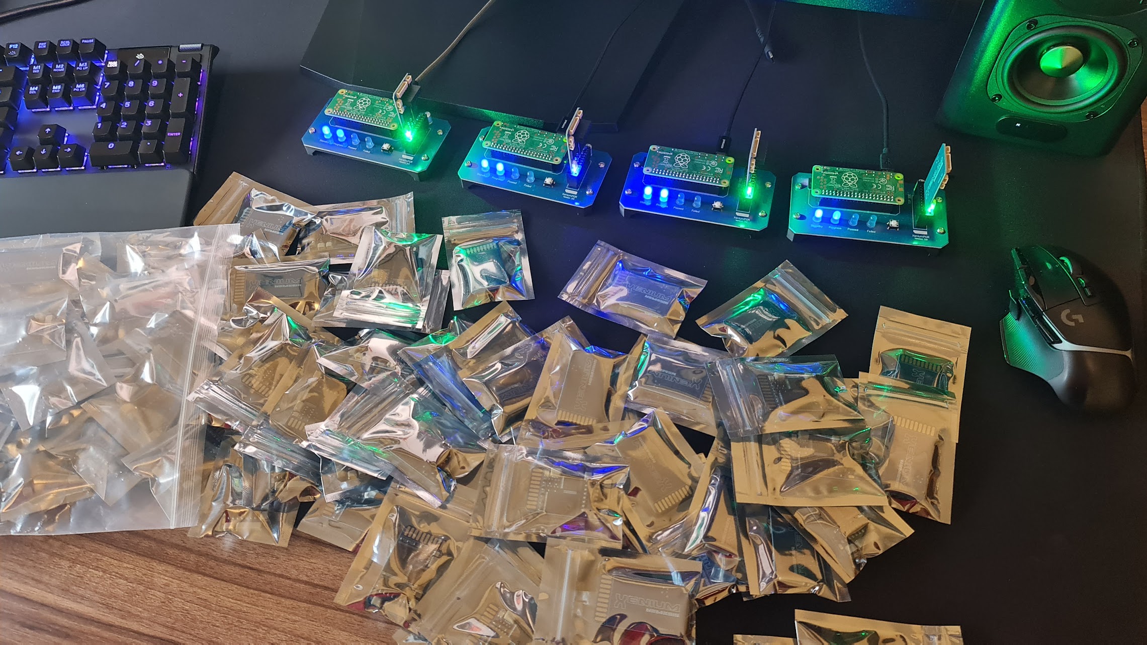

XeniumICE Programmer:
I had a lot of fun working on the python script for the "XeniumPGR".
Above is a quick video demonstrating what I've done with it.
Firstly, the script takes care of the button and all the LEDs since
it was never fully implemented in the "Xenium-Programmer" code.
The video starts with the RPi zero powered up with the script running.
"Power" LED is now "Standby" LED to show when the script is ready.
I start by showing the long press function for rebooting the RPi,
to signal this the LED's cycle from left to right. Once the RPi boots up
and the script is ready it will signal this
by cycling the LEDs from right to left.
I demonstrate that the modchip will only power up when plugged into
the programmer in the correct orientation. Short pressing the button
can start or stop running the flashing command "./xenium-programmer"
The progress LED turns on whenever the flashing command is running.
Getting the "passed" and "failed" LEDs to function as intended was difficult.
I had to monitor the output of xenium-programmer for "ERROR" and "FAILED".
If either of these two strings would appear it would be deemed as a "Fail".
However, if the command completed without failing it would be deemed a "Pass"

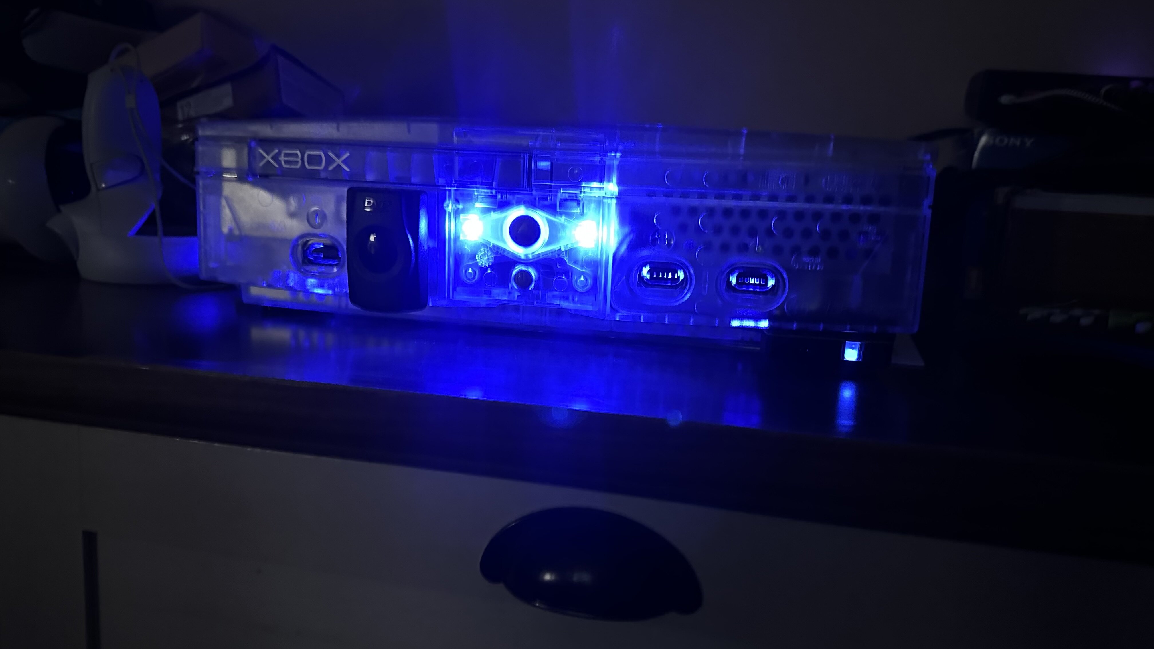

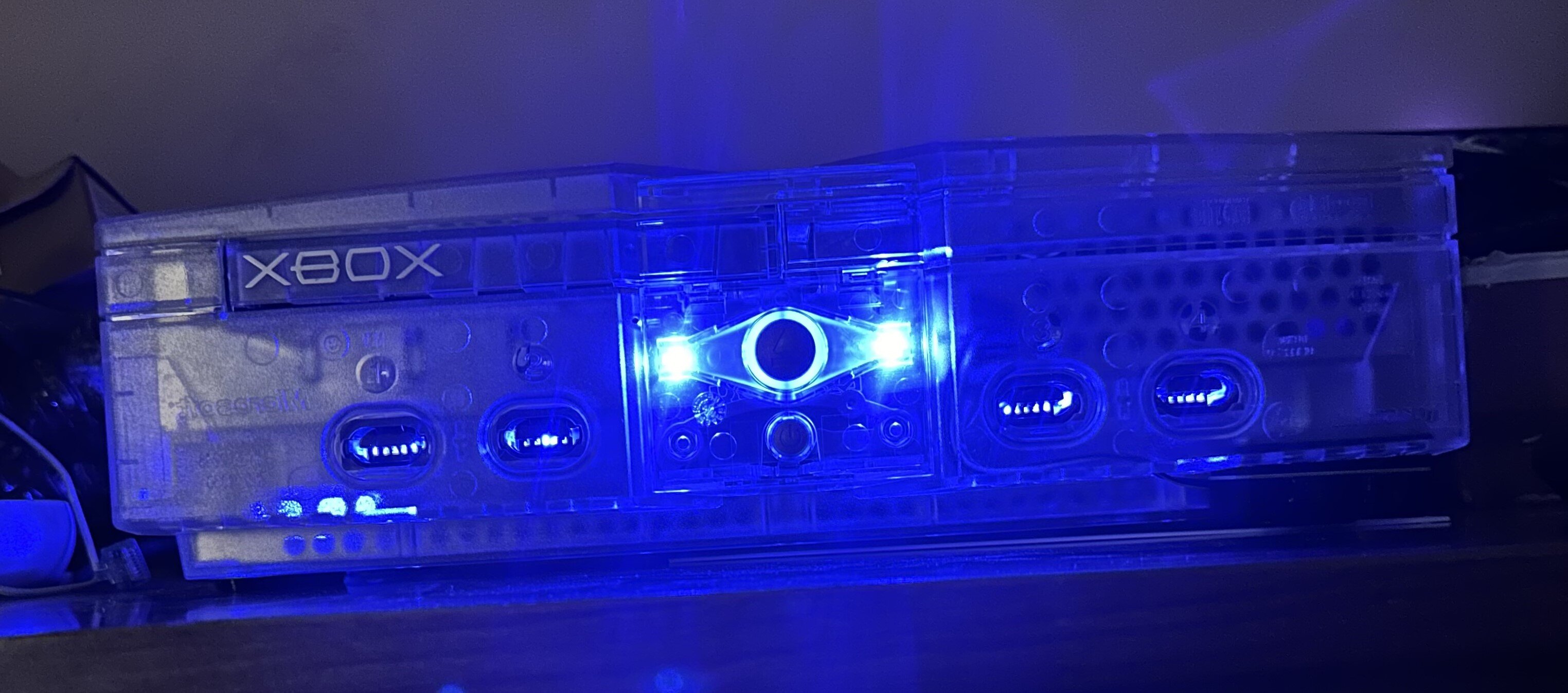

Installed my @NeMesiS supplied XeniumICE Massive kit a few days ago, after some self inflicted confusion with the cable from the chip to the Massive Hub everything is now up and running perfectly. Chip has latest PrometheOS flashed to it and the console now looks like this...
RGB lighting colours are selectable in PrometheOS. You can just make out the 3d printed housing for the Xerc sensor and status LED which seems to react to me pointing my iPhone camera at it lol......
The kit is super well made and easy to install. (Just be sure to use the correct supplied cables ;D) would recommend the XeniumICE chip and the massive kit 100%.
