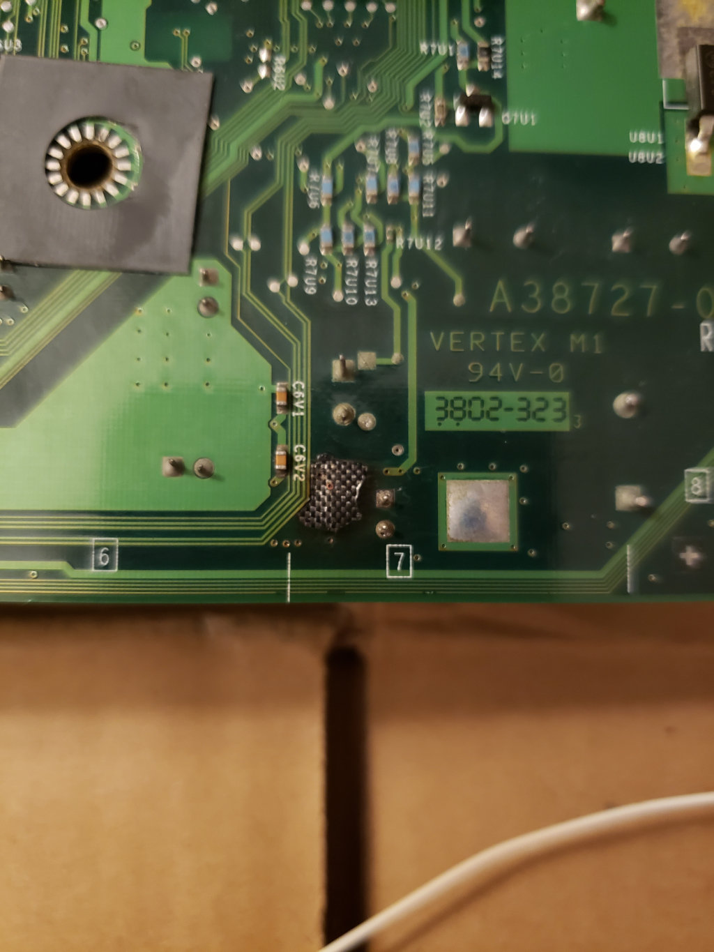

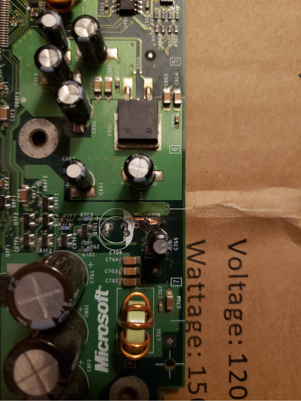

A few months back a got my first OG Xbox, but the DVD drive was broken. I ended up buying a second Xbox for parts with a working drive and swapped them out (I ended up getting lucky, it was a Samsung drive). So a couple days ago I pulled out my spare Xbox and found the only problem with it was the power button not turning the console on/off. The console would power on when plugged in, which looking into this online told me its a common problem. So I ended borrowing the working drive and softmodding it. Everything was going perfectly until I was playing some snes9x and the console was smoking! Turns out the clock capicitor was leaking on the motherboard and melting. I knew about the clock capicitor issues, but stupid me thought I'd just do it later. So I cleaned up the mess and removed the capicitor, but it left some irreversible damage. Now the console will boot up and work fine for 5 minutes before suddenly turning off. I inspected the motherboard and noticed it had some corrosion on the "A Line" (Source: https://www.google.com/url?sa=t&source=web&rct=j&url=https://www.ogxbox.com/forums/index.php%3F/topic/29-how-to-fix-trace-corrosion/&ved=2ahUKEwjl4szT1bn7AhXbjokEHQddBoEQFnoECA4QAQ&usg=AOvVaw1PMDAuq47ME_GX_0VJ58Ll). I'm not sure if the clock capicitor melt down has something to do with this new issue (most likely do does) or if the corrosion has gotten worse from the whole incident. I'm posting pictures below. I think the best method moving forward would be to try and solder in a wire workaround (From source above). I need some advice, whats the best move moving forward? I want to save this Xbox if I can.

Thanks!! I'm still not 100% certain on all the details, but I have a better idea on how to approach this. Is there a video tutorial you could refer me too? The only bit of motherboard that has the tracks (The exposed metal that acts as an internal wire right?) exposed is the circle area a little ways down from the capacitor. there was originally a surface mount component bridging a small connection, but it turned to a crisp and snaped off. Now that it's gone the two aren't touching anymore I don't think. You can see it better in the original photo I posted. My best guess is that this has something to do with the random shutting off of the system. The power button had problems before, and I'm almost certain it's from motherboard corrosion but that's a much simpler fix, and doesn't harm game play at all. I'm not sure what you mean by popping traces and toasting earth planes, could you explain this a bit further? I'm a bit new to Xbox repair.
