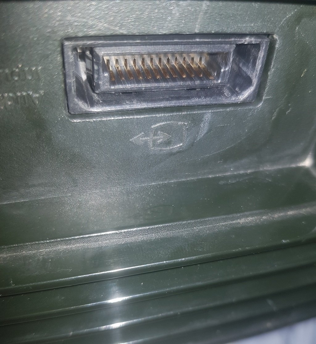

spellforce7 Posted September 20, 2022 Report Share Posted September 20, 2022 Hi, i got a sound problem which one of my xbox but only on the left speaker. it sound like the left speaker is broken, i tried headphones too but same problem. i tried my second xbox on the same TV with same component and composite cable and it was all right. can some please help me with this. i can change the capacitor if that is the problem but i do not know which capacitor is for sound. Quote Link to comment Share on other sites More sharing options...
KaosEngineer Posted September 20, 2022 Report Share Posted September 20, 2022 Make sure the pin inside the AVIP connector on the back of the console is not damaged or corroded - pin 3. Quote Link to comment Share on other sites More sharing options...
spellforce7 Posted September 22, 2022 Author Report Share Posted September 22, 2022 thanks for the reply. i checked the pin on the xbox and it was little dark so i cleaned it with isopropyl alcohol and cleaned the black dirt but the problem still remains. Quote Link to comment Share on other sites More sharing options...
KaosEngineer Posted September 22, 2022 Report Share Posted September 22, 2022 31 minutes ago, spellforce7 said: thanks for the reply. i checked the pin on the xbox and it was little dark so i cleaned it with isopropyl alcohol and cleaned the black dirt but the problem still remains. How do all the other pins look? Especially pin 5 the left audio ground signal line. Quote Link to comment Share on other sites More sharing options...
spellforce7 Posted September 22, 2022 Author Report Share Posted September 22, 2022 i took some pictures of the pins Quote Link to comment Share on other sites More sharing options...
