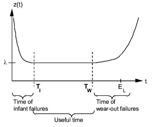

most have been destroyed by clock cap leak after 10 years, 20% hard disks fail after 4 years and dvd drive dying after 5 years. (all depending on use)
electronics failure rate chart (source)
notice a lot of failures at release, a period of reliability, increasing failures end of life from wear out. I would say based on the failure stats above we are already at the end of that chart...except we're still finding fully working unopened OG's which is rare and amazing. (mostly v1.6)
for an accurate answer to OP's question we would need more stats to work out how far along the chart timeline and survey what the current second hand market is like for OG's
