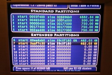

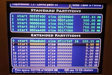

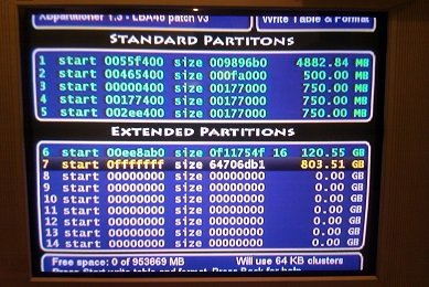

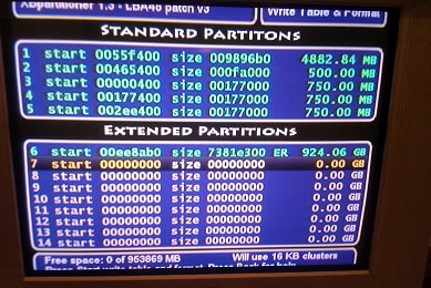

Aero_105 Posted July 23, 2022 Report Share Posted July 23, 2022 (edited) I did a recent xbox original upgrade v 1.6 with aladdin xt plus 2 mod chip from aliexpress, ide to sata adapter with 80 wire ide cable and finally a seagate 1 tb hdd. I did an format on the hdd with ogxbox 2021 installation disc. Through the process I selected format F drive with remaining space and skipped the G drive. I checked xbpartitioner v 1.3 and found an ER code beside the 924 GB. My options are in xbpartitioner v 1.3 without ER code are #1. 120 GB for F only #2. 120 GB for F only and 803 for G only. I selected option #2. Would I run into problems down the road if I left the hdd with 924 GB with ER code? I thought the modchip came with M8plus_16.bin with 06 where partition F take remaining space? Does the partitions F and G under games merge on the same screen when selecting from menu? Does the partitions given in xbpartitioner v 1.3 depend on the type of bios and type of hdd? Edited July 23, 2022 by Aero_105 Quote Link to comment Share on other sites More sharing options...
KaosEngineer Posted July 24, 2022 Report Share Posted July 24, 2022 21 hours ago, Aero_105 said: I did a recent xbox original upgrade v 1.6 with aladdin xt plus 2 mod chip from aliexpress, ide to sata adapter with 80 wire ide cable and finally a seagate 1 tb hdd. I did an format on the hdd with ogxbox 2021 installation disc. Through the process I selected format F drive with remaining space and skipped the G drive. I checked xbpartitioner v 1.3 and found an ER code beside the 924 GB. My options are in xbpartitioner v 1.3 without ER code are #1. 120 GB for F only #2. 120 GB for F only and 803 for G only. I selected option #2. Would I run into problems down the road if I left the hdd with 924 GB with ER code? I thought the modchip came with M8plus_16.bin with 06 where partition F take remaining space? Does the partitions F and G under games merge on the same screen when selecting from menu? Does the partitions given in xbpartitioner v 1.3 depend on the type of bios and type of hdd? The options with ER should work after you execute the command Write Table & Format with XBPartitioner v1.3. It is just showing that the current cluster size of that partition - most likely 16KBs - is in err. UnleashX only supports formatting the extended partitions with 16KB clusters. You have to use XBPartitioner v1.3 (edit: to reformat the extended partition(s) to fix the cluster size to the one actually required to support the size of the associated extended partition). 16KB clusters support a partition size up to 256GBs 32KB clusters - >256GBs to 512GBs 64KB clusters - >512GBs to 1,024GBs If the wrong cluster size is in use once more than the cluster size's supported max. size of data is written to the partition, files will be corrupted on that extended partition. 1 1 Quote Link to comment Share on other sites More sharing options...

Aero_105 Posted July 24, 2022 Author Report Share Posted July 24, 2022 I could not use Write Table & Format with XBPartitioner v1.3 to 924 GB initially. When I write table and format to 06 being 120 GB and 07 being 803 GB then switched back to formatting a second time to 924 GB 64kb clusters then it worked with no ER code. Good to know what UnleashX supports 16kb clusters. Once properly formatted the xbox original now boots faster. Thanks for the help. 1 Quote Link to comment Share on other sites More sharing options...
