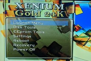

Let's go 1 step at  a time do you mean the Open Xenium background
Like this screen?
Like this screen?
Yes openxenium background.
When you change the backdrop is it the correct size and resolution.
