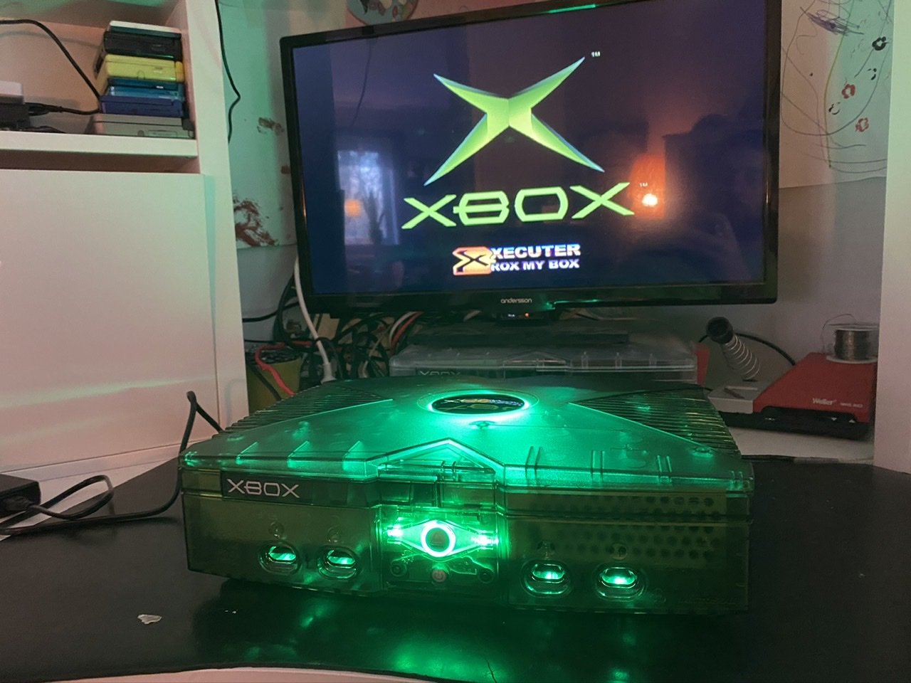

      I have a v1.0 original modded Xbox, it had an old Aladdin mod chip, I wanted to upgrade the hard drive and after doing some research I found out I can brick it by flashing a new bios. The bios is unknown but after running bios checker it reads I have a lpc sst49lf020, it boots up xecuter2 into an evolution x dashboard. If I use the hexen 2019 disc, what steps can I take after I install a larger hdd? I don’t need to clone it, I backed up everything using ftp, and I want a fresh install. Here are some images that may help...
      Thanks for your time.
