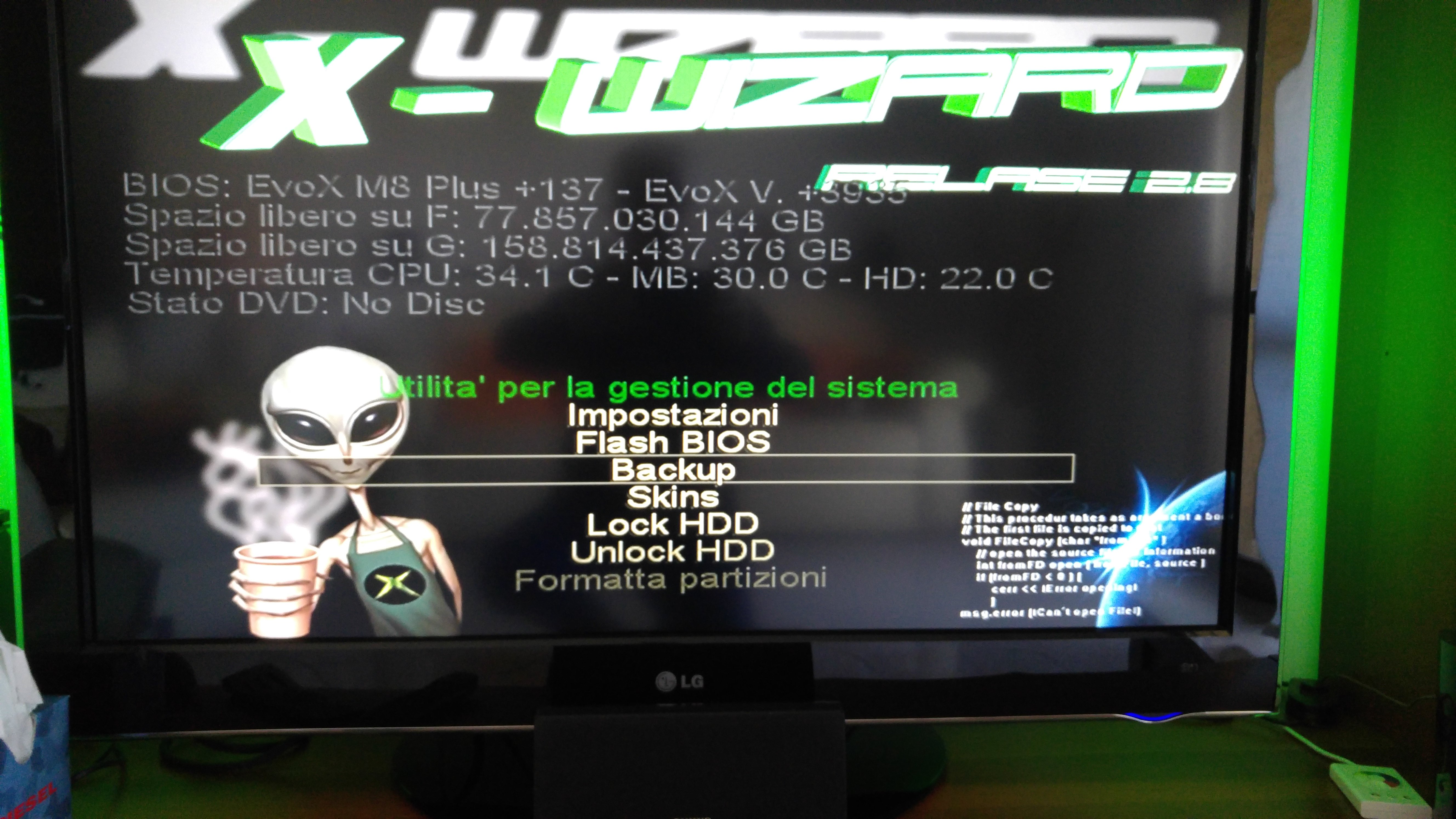

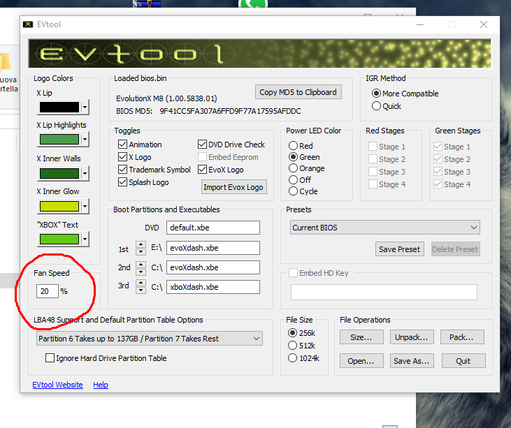

ok, after I made the backup I would like to change it with "evtool 1.0.9" to make the fan run stronger regardless of which dash, game or emulator starts.

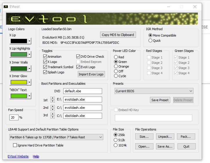

what you see in the picture is my uploaded bios. The fan is set by default to 20%, according to you how much can you set it? I just have to change that value and that's it right? I change the percentage and click on Save as. After reflasho the bios again

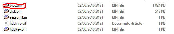

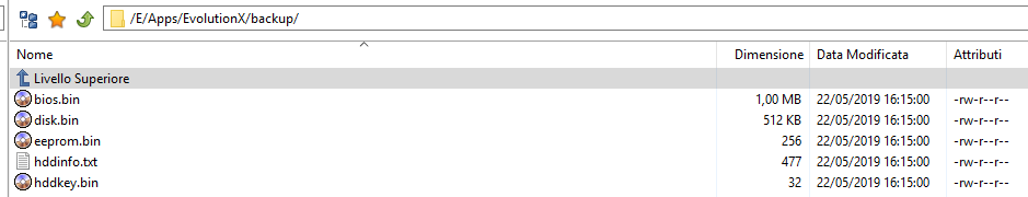

questi sono i file di backup creati con EvoX. Come puoi vedere il file bios.bin ha una dimensione di 1 MB, secondo te dopo aver apportato la modifica della percentuale di velocità della ventola e gli ho detto di salvare, quale taglia dovrei scegliere?

Yes. The Aladdin modchip has a 256KB flash memory chip.  The BIOS size will be 256KB.  The higher you set the fan speed the louder it will be.

so if the bios.bin backup size is also 1 MB, after I make the change I save it with a size of 256K right?

The backup created by Evox dash is 1MB as the original Xbox's flash device is 1MB.  The same BIOS.bin file is repeated 4x in a row.  You can only flash a 256KB bios to your Aladdin modchip.

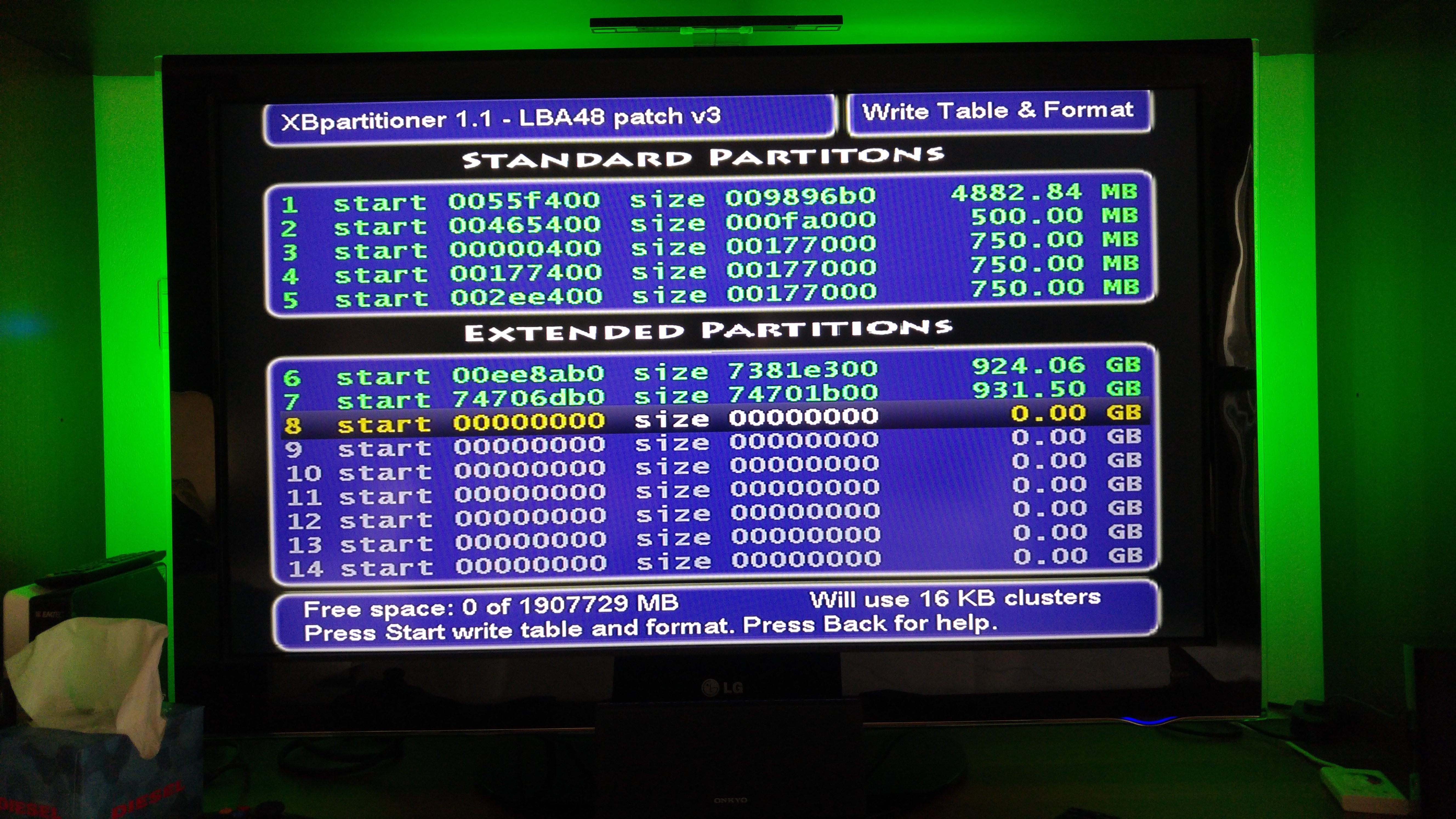

Hmm, what size is your Xbox's hard drive?  What size were the extended partitions?  Did it even have extended partitions? (F and/or G drives)  Does the hard drive have a partition table written to it?
Now I go to work. then I'll take a picture of the situation on my hard disk.
Meanwhile, thanks for the help, see you later

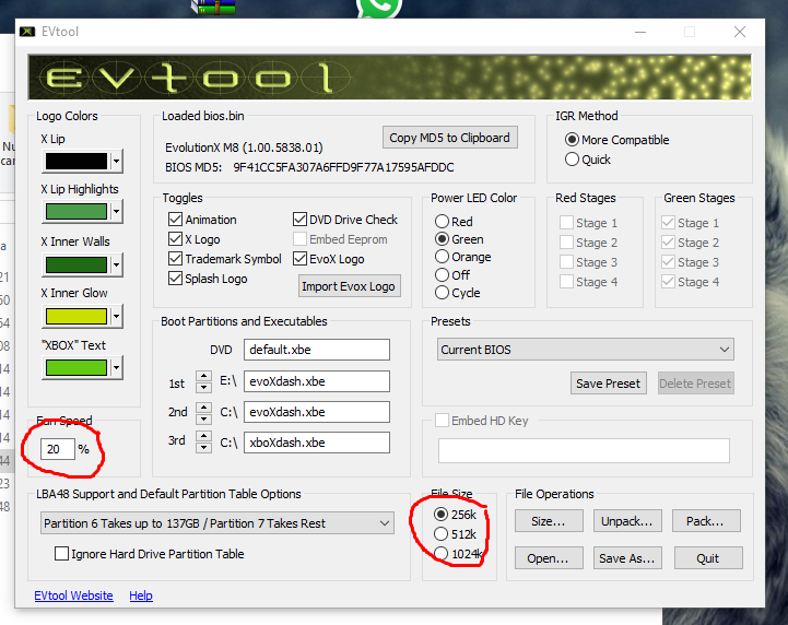

So ultimately I have to do the following steps to change the fan speed and keep it constant:
1) Xbox bios backup via EvoX Dash
4) I change the fan speed from 20% to 100% and verify that the bios saving size is 256k

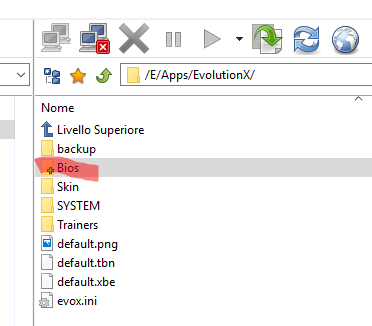

5) once saved the bios modified with evtool via ftp I'm going to put it in the bios folder of the Evolution dash program that is in the zbox
