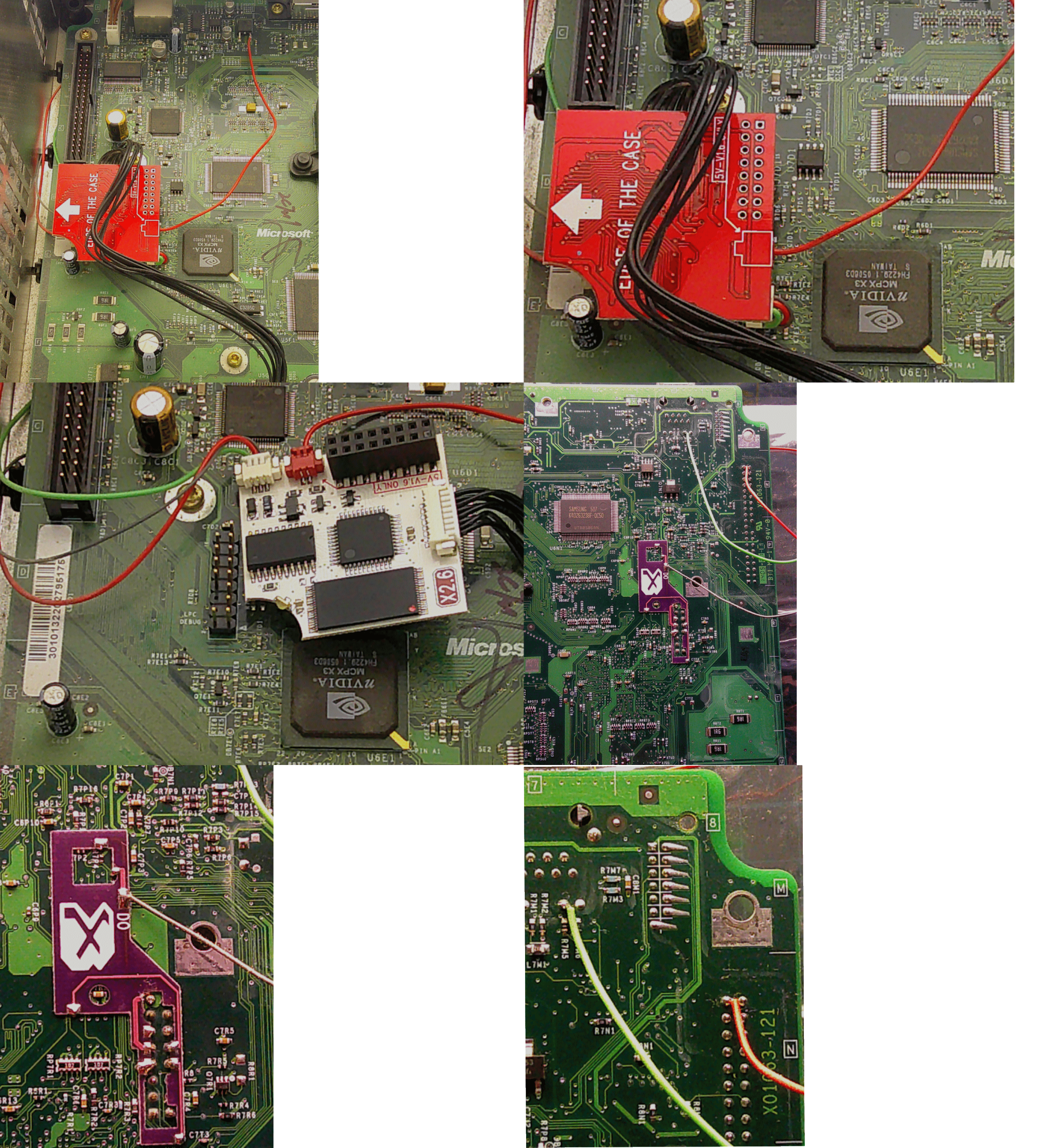

HDShadow Posted January 30, 2024 Author Report Share Posted January 30, 2024 11 hours ago, fox said: I have 2.6ce that did the same thing, then it just croaked. Well that's comforting :(. Photos of chip/MB etc. Apologies for average quality but I do not have a close-up lens for the camera I was using so had to use digital zoom. However I think they show the sort of detail required. I was hoping when I flipped the MB over I'd see an obviously disconnected or loose wire (D0 perhaps) but just like the soldered wire on top of the MB, which I think is the v1.6 5v supply, the soldering on the three wires underneath still look bright and clean with the connections very firm. So whatever the problem is it doesn't seem likely to be a simple loose connection issue. Did a bit of cleaning afterwards and put the whole thing back together just to check it was still functioning as before and...............................the damned thing booted perfectly using the primary bank (Evox logo). I did not want to stress it by trying a reboot or shutdown and restart, I was just glad it was working OK again. However I did take the opportunity to re-backup the eeprom although I have plenty of full backups of it and C:\, E:\ drive content archived, somewhere. Should it fail again similarly I think the best thing would be to get a replacement chip. If I can find an Open Xenium or similar can I just swap in that without having to do any rewiring or are some of the Xecuter 2.6 CE connections (see pics) chip specific? Quote Link to comment Share on other sites More sharing options...

HDShadow Posted January 31, 2024 Author Report Share Posted January 31, 2024 Quote I have kind of the same chip just missing the red connector on the chip. The red one on top of the the MB? As I mentioned in the previous post that's only used with a v1.6 Xbox which needs a separate 5v power supply. If you look at the pic above which shows the underside of the Xecuter 2.6 CE you can see printed on the PCB itself (in red) an arrow and info about that 5v connection being only for v1.6 Xboxes. BTW I found a YT guide where a guy was replacing a Xecuter with an Open Xenium on a v1.6 and he actually removed the Xecuter's LPC board and used the supplied Xenium one which, presumably, includes the additional v1.6 5v connection. Should I need to dump my Xecuter in the future I'd want to avoid having to do that which is why I asked about whether it was possible to use the Xecuter LPC board with the Xenium. That must surely require a separate, wired 5v connection too - is that possible to do with the Xenium? The YT video guy mentioned the Xenium comes with some Kynar wire so I was wondering if that is why it was supplied. Quote Link to comment Share on other sites More sharing options...
Bowlsnapper Posted January 31, 2024 Report Share Posted January 31, 2024 2 hours ago, HDShadow said: The red one on top of the the MB? As I mentioned in the previous post that's only used with a v1.6 Xbox which needs a separate 5v power supply. If you look at the pic above which shows the underside of the Xecuter 2.6 CE you can see printed on the PCB itself (in red) an arrow and info about that 5v connection being only for v1.6 Xboxes. BTW I found a YT guide where a guy was replacing a Xecuter with an Open Xenium on a v1.6 and he actually removed the Xecuter's LPC board and used the supplied Xenium one which, presumably, includes the additional v1.6 5v connection. Should I need to dump my Xecuter in the future I'd want to avoid having to do that which is why I asked about whether it was possible to use the Xecuter LPC board with the Xenium. That must surely require a separate, wired 5v connection too - is that possible to do with the Xenium? The YT video guy mentioned the Xenium comes with some Kynar wire so I was wondering if that is why it was supplied. When it comes to the LPC, sometimes people can damage their board trying to remove it. I have personally almost always just dropped in a 2X2 pin header next to the 2X6. Quick, easy, functional. However, I DO make sure that the 2x6 is already nice and flat and that the 2x2 section has pins that match in direction, otherwise there CAN be alignment issues. But usually it's totally fine. 1 Quote Link to comment Share on other sites More sharing options...
HDShadow Posted February 8, 2024 Author Report Share Posted February 8, 2024 I'm a little confused now as to what the green and red wires under the MB are there for. Likewise the D0 wire which I thought the LPC rebuild board meant it was not required with a v1.6. The YT videos I've seen show an Aladdin chip installed on a v1.6 with an LPC rebuild board working without any additional wiring that I could see. Quote Link to comment Share on other sites More sharing options...
Bowlsnapper Posted February 8, 2024 Report Share Posted February 8, 2024 1 hour ago, HDShadow said: I'm a little confused now as to what the green and red wires under the MB are there for. Likewise the D0 wire which I thought the LPC rebuild board meant it was not required with a v1.6. The YT videos I've seen show an Aladdin chip installed on a v1.6 with an LPC rebuild board working without any additional wiring that I could see. Based on their placement, I would say that those are leads for LAN and HDD activity LEDs, as well as D0. This is exactly the same cable on the X3 that you see the results of on the Control Panel (including D0). I wonder why this bundle is present on the X2.6, though. Never noticed it before. Where would the LED output be? Can anybody help me with this? @HDShadow D0 is still required, although it is referred to as "Lframe" on the 1.6. Little different, but still serves the same function. There is no reason why you can't swap with an OX chip. 1 Quote Link to comment Share on other sites More sharing options...
HDShadow Posted February 9, 2024 Author Report Share Posted February 9, 2024 (edited) Good to know. I was just wondering what extra wiring I might need. As I understand it the top of MB red wire going to the transistor leg is for a 5v supply to power the chip on LED. I don't know if the Black Ice chip I've just bought (still in transit) even has an LED but I assume it does. So that wire will have to have the plug removed and be re-soldered somewhere. I'm also not certain what to do about the Xecuter 2.6 CE's switch array. It's super-glued in place so it has to stay. The Bank select and Write Protect switches will be redundant (?) but it might be useful to be able to switch the chip On/Off and, although less important, just the chip LED. Both are catered for in the Xecuter's switch array but can it be adapted to make those functions work with the Black Ice? Anyone know how? Edited February 9, 2024 by HDShadow Quote Link to comment Share on other sites More sharing options...
