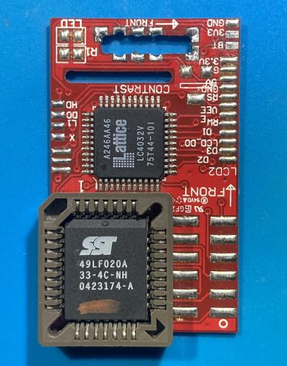

ModzvilleUSA Posted September 19 Report Share Posted September 19 I have what appears to be a legit Aladdin XT 4032 here. The silkscreen on the right seems to suggest that this supports wiring up an LCD. The 4064 revision also seems to have potentiometer for dialing in the brightness. Those pads still exist on modern aladdin clones but there's no traces there. Does anyone have any experience with wiring up an lcd to one of these or know of any documentation? I plan to tinker with it this week. Quote Link to comment Share on other sites More sharing options...
Bowlsnapper Posted September 19 Report Share Posted September 19 7 hours ago, ModzvilleUSA said: I have what appears to be a legit Aladdin XT 4032 here. The silkscreen on the right seems to suggest that this supports wiring up an LCD. The 4064 revision also seems to have potentiometer for dialing in the brightness. Those pads still exist on modern aladdin clones but there's no traces there. Does anyone have any experience with wiring up an lcd to one of these or know of any documentation? I plan to tinker with it this week. Looks like there's a brightness/backlighting pot right next to those contacts also. (oh, you said that) I would say yes, but I don't know if I've ever seen an LCD hooked up to an Aladdin in my life. Stuff like this is all I could find. Quote Link to comment Share on other sites More sharing options...
sweetdarkdestiny Posted September 19 Report Share Posted September 19 Not possible. The one with LCD support use a LC4064. So even you add the pot nothing will happen. And if you use Ryzee's AladdinLCD (which will work if you mod the chip slightly (See he pic of a mod I made using a XenoFX which is the original (All aladdins are clones)) you lose the bios function (So you would need a TSOP flash). 1 Quote Link to comment Share on other sites More sharing options...
Bowlsnapper Posted September 19 Report Share Posted September 19 7 hours ago, sweetdarkdestiny said: Not possible. The one with LCD support use a LC4064. So even you add the pot nothing will happen. And if you use Ryzee's AladdinLCD (which will work if you mod the chip slightly (See he pic of a mod I made using a XenoFX which is the original (All aladdins are clones)) you lose the bios function (So you would need a TSOP flash). That's what I read, is that both devices have to occupy the bus, since the LCD device becomes unusable as a flash device. I guess the CPLD is tied up with LCD duties. Quote Link to comment Share on other sites More sharing options...
ModzvilleUSA Posted September 19 Author Report Share Posted September 19 Thanks for the insight! I was aware of ryzee's project which could be neat in a 1.0 or 1.1 split tsop build. if anyone has an Old 4064 aladdin they want to sell let me know, I think it's neat these had native lcd support for a brief moment. Did the xenoFX have a revision that added the lcd support? The pads are all there and labeled on yours. The aladdin pcb I have here looks like an exact clone of your xenofx. Quote Link to comment Share on other sites More sharing options...
sweetdarkdestiny Posted September 19 Report Share Posted September 19 The Aladdin chips are clones of the XenoFX chips. And yes, there is also a version of the XenoFX with LC4064 chip on it called AXT Xenochip Pro. The one showed in the pic above the AXT32 Xenochip lite 2 Quote Link to comment Share on other sites More sharing options...
