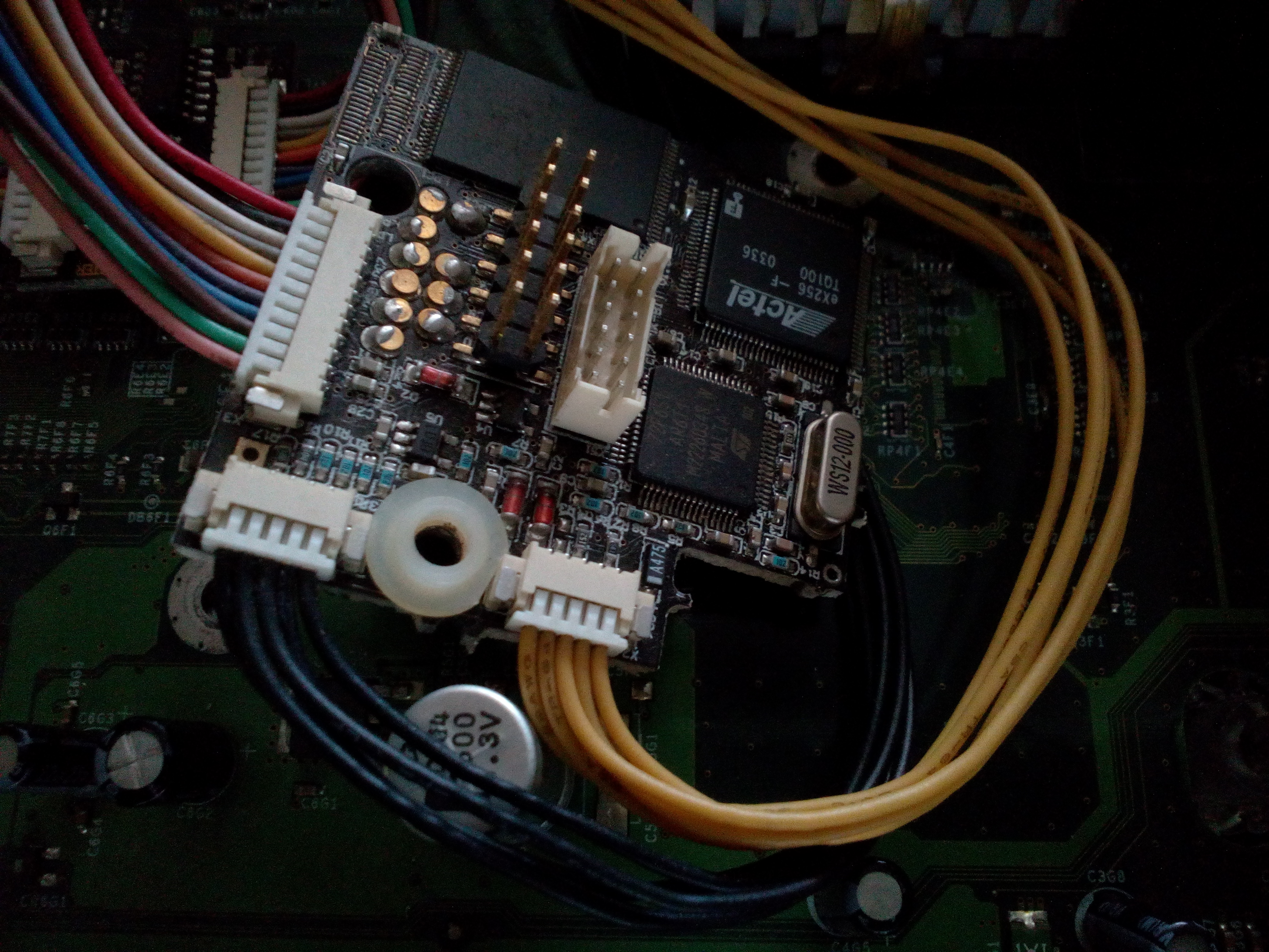

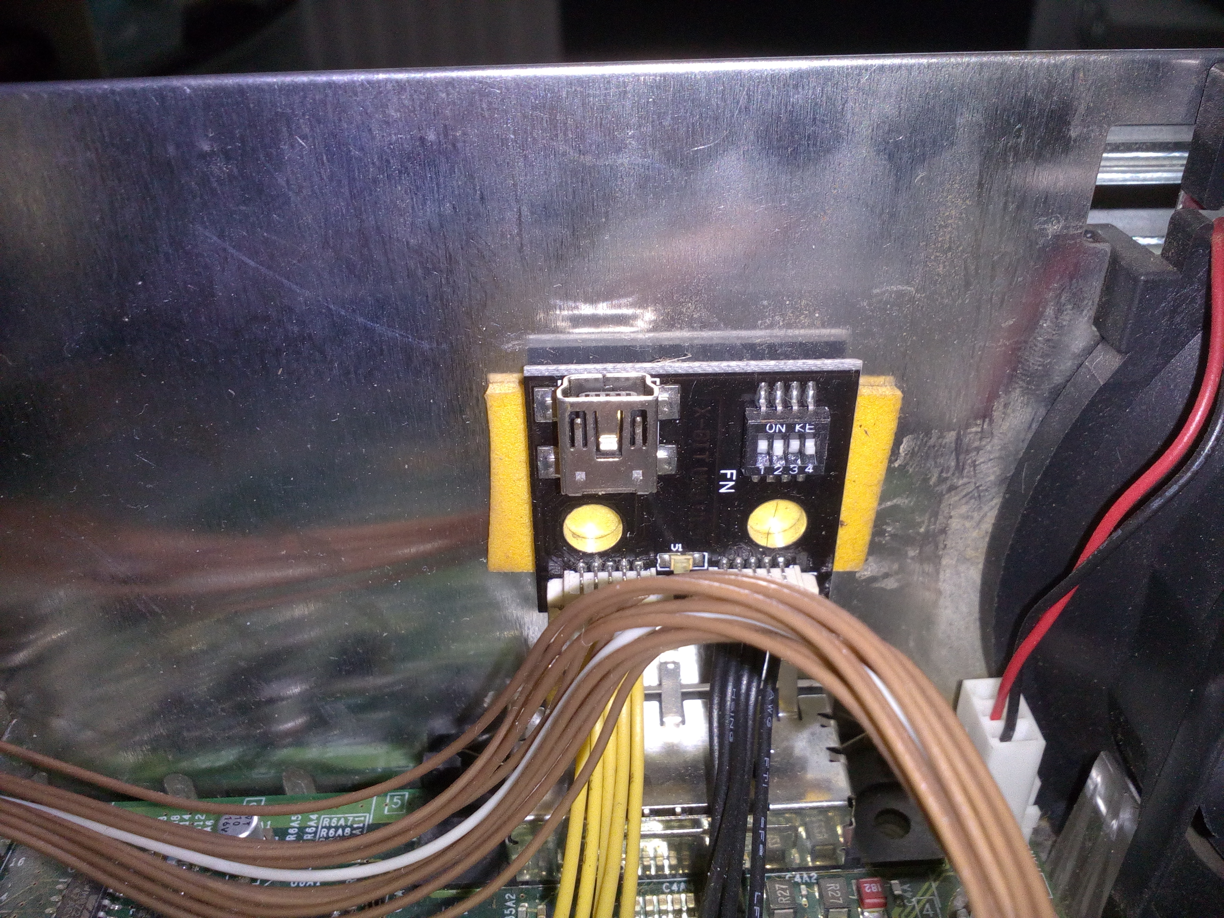

Crystal Xbox Xbit 1.5
xbox boots 3 times no image or audio

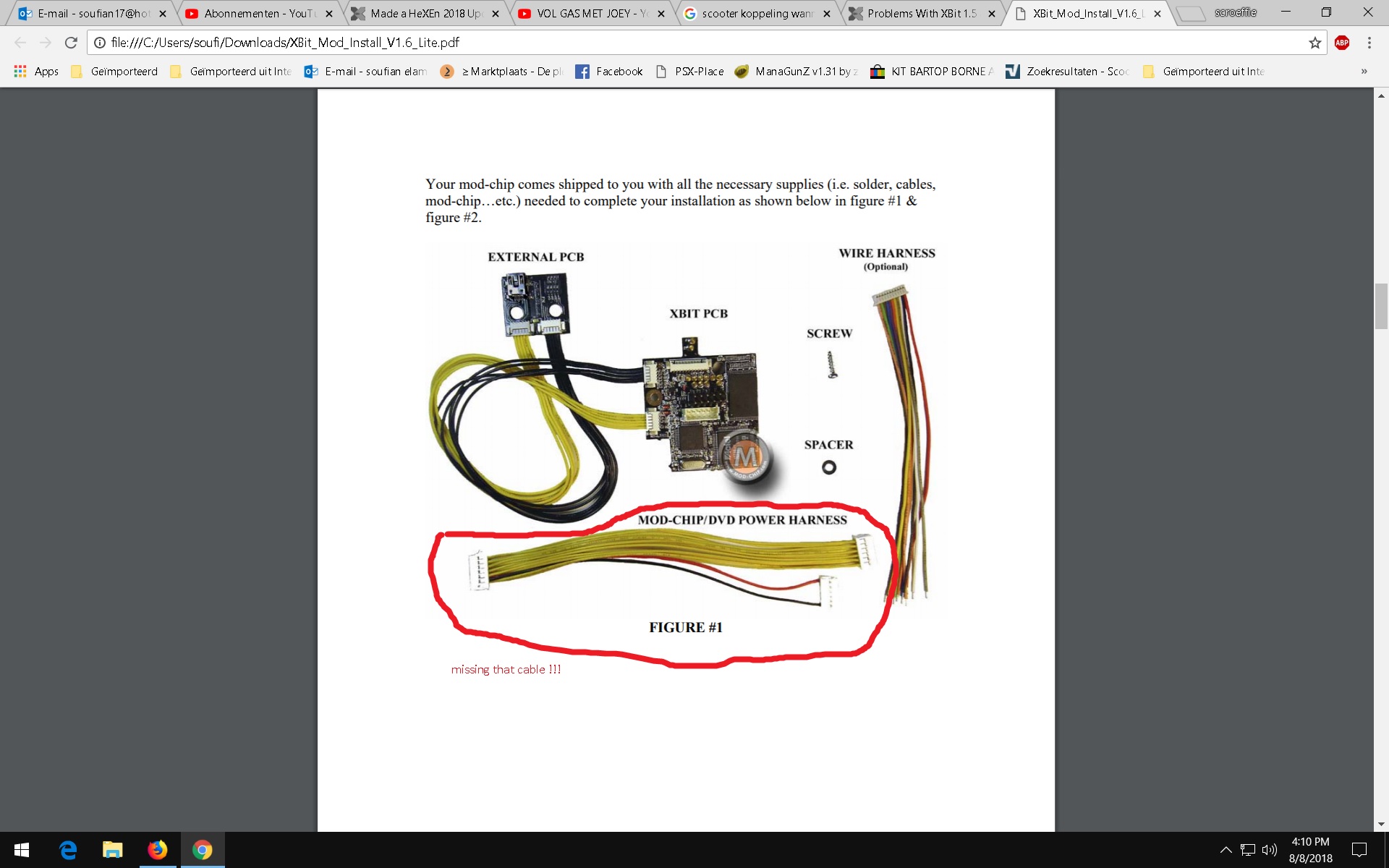

i found this xbox the way it is i think its missing a cable to activate the chip !
maybe someone knows where i can buy the cable if not its  up for sale shipping outside europe is expensive
has 120gb hdd

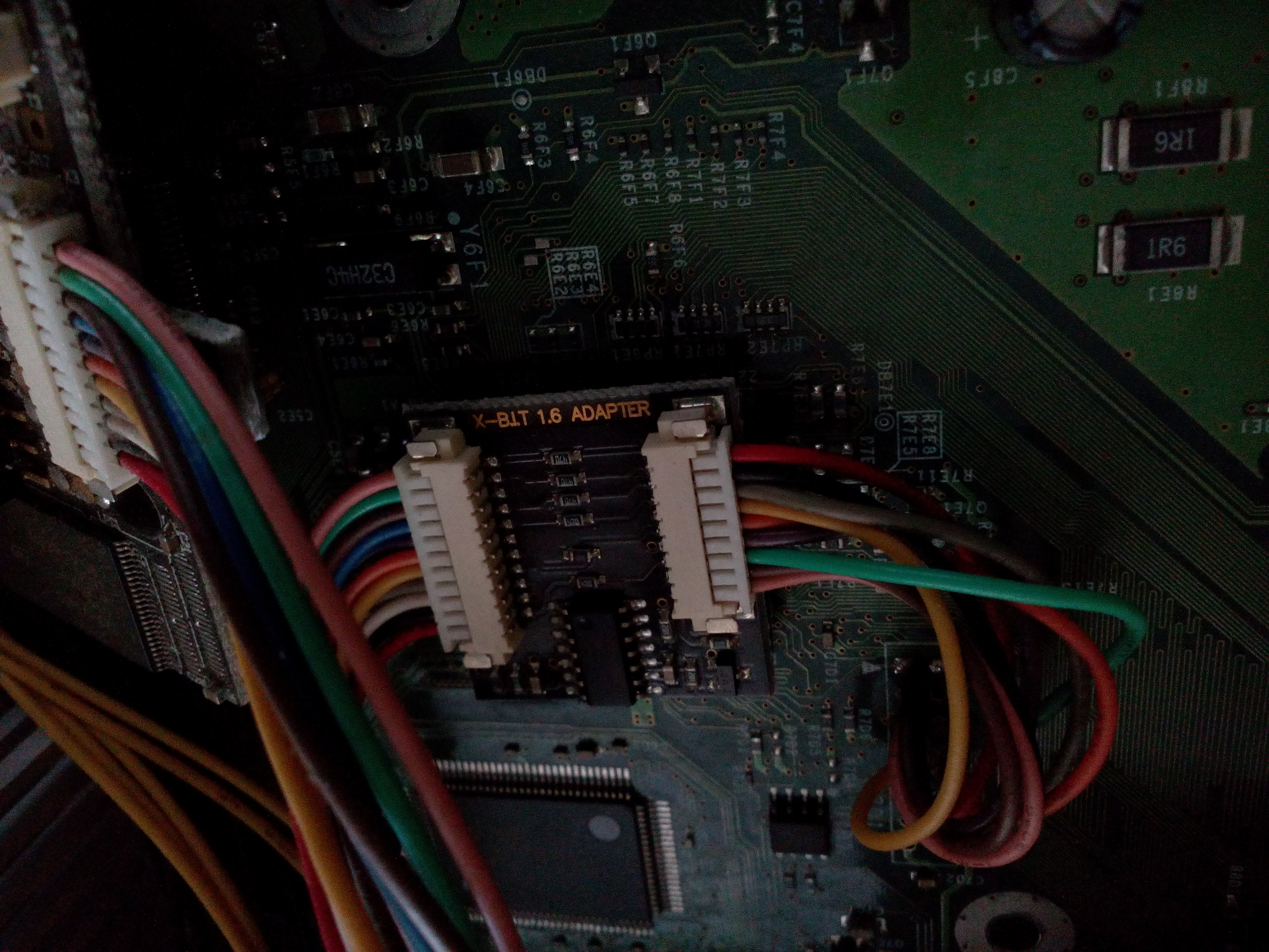

That's cable patches into 5Vdc and GND to power the modchip to install the modchip in a v1.6 Xbox.
What version is this Crystal Xbox?
I don't think the X-BIT 1.5's DVD/power cable is needed for non-v1.6 consoles.
Edited by KaosEngineer
The X-BIT's DVD/power cable is used on a v1.6 Xbox because the 5Vdc power at the LPC debug port of it is always.  Install in a v.16 required pogo pin 6 of the modchip is to be removed.  However, the modchip needs to be powered so they provided that cable for an easy to connect power source.
