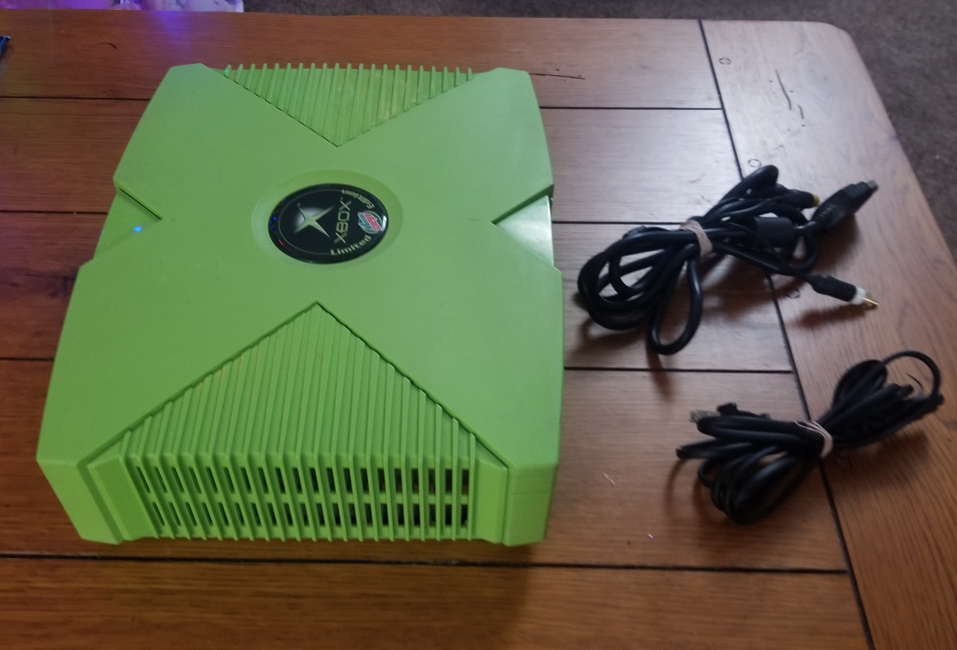

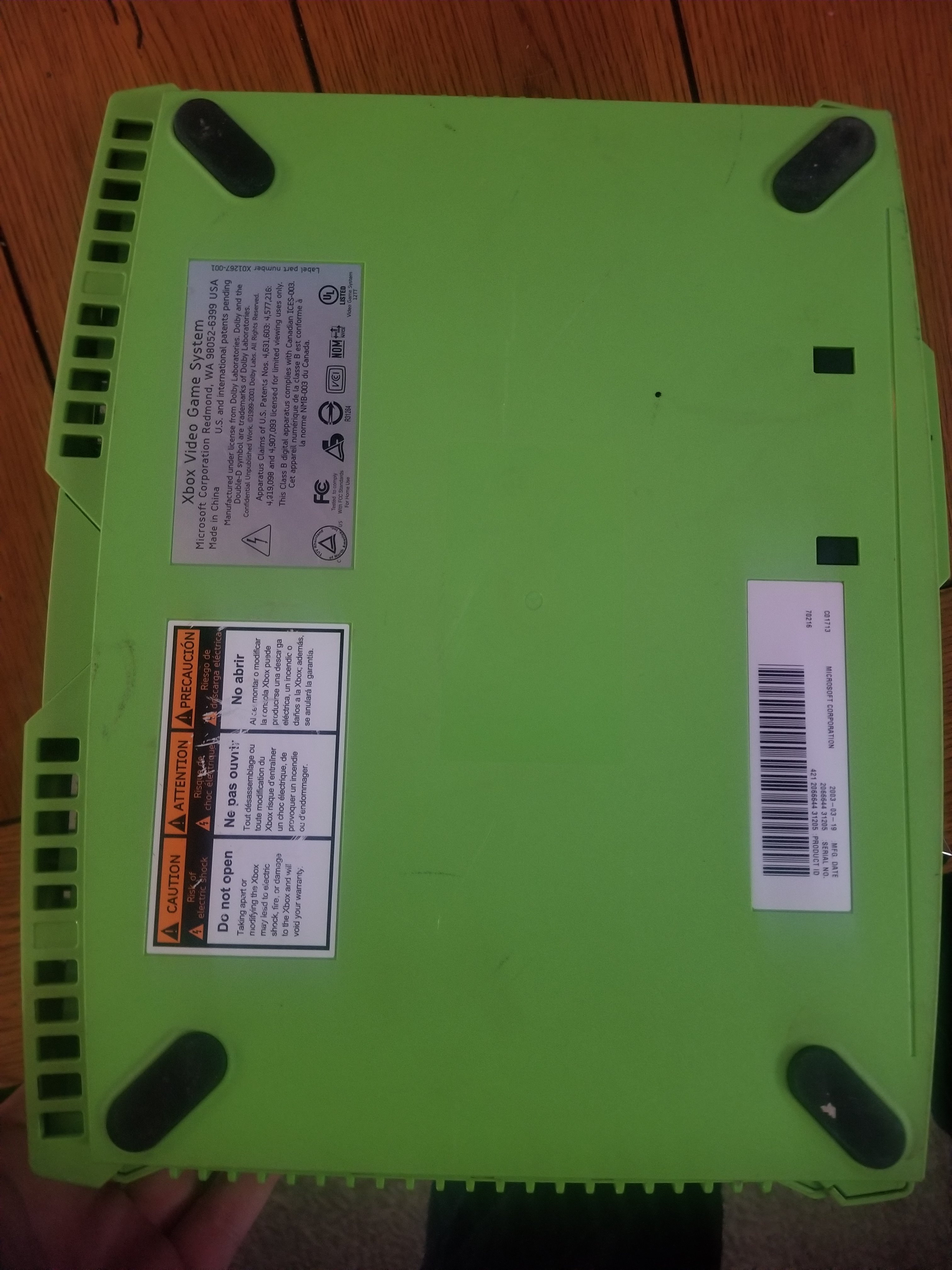

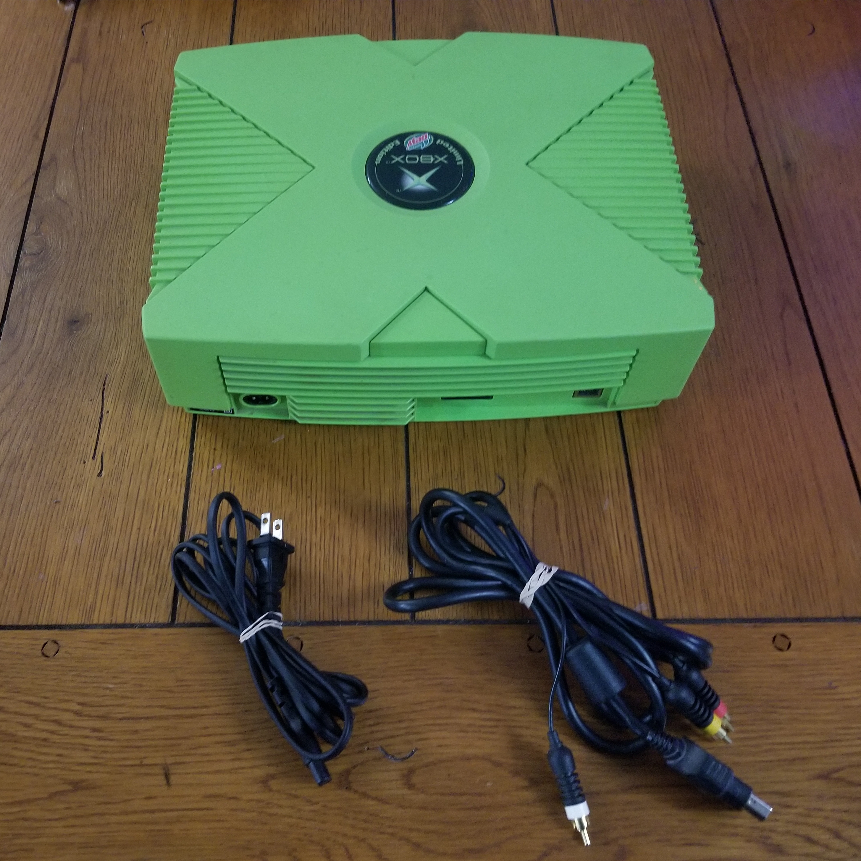

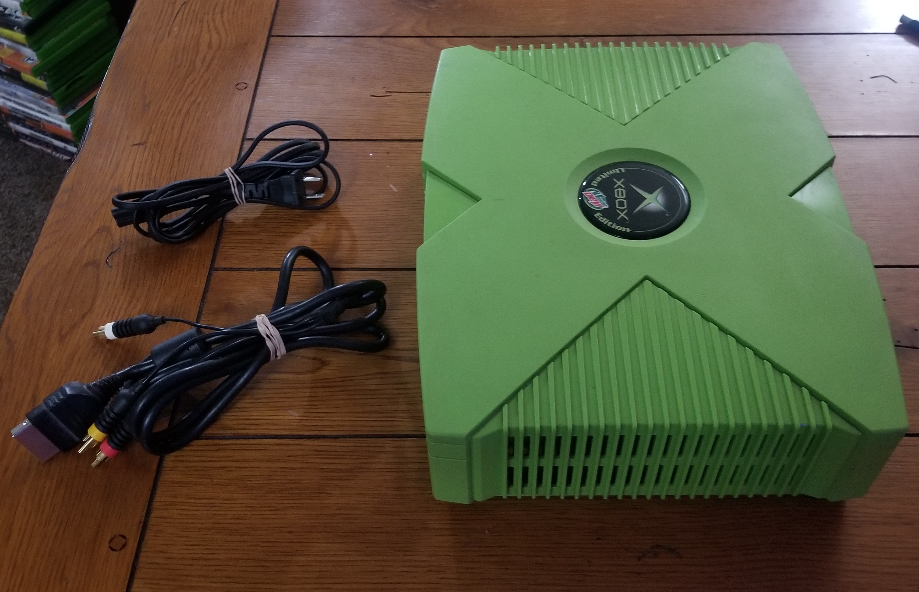

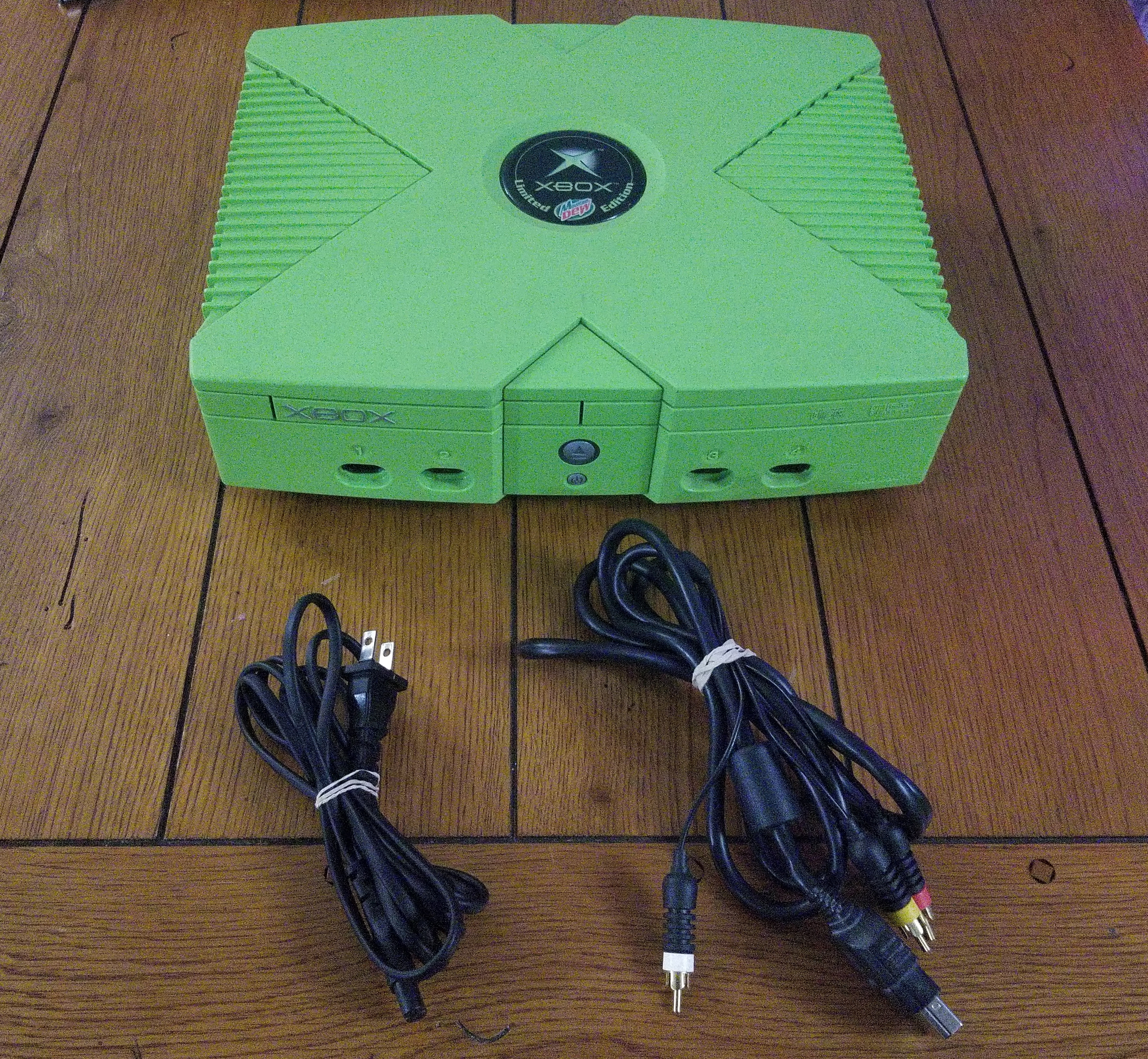

Limited Edition Mountain Dew Xbox
[1 of 5000]
Never been opened or modded. 100% unmolested. Stickers still intact. Overall in great condition. Includes 1 power cable and one A/V Cable. Located in New Hampshire 🇺🇸.
Asking: $229.99 + Shipping to the lower 48. Will ship to Canada and Europe just message me.
