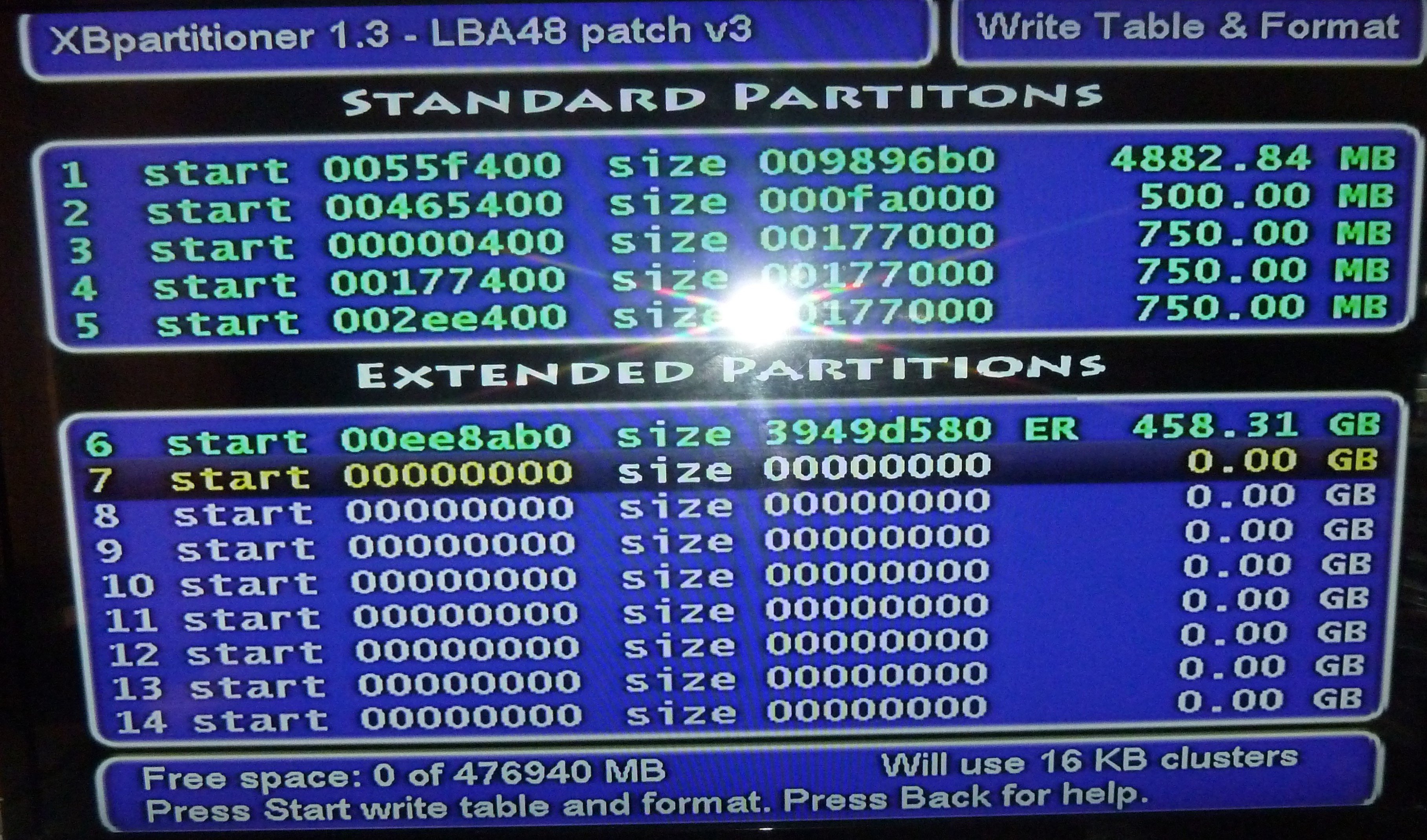

Lo2301 Posted August 4 Author Report Share Posted August 4 Hi KaosEngineer and thx for helping me ! Quote Where is XBMC installed on the hard drive? I see 2 folders in E/apps/ called XBMC and XBMC4XBOX. There are files in it. 23 hours ago, KaosEngineer said: Run XBPartitioner v1.3 After downloading (i just had the v1.0), installing and running xb partitioner 1.3, here is what I see : Indeed, i see the ER printed on the left of partition 6 size. Does it mean i would have to see 32kb clusters ? I have indeed a 512Gb drive inside the box. What can i do now ? Thank you very much for your help ! Quote Link to comment Share on other sites More sharing options...
KaosEngineer Posted August 4 Report Share Posted August 4 6 minutes ago, Lo2301 said: Hi KaosEngineer and thx for helping me ! I see 2 folders in E/apps/ called XBMC and XBMC4XBOX. There are files in it. After downloading (i just had the v1.0), installing and running xb partitioner 1.3, here is what I see : Indeed, i see the ER printed on the left of partition 6 size. Does it mean i would have to see 32kb clusters ? I have indeed a 512Gb drive inside the box. What can i do now ? Thank you very much for your help ! When the hard drive was formatted, the application that did so used the wrong cluster size - 16KB instead of 32KBs. Many of the older apps and tools that format larger partitions all did so. XBPartitioner v1.3 knows that for partitions larger than 256GBs up to 512GBs the cluster size must be 32KBs and for partitions just over 512GBs to 1TB the cluster size must be set to 64KBs. All was good until you finally wrote more than 256GBs of data to the F drive/partition 6. Once that happened, bad things occurred. Data started overwriting content already present at the start of the partition. There's no way to tell what files are still good. The partition must be reformatted with the correct cluster size and all data will need to be restored from a backup. Quote Link to comment Share on other sites More sharing options...

KaosEngineer Posted August 4 Report Share Posted August 4 4 hours ago, Lo2301 said: Hi again KaosEngineer, Which way do you recommend to do that (reformatting) ? I mean : which software, which options ? With XBpartitioner 1.3 ? and after i restart the box and re-install ? Thank you very much, Lo You will use XBPartitioner v1.3 on the Xbox. Make the partition 1GB smaller by pressing the D-pad right. Then press Start to format the modified partition 6. Follow any other onscreen instructions to complete the operation. The other unchanged partitions will not be affected. Reboot the Xbox then run XBPartitioner v1.3 again. Increase the size of partition 6 by 1GB - press the D-pad left button then Start to format the modified partition. Reboot then run XBPartitioner v1.3 once more to make sure that the partition is the correct original size and that ER is no longer printed to the left of the size. When you select partition 6, the 32KB cluster size should be displayed in the lower status section of the app. Exit XBPartitioner v1.3 - press Back then any button other than Start. FTP the files from your backup to the properly formatted F drive. 1 Quote Link to comment Share on other sites More sharing options...

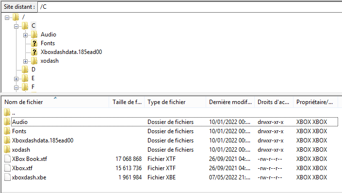

HDShadow Posted August 5 Report Share Posted August 5 Looking at the drive content C:\ looks normal for a softmod so nothing to worry about there. The F:\ drive formatting issue is a completely separate one from the dashboard problems described .....................unless the XBMC dash referred to was on F:\. The E:\ drive is a bit messy but it is impossible to tell where your primary dash is located: its probably in E:\Dashboard but what that E:\Multidash folder is doing I don't know. Never seen that and could mean some sort of custom set up may have been used. Its certainly not a Rocky5 or SID/AID softmod and it doesn't look like the HeXEn softmods I've seen but I'm no expert on HeXEn so I'd edge towards that as being the most likely original softmod. It still not clear to me what dash actually boots when you turn on the Xbox (using the Power button not the Eject/Close one) - UnleashX or XBMC and you've mentioned EvoX too. Again some pics of the "Dashboard" and "Multidash" folders' content might help as would a screen shot of the default dashboard or video of the Xbox booting. BTW it does look as if you used ConfigMagic for the locking/unlocking mentioned - those "EEPROM......." backup files spewed onto the E:\ drive like that are typical of ConfigMagic. Quote Link to comment Share on other sites More sharing options...
Lo2301 Posted August 6 Author Report Share Posted August 6 On 8/4/2022 at 11:17 PM, KaosEngineer said: You will use XBPartitioner v1.3 on the Xbox. Make the partition 1GB smaller by pressing the D-pad right. Then press Start to format the modified partition 6. Follow any other onscreen instructions to complete the operation. The other unchanged partitions will not be affected. Reboot the Xbox then run XBPartitioner v1.3 again. Increase the size of partition 6 by 1GB - press the D-pad left button then Start to format the modified partition. Reboot then run XBPartitioner v1.3 once more to make sure that the partition is the correct original size and that ER is no longer printed to the left of the size. When you select partition 6, the 32KB cluster size should be displayed in the lower status section of the app. Exit XBPartitioner v1.3 - press Back then any button other than Start. This is done. Thank you very much. It works ! On 8/4/2022 at 11:17 PM, KaosEngineer said: FTP the files from your backup to the properly formatted F drive. Unfortunately I have no backup of the F drive, I have then to reinstall. On 8/5/2022 at 4:52 AM, HDShadow said: The F:\ drive formatting issue is a completely separate one from the dashboard problems described .....................unless the XBMC dash referred to was on F:\. I agree. On 8/5/2022 at 4:52 AM, HDShadow said: The E:\ drive is a bit messy but it is impossible to tell where your primary dash is located: its probably in E:\Dashboard but what that E:\Multidash folder is doing I don't know. Never seen that and could mean some sort of custom set up may have been used. Its certainly not a Rocky5 or SID/AID softmod and it doesn't look like the HeXEn softmods I've seen but I'm no expert on HeXEn so I'd edge towards that as being the most likely original softmod. Yes i know, it's a complete mess. I used The CD Xcalibur 3.4, which is a french mod. I recently downloaded Hexen 2021 but haven't used it yet. I don't know if it's compatible. On 8/5/2022 at 4:52 AM, HDShadow said: It still not clear to me what dash actually boots when you turn on the Xbox (using the Power button not the Eject/Close one) - UnleashX or XBMC and you've mentioned EvoX too. The booting dash was Xbmc with evoX as alternate but I've just launched yesterday a longer process of installation of Xcalibur and it's now unleashX as main dash and still evolutionX as alternate one. This process is still not complete enough apparently because I still don't have Xbmc as main dash and working properly, which is my goal. It's not easy to find my through all the menus of Xcalibur 3.4. and I don't want to make a fatal change that would force me to re-start all the process of hacking. On 8/5/2022 at 4:52 AM, HDShadow said: Again some pics of the "Dashboard" and "Multidash" folders' content might help as would a screen shot of the default dashboard or video of the Xbox booting. I'm wondering now if i can try to use Hexen to manage that multidash process ... thx for your help Lo Quote Link to comment Share on other sites More sharing options...

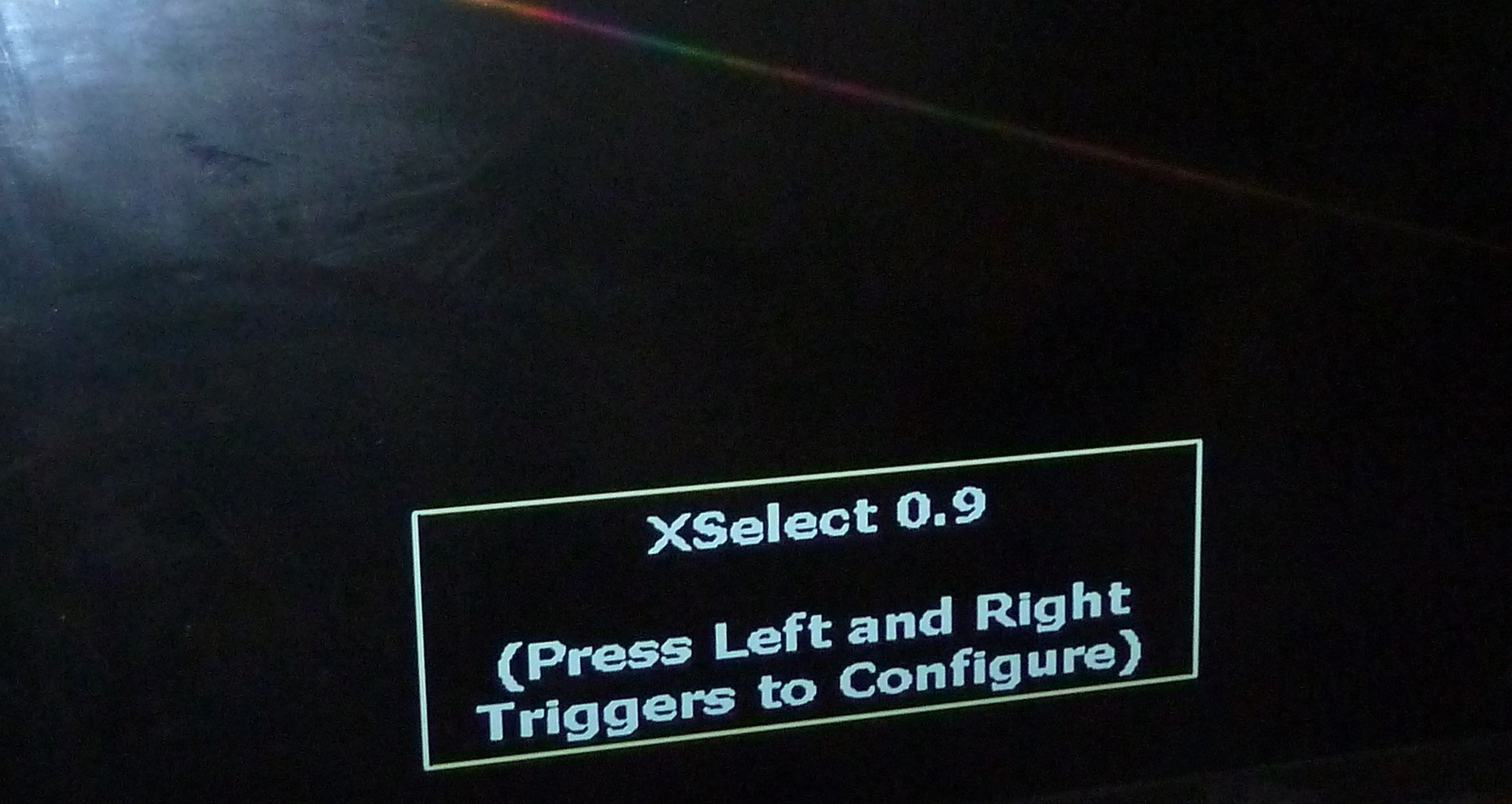

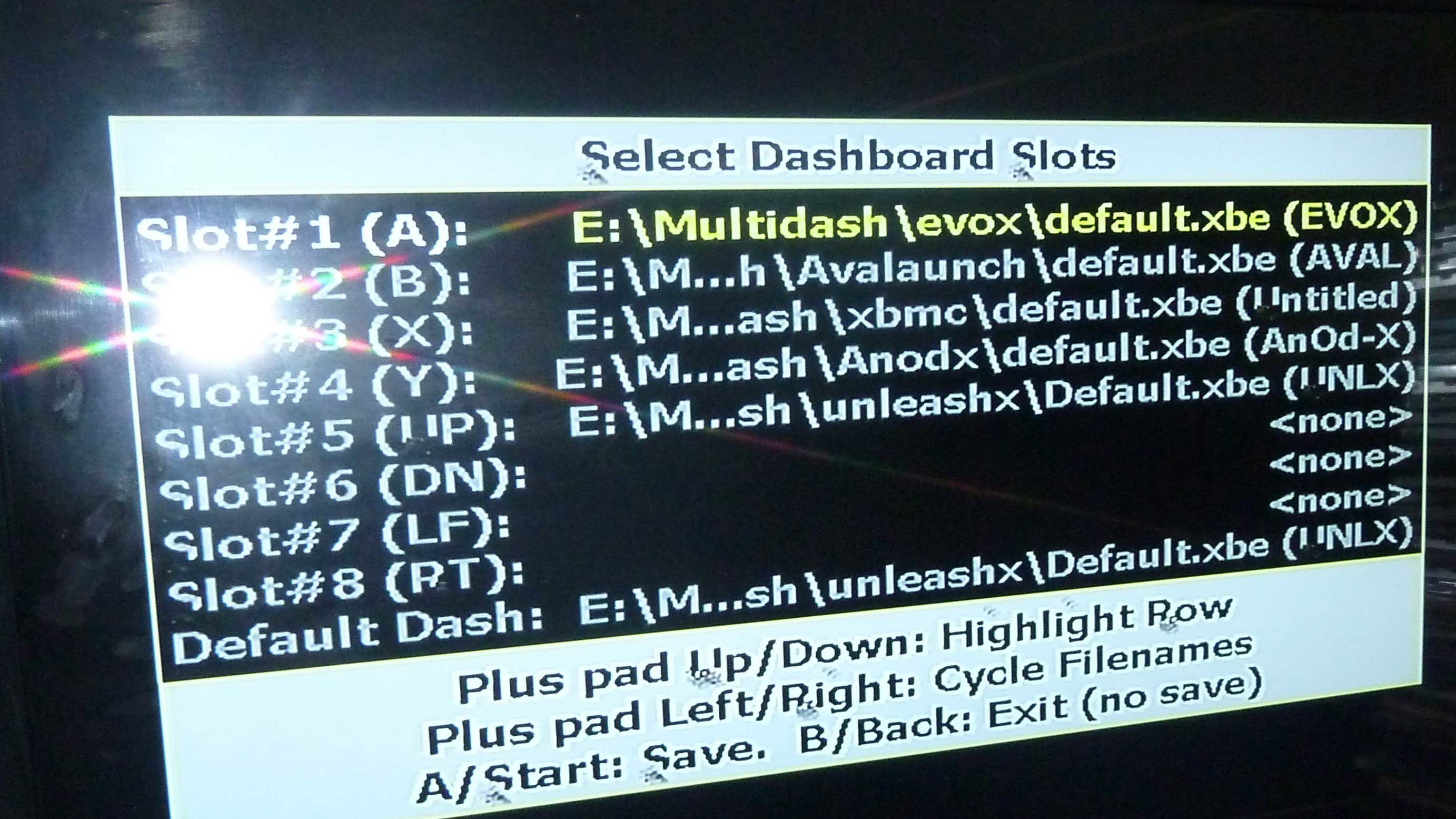

HDShadow Posted August 6 Report Share Posted August 6 It looks to me as if this XCalibur softmod is using dual boot to give the user a dashboard selection option. How is the 'alt' dash enabled? My guess is by using the Eject/Close button rather than the Power button which is how SID/AID sets up dual boot but limits it to the MS or Installer dash as options. Here its more interesting, it looks as if you can choose, at set up, which dash from the Multidash folder is launched as the 'alt' dash. It seems over complicated the way it has been done though: there's that Multidash folder with a default.xbe but there's also an "altdash" folder inside the E:\dashboard folder. So where the actual 'alt' dash being used is located and how it is being launched, as KE said, needs to be understood before making any changes to replace either main or 'alt' dash. You do appear to have XBMC in the Multidash folder. Again it would help if we could see what's in E:\altdash and, just to confirm its not some elaborate shortcut set up, see what's in the E:\Multidash\XBMC too. Quote Link to comment Share on other sites More sharing options...

HDShadow Posted Sunday at 02:35 AM Report Share Posted Sunday at 02:35 AM I was going to post that it could be using XSelect but apart from what it is for and what it does I have no practical experience with it. AID (Auto Installer Deluxe) has a XSelect install option "Install XSelect + UnleashX Dashboard" which is probably very similar but I've never used it as I'm happy enough launching alternate dashboards or using the UnleashX controller/remote shortcuts feature instead. As I thought might be the case XBMC is/was being launched by a shortcut in the Multidash folder rather than a full copy of XBMC located there. If you do not have a working copy of XBMC in Apps ie. E:\Apps\XBMC\default.xbe it is not going to launch when you use the XSelect menu Slot#3 (X) button option. It looks like to me as if you should be selecting the QuickPick Dash menu option to be launching the other alternate dashboards. The E:\dashboard\altdash folder content looks like that is indeed where your alt dash: EvoX is located. That's the full dash, not a shortcut. From the previous E:\ drive content pics that would suggest the E:\Dashboard folder contains your current primary dash UnleashX launched from the "default.xbe" there alongside the "skins" folder and config.xml, item.xml and french.xml. If you really want XBMC back as your primary dash the important thing to do first is to make sure you have working copy of that, and preferably the last version XBMC v3.5.3, in E:\Apps. You can launch that using UnleashX's file manager by clicking on its "default.xbe" in the E:\Apps\XBMC folder. If it is not working then you need to get a fresh copy. Quote Link to comment Share on other sites More sharing options...

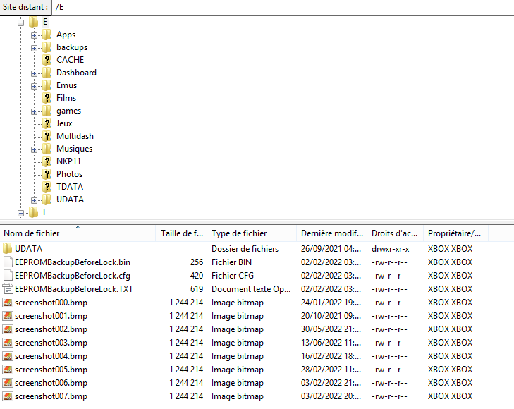

Lo2301 Posted Sunday at 10:31 AM Author Report Share Posted Sunday at 10:31 AM 7 hours ago, HDShadow said: As I thought might be the case XBMC is/was being launched by a shortcut in the Multidash folder rather than a full copy of XBMC located there. If you do not have a working copy of XBMC in Apps ie. E:\Apps\XBMC\default.xbe it is not going to launch when you use the XSelect menu Slot#3 (X) button option. Actually I don't know when to use the X button (for instance). I tried to press on the buttons mentioned (except the X one since my xbmc is not working) when starting up with the power button or the eject button and it doesn't do anything. 7 hours ago, HDShadow said: It looks like to me as if you should be selecting the QuickPick Dash menu option to be launching the other alternate dashboards. I did. It's actually a shortcut to launch the various dashes from the same place without having to search for the executable, i think. And it works (except for xbmc of course). 7 hours ago, HDShadow said: The E:\dashboard\altdash folder content looks like that is indeed where your alt dash: EvoX is located. That's the full dash, not a shortcut. From the previous E:\ drive content pics that would suggest the E:\Dashboard folder contains your current primary dash UnleashX launched from the "default.xbe" there alongside the "skins" folder and config.xml, item.xml and french.xml. Yes, I agree. 7 hours ago, HDShadow said: If you really want XBMC back as your primary dash the important thing to do first is to make sure you have working copy of that, and preferably the last version XBMC v3.5.3, in E:\Apps. You can launch that using UnleashX's file manager by clicking on its "default.xbe" in the E:\Apps\XBMC folder. If it is not working then you need to get a fresh copy. I got a fresh copy yesterday, remove old versions that I had and put the new one (v 3.5.3) in E:/apps/xbmc/. It still get stuck at startup. The only thing that changes is the logo. Also the xbmc.log shows no error (only NOTICE events), which was not the case for the older versions. Quote Link to comment Share on other sites More sharing options...

KaosEngineer Posted Sunday at 07:10 PM Report Share Posted Sunday at 07:10 PM On 8/4/2022 at 2:00 PM, Lo2301 said: I don't remember exactly. I unlocked the hdd from the xbox, maybe with configmagic. And I relocked it from a pc (maybe with xbox_hdm but i 'm not sure). It seems to change, from time to time. At a time, both xbmc versions available from the apps folder in evolution-x stuck at launch and so did the default dash when starting the xbox. Now, xbmc launches when starting as a default dash and get stuck a little bit further... I did it (see my previous posts) and it seems to be one of the problems. Now i'm wondering which tool to use to reformat the partitions correctly (and then re-install lost files and possibly xbmc). thank you for your help Lo What files are in /E/NKP11? Do you have an /E/UDATA/21585554 folder? What files are in it and any subfolders it contains? Quote Link to comment Share on other sites More sharing options...

Lo2301 Posted Monday at 03:08 PM Author Report Share Posted Monday at 03:08 PM Hi Kaos, Here are the answers. thx ! 19 hours ago, KaosEngineer said: What files are in /E/NKP11? 19 hours ago, KaosEngineer said: Do you have an /E/UDATA/21585554 folder? What files are in it and any subfolders it contains? Content of uxshadow.xml : https://pastebin.com/9f8WS9sK4 19 hours ago, KaosEngineer said: When UnleashX is running press the (Y) button to display the System Info screen. Scroll down to the UnleashX section. What are the Version, Path and Phy. Location values? Version: 0,39,0222A Build 572 Path:E:\dashboard\ Phy. Location: \Device\Harddisk0\Partition1\dashboard\default.xbe Quote Link to comment Share on other sites More sharing options...
