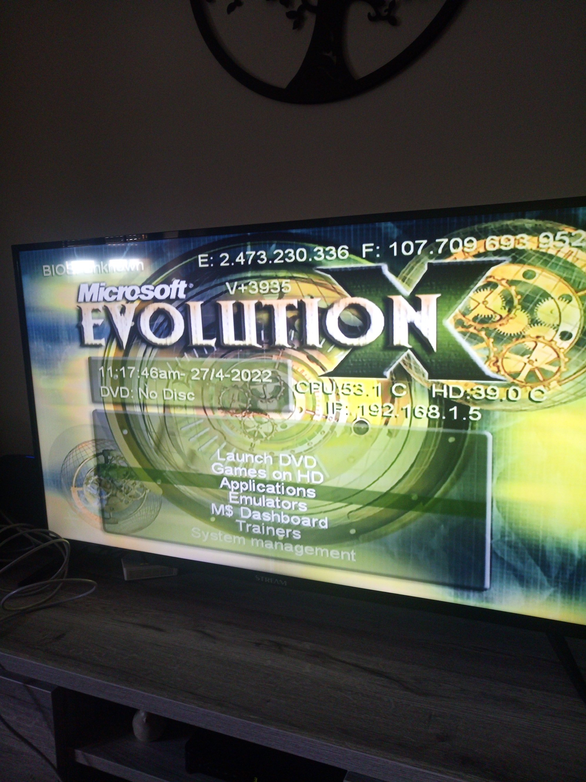

Tiago Posted April 27 Report Share Posted April 27 (edited) Hello everyone I got a Softmodded V1.0 Evox with a 500hd, i´ve about 200 titles that work, but recently i´ve installed some via Flashfxp5 but they didn´t launch from the dash menu, it shows loading but it goes back to Evox menu, and doesn´t start from a game disc(does the same thing). The orange light is always on on the tray button. What i tried already: Cleaning cache from E: and X: Y: and Z: (nothing) Patched xbe of some games via c-box tool (nothing) Still, nothing, games won´t start anyway, what i´m missing here? Thank you very much Edited April 27 by Tiago Quote Link to comment Share on other sites More sharing options...

MadMartigan Posted April 28 Report Share Posted April 28 (edited) Looking at the original picture, I only see an F: partition. I would recommend checking for errors within the xpartitioner app as you’ve probably maxed out your space on the F: and need to allocate the extra space of the 500GB to a new G: partition. All of this can be done from the Xbox. Have a look at the very similar thread titled “EvolutionX file problems” Edit: Forgot to mention, this will delete everything from the F: partition so be sure to make a backup of any important files. Games can be transferred back again. Edited April 28 by MadMartigan 1 Quote Link to comment Share on other sites More sharing options...
