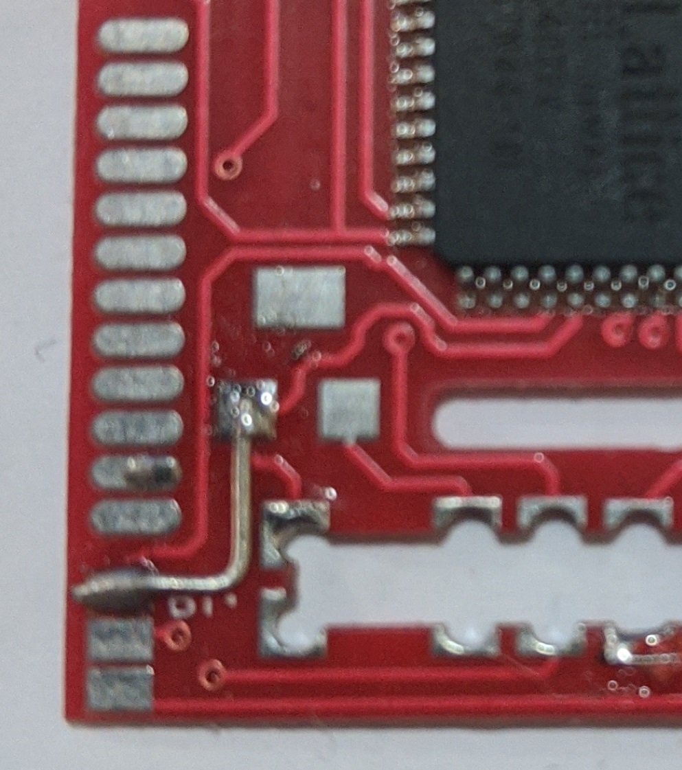

Fitting an Aladdin XT Plus 2 ( Chinese Brand )
KpCollins
Don't worry about the 1.5 links
Link the BT on the mod chip to ground (Pin 2) and also like the D0 to ground, Doing this will make the chip always active.
Like this.
I highly recommend you use the alternative D0 point on the bottom of the board as it's easier to solder to.
A ground point is the screw hole or pin 2.
Thanks Dave, Can always count on you!
Its just as I presumed, i installed the jafar chip the exact same way on my Crystal 1.4
You've confirmed it for me and I am now confident i'll get it sorted when it arrives.
Deffo will be using the D0 under the Board, thats what I did on mine :)
