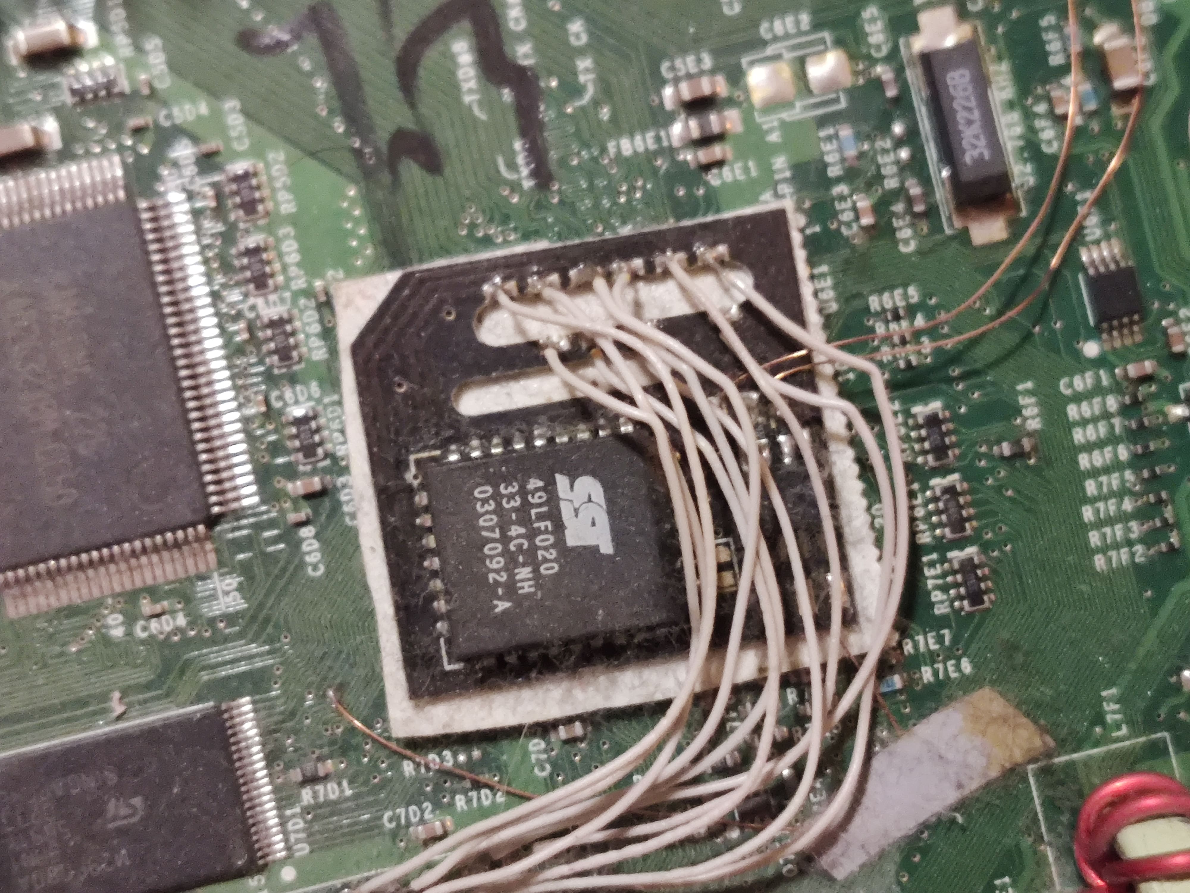

Hello Together,
I bought an xbox today and planned to do a softmod.
When opening the console to remove the clock capacitor, I noticed that a modchip is already installed.
Unfortunately, I can't find any information about this chip.
Can you help me further?
Can I just ignore the chip or should I pay attention to something?
Is it possible to simply install a SoftMod !
Thank you for your help !
Thanks for the quick reply!
The Xbox boots into the original dashboard and there are no logos or other signs of a modification. Is this normal for this type of mod, or do I need to pay attention to something?
And one last question:
What exactly does this modificaton. What functions does this chip offer?
Thanks for your help!

Hold the power button down for several seconds and see if it behaves differently.
The chip itself doesn't do anything other than allow a custom bios to boot. This is what circumvents all the protections and allows you to play homebrew and emulators.
Your advice worked, thank you! When I hold down the power button, the Xbox boots into XBMC.
What is the best way to bring the Xbox up to date from here? (I have already successfully removed the clock capacitor. )
Is it necessary to update the software / bios? According to XBMC the BIOS: Xecuter 2 4977 is installed.
I have already downloaded the OGXBox Installer 2021 disc, but I am unsure how best to proceed.
Thank you for your help!

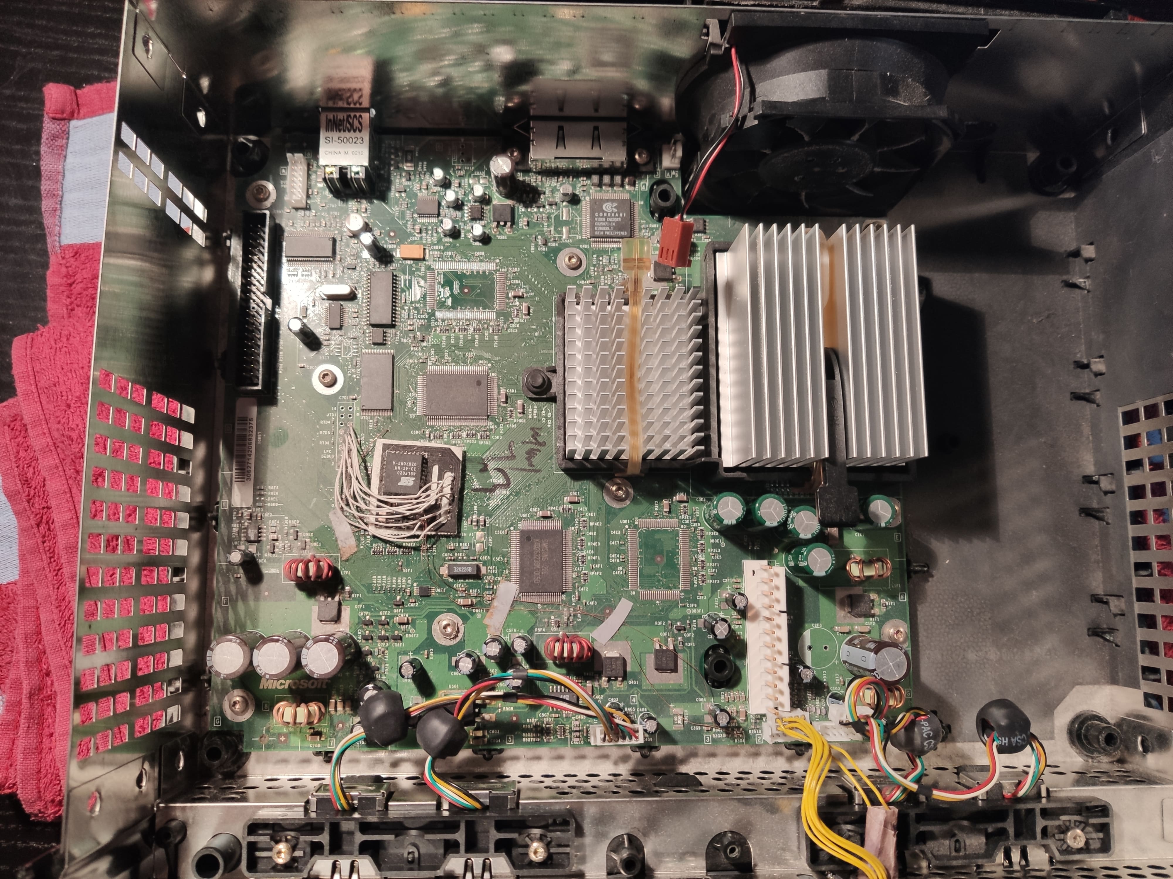

      Hi guys,
       So I was given an Xbox 1.0 from a friend that is chipped and has a 120gb HDD. Unfotunately the chip does not have support for HDD larger than 120gb and I am unable to flash the chip's BIOS (evox says it is not flash writeable).
       I'm basically in a bind to find a guide on how to softmod this box and tsop it from a modchip because I don't know what type of chip it is and how to disable it. Pictures below:
      Apologies for the very dusty MB, lol! As always any guidance will be highly appreciated.
