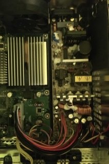

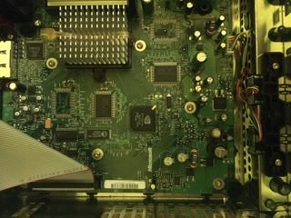

      Started my Xbox for the firat time in ages. i heard bubblig noise and a strong small hit me. So i pulled out the power cord and opend the Xbox. Could only find some liqud that Smelled stron on the harddrive pleas help.
