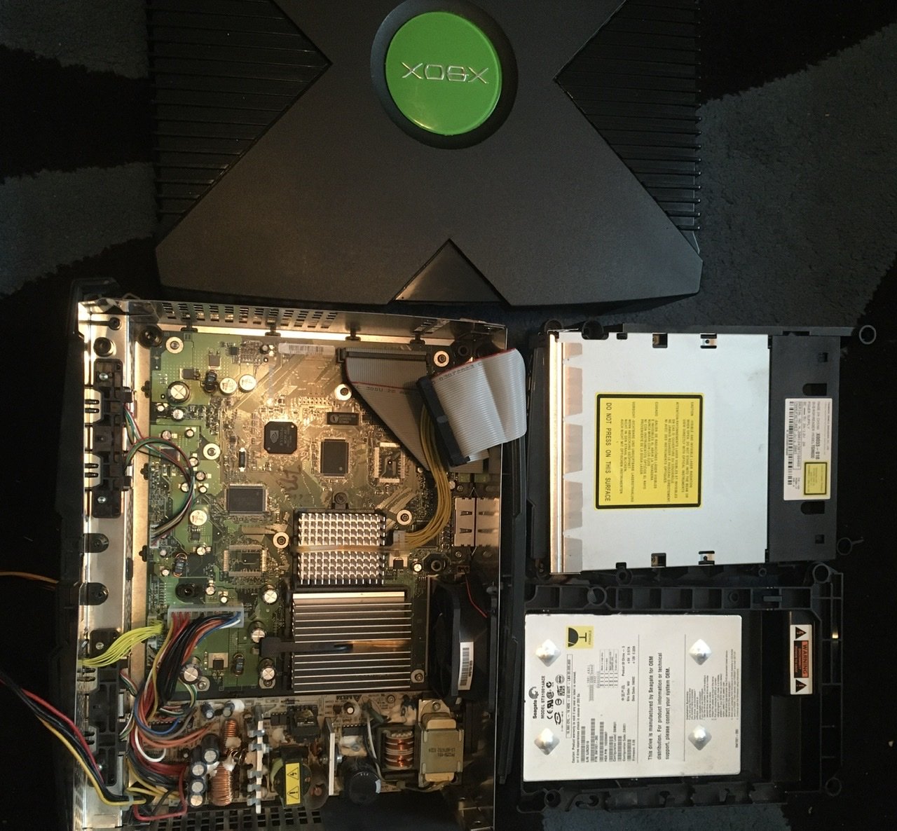

I just received an Xbox I bought from eBay really cheap which I was planning to use as spares.
ive just cracked it open, and wow. So clean. Hardly any dust, no pitting of steel, Capacitor leaks (I’ll still remove clock anyways).
i May even switch my main drive etc over to this one and softmod it
Is this a 1.2? Date on sticker says 2003-08-15.
Shame it’s a Thompson drive, but it still works.

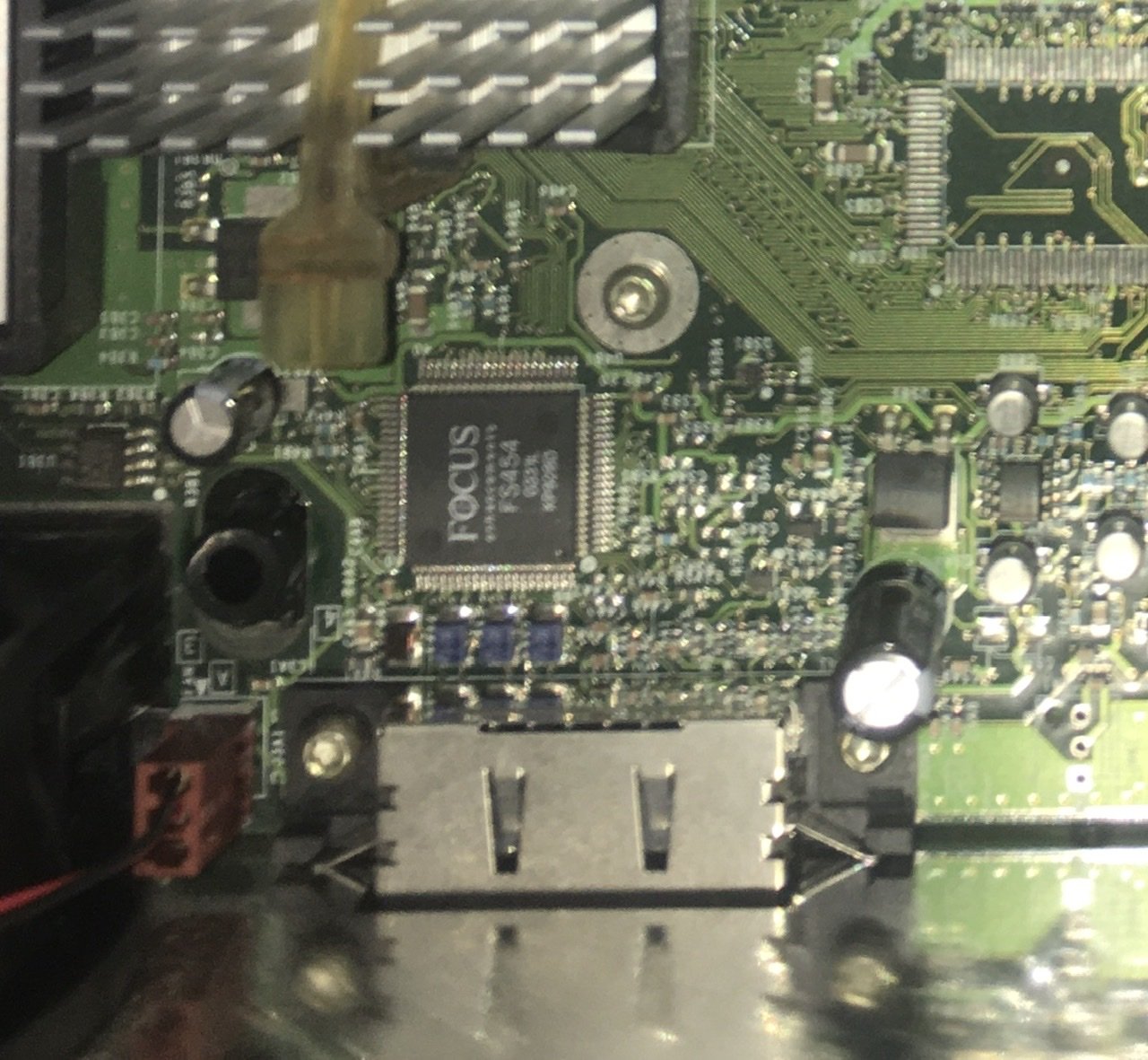

If this chip has Focus printed on it then it's a version 1.4
D72F228A-71BD-4F49-97B1-EFB7F5760013.thumb.jpeg.3b90dcdf119251ee7d08c8deff3b87a7.jpeg.9a459bcc429688cf5ff3dcc4b667206e.jpeg
The version 1.2 -1.4 of Xbox is slightly easier to TSOP flash as the 2 solder links are located  on the to side of the PCB circled in yellow.
1109807626_68532091_IMG_20200612_1846051(Copia).thumb.jpg.271546802245932f2fc85ccd03cd5743(1).jpg.1acbbd4bd49978331740bf662a8c19eb.jpg
With the version 1.2 -1.4 board I would use the IND 5004.67.bin BIOS as it's a 256kb TSOP chip and the BIOS is one that will support  a 2tb hard drive.
