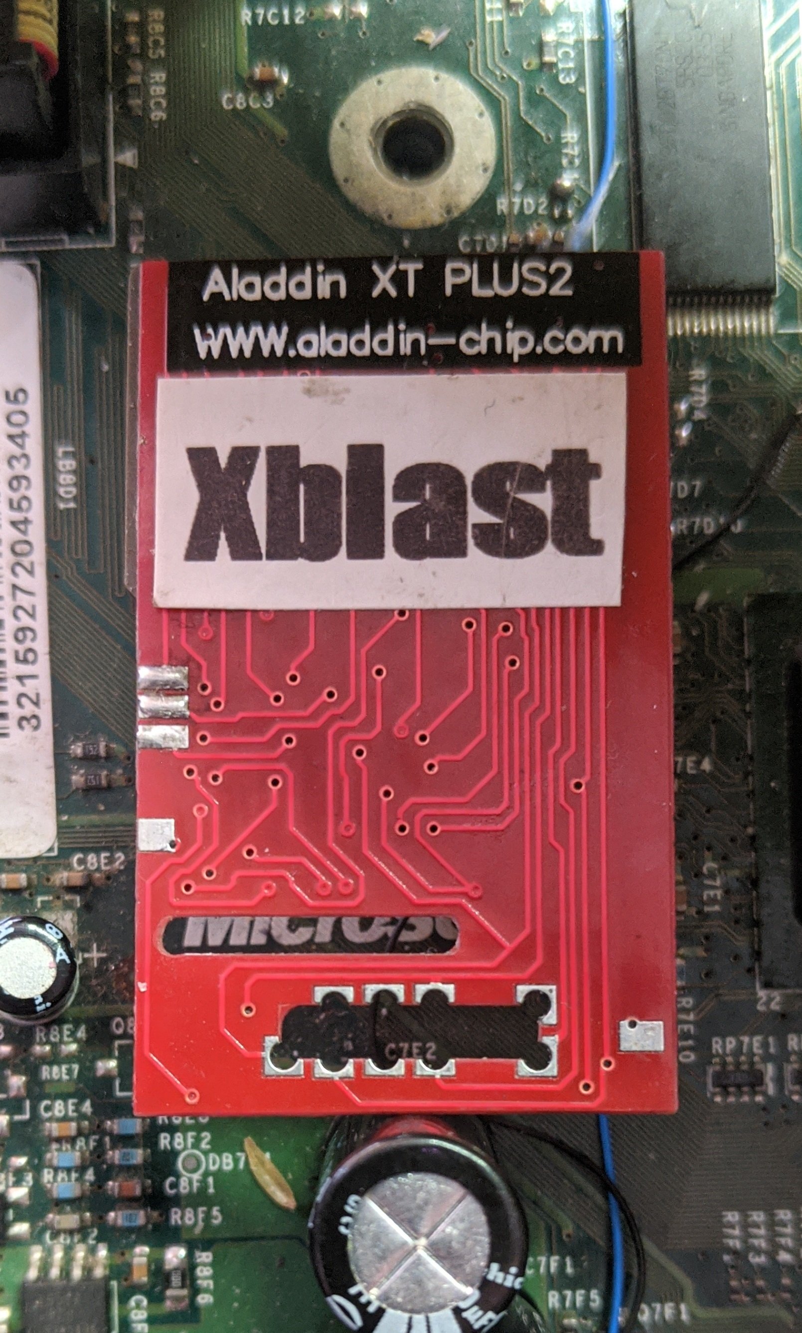

i did my 1st hard mod on a xbox today. i used an alladin modchip on a v1.4. the modchip wouldn't even go on because a cap was in the way so i heated the solder on the cap and leaned it back until it was hitting the cap behind it. now the modchip will go on but it is rubbing against the cap. i think it will eventually cause a problem. how can i fix this issue?
So like this and no it won't cause any problems.
