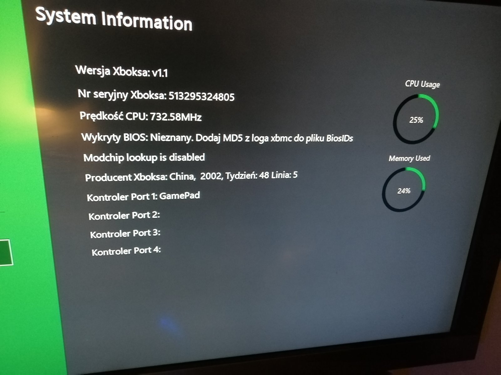

    • By Pasimys
      Hello,
      i change my hdd drive to bigger 1tb drive and after succesful cloning i tried to format the new drive with XBpartitioner 1.3 and it complained about "LBA48 info not found! etc..(pic bellow) i tried to flash new bios with hexen 2018 but then that complained about "flash not writeable". i wonderd that do i need to get somewhere the newest bios and put it directly to my modchip via usb cable. our am i missing some step in this setup?
