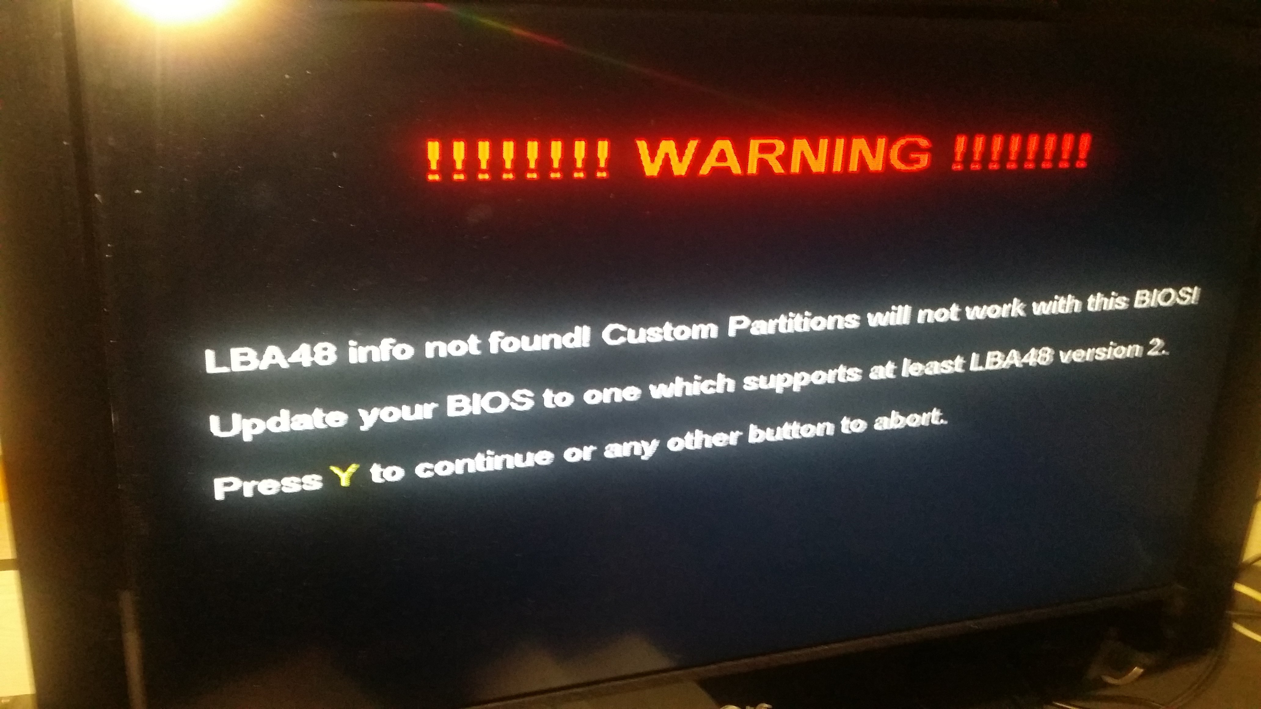

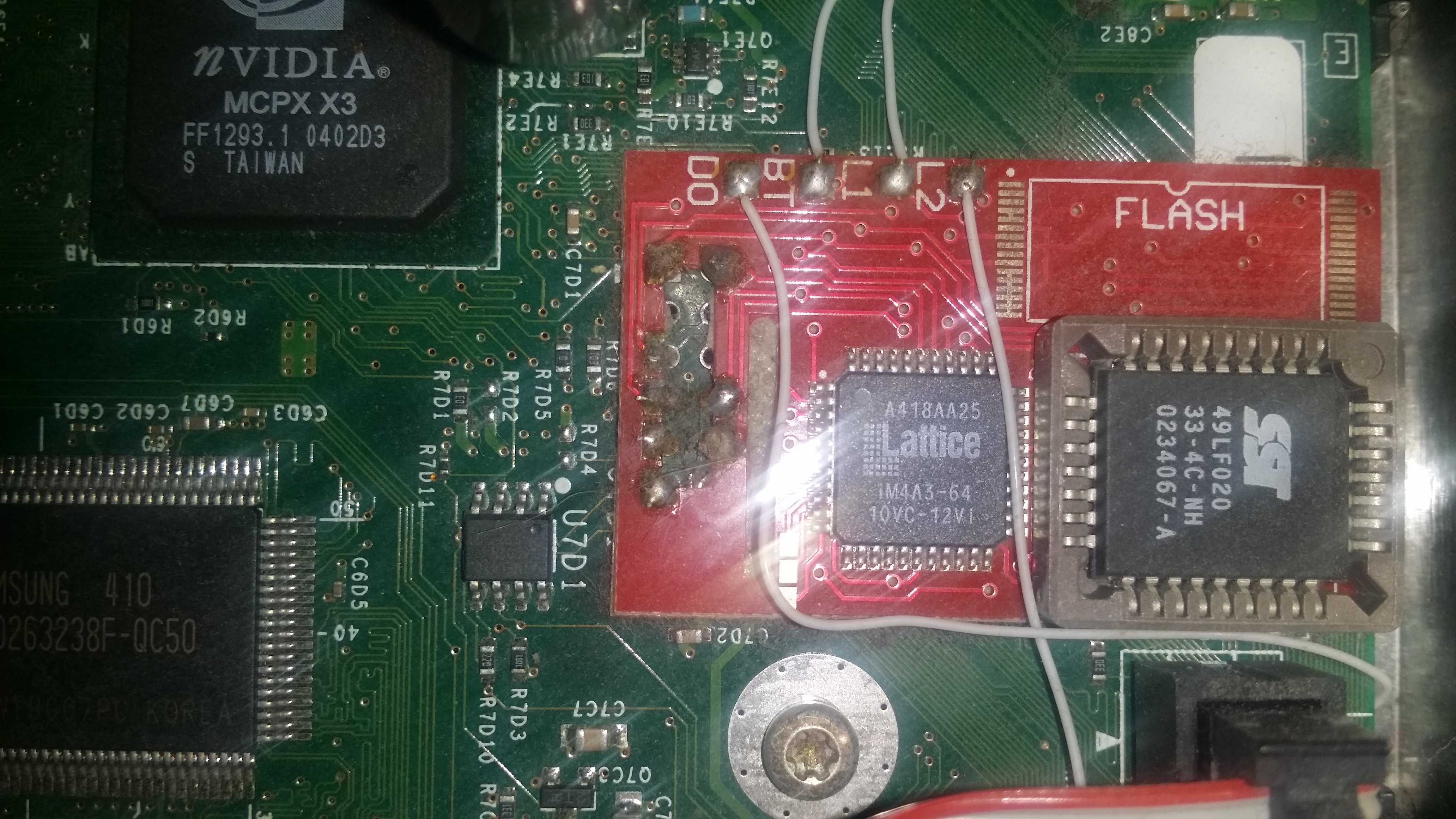

I`ve X 1.6 Hardmoded with Aladdin Advance 64 BIOS checker say:  evox.m8pus.bin
stock>1tb(sata)
I try HEXEN method but after swapping HDD HEXEN block in "xbox linux" boot screen (red LED)
I don`t know adapter non compatible or BIOS (hexen disc work)
XBpartitioner 1,1 show this error:(photo)
What to do?
PS.: Sorry for my English it is not my prime lag
I think you need to update the BIOS to one that  has LBA48 support.
There should be one on the Hexen disk just make sure that the one you pick is for a VERSION 1.6 Xbox and 256kb.
Evox M8 plus 1.6 F and G or Evox M8 plus 1.5 F only
F only is F drive only ver F and G  is F drive is 137gb and G gets the rest of the space
Have you reflashed the bios on your chip at all? I would put the stock hdd back in and see if it boots from that and then use hexen to reflash a different bios to the Aladdin. You may not have a v1.6 bios flashed. After reflashing the chip swap the drives again and see how you get on :)
Edited by nikeymikey
Boot your box with a hexen disc in the drive, when it boots up choose the flash tsop/modchip option.  When it boots into the eco x flash menu. Choose flash 256k bios, after that choose a 1.6 bios with F and G support. When that has flashed to the chip you should be good to go.

After you have partition the disk it needs to be formatted.
 Partitioning divides your drive into sections, but you can choose to simply have one partition (a single section encompassing the entire drive)
Once your drive is partitioned, each partition will have to be formatted with a file system (X-FAT. Xbox File Allocation System).
Normal when you do a new install that happen with out you knowing it doing it.
Basic computing.
22 minutes ago, HappierParsley said:
YEY My OG Xbox now have 1TB disk! Thank you for support.
Topic ready to close :D
